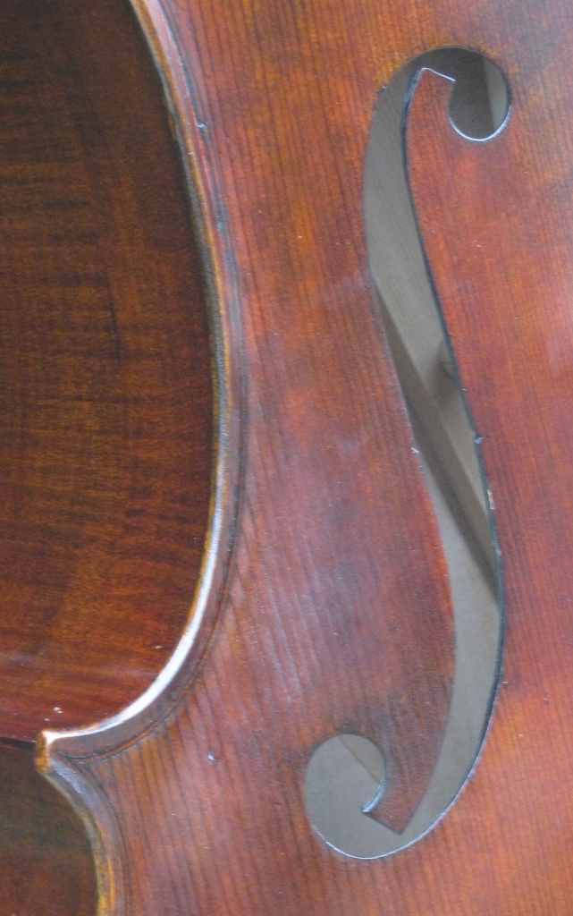

Do you have any pics of the back bracing by any chance ? I'm trying to visualize a single X back brace .....
Eric Swanson 08-24-2010 12:09 PM
I think that Ken is talking about half of an X. If that's true, you can see part of a similar brace through my f hole photo (for what its worth).
http://www.smithbassforums.com/attac...1&d=1282666138
