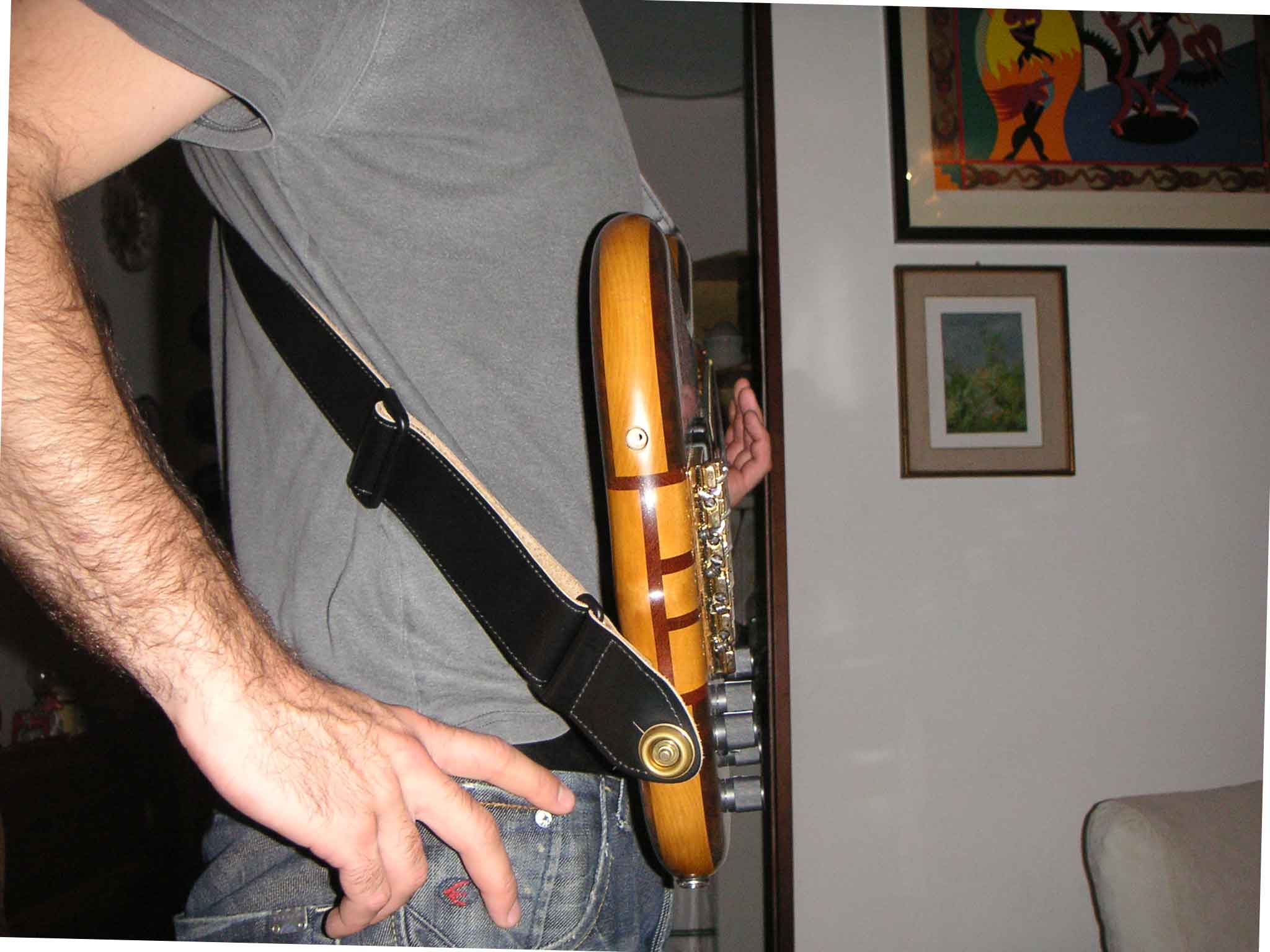

About comfort factor I did a small modification to my bass you may consider to introduce to Smith Basses, I think it's a very good thing:
When I first strapped on my bass I felt something was different as playing sit.
I realized that the strap lock is upside the center of the bass. that makes the position of the bass less comfortable because the bass can't be parallel to the body but watches a bit up. this is bad for left wrist.
so My luthier and I moved the straplock lower, exactly simmetrically respect to the old straplock. now the bass feels much better , I can play easier because of a better left hand position and doesn't hurts my ribs anymore.:)
I'll fill the old hole with another straplock piece.
I think this would be a very usefull upgrade on Smith Basses with almost no effort.
Hope this helps, I can post some picture if someone is interested.
Thank you, Roberto

It's a matter of angle, not a matter of Hight.
I'm not that idiot! :rolleyes:
I maybe didn't explain well.
what I need for a correct left wrist position is fingerbord surface parallel to my body,
like when you play sit. if the fingerbord is facing up when you strap it on it will be harder to play and can take to wrist healt problems
because you'll have to bend your left wrist much more to reach the lower strings
It really makes a lot of difference to me, that's why I'd like to know Ken's opinion about that
I hope I sayd that clear now. (i'm sorry for my bad english)

Maybe I'm picking this up wrong but I think that Roberto is describing the angle that the neck is positioned as a result of having a large stomach (politest way I can think of saying that), ie - your belly is tilting the bass body upwards.
In other words - when seated you should only be able to see the sidedots on the neck, but standing the dots on the front of the neck are now visible. And because the neck has moved forward and up like this, the wrist has to have a sharper bend and further stretch to reach the lowest strings.
Geez, this is hard to describe, and English is the only language I speak!!

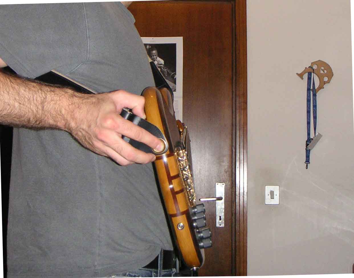

Thank you Gareth, that's the idea, (except for the large stomach, I'm slim, instead.
A little example test. Stomach or not if you wear your bass and stand up the bottom edge of your bass will not touch your body..
this won't happen with basses with the straplock in the center of the body like the Yamaha trb6 or I played for long time or almost every bass on the market.
(this is probably why I noticed that)
ok I did some picture to explain my point:
Look at the angle between the bass and the line of the wall behind:
Attachment 314
or the door here (notice Clifford Brown and the Double Bass bridge in the background..)
Attachment 313
I don't have a goniometer here but this is almost 15 degrees

Then here the more healty reduced wrist angle with the new strap position.
Attachment 317
I don't want to look assumptive with that but I've been very careful to posture problems this years after a bad wrist problem and I think this can really help someone.
than my beautiful smith feels so much better and easyer to play now..
Please don't think this is a criticism. I think the Smith is by far the best bass ever built and I just love it.
It was hard to decide to drill a new hole in my beloved bass, but the result looks very good and I'll fill the original hole with another identical Dunlop straplock..
Roberto, I think this is a great idea. I can totally see the benefit this would bring to those with the type of "wrist problem" you are talking about. Actually, I can see the benefit for anyone willing to give it a shot. I don't necessarily think Ken should change the current location of the strap-loc, however, an option made available to those that want it would be very nice! I would have no problem ordering a Smith with the strap-loc re-located to the lower position.
Great idea! ;)

Thank you Tim,
I'm glad you appreciate my little mod..
I was waiting for comments like
":eek:!!did you fu&%$ as$&@§% drill a HOLE in a Ken Smith!!?"
I think It would be nice if Ken would put both locks on their basses
so one can choose wich better fits his playing style.
