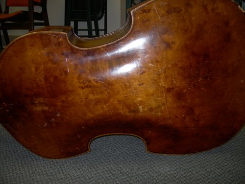

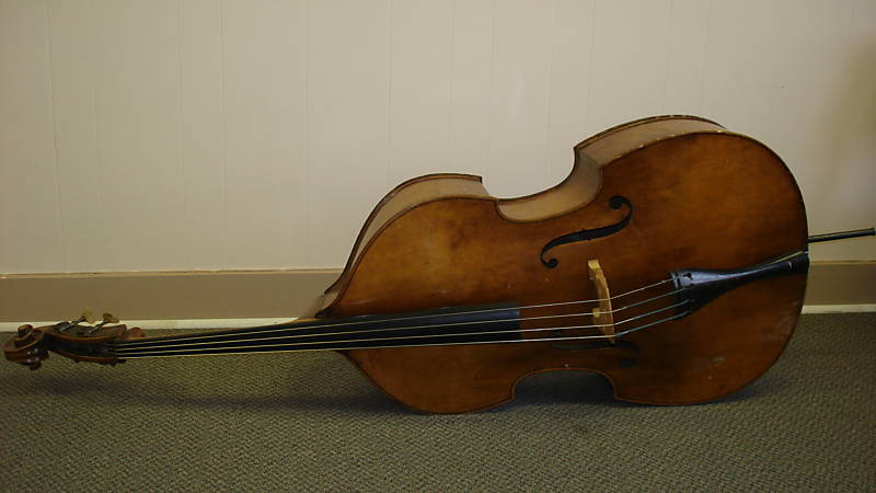

Hi there everyone;
I've been doing a lot of research on this forum and elsewhere about Juzeks because there is someone in my city selling a used Juzek half-sized bass and I'm trying to decide whether to buy it or not.
I was hoping you folks (Especially Ken Smith if he's around...) might be able to tell me a little more about this bass from the pictures (i.e., what possible year it might be, what its history might be, what one should expect to pay for it...)
I know the pictures aren't THAT great, but I did my best. Somehow over the years it ended up with a Hammond sticker on the inside that identifies it as a Juzek SB236 (alongside the normal Juzek sticker, I have a picture of it, but ran out of room to post pictures. If you need to see it, let me know!) but I don't know what this serial number might mean. S.tudent B.ass perhaps? I was able to identify it as obviously a laminate, but other than that I don't know much about it.
I went to play it today. It sounded decent, but not better than the bass I have now. But my problem is that with my level of experience I can't tell what a good luthier COULD do with the bass and whether it'd be a step up from the bass I have now which is a very nicely set up Engelhardt EC-1. My teacher is not really available to evaluate this bass for me so any thoughts you might have on its pedigree would be greatly appreciated.
Any general thought you might have on what a fair price for it would be (considering that it will have to be properly set up) would also be much appreciated.
(You should be able to see a slightly larger version of the photos if you click on them... I think...)
Thanks,
Genna.

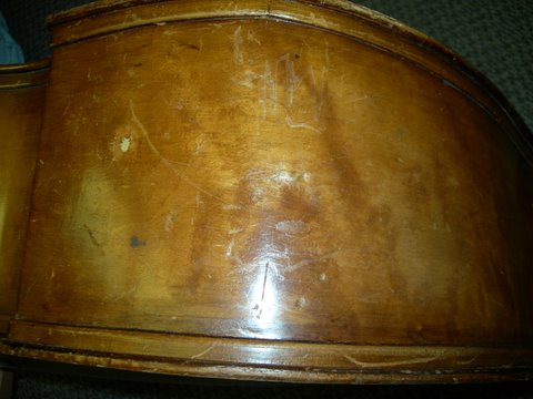

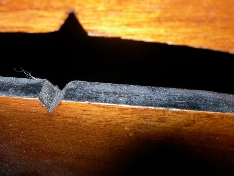

I read this over on TB yesterday and today. I can view there but I can't post or message. I read that you think it is a Laminated Bass. The pictures you posted are not clear or close-up enough to tell that. Even Laminates can have normal type graining on the outer layer. The best way is a close-up of the edges on the Top and Back, individually. The F-pic you took doesn't help because it is painted black, sorry!
On the extra label "Juzek SB236", it sounds like a store label added to the Bass. I think I remember about 4 models give or take, and that is c.1965 I am referring to. The first being a laminated Bass, the second a basic carved Bass (no hybrid then) and the last the Master Art. There were a few models in between but only a 1965 catalog would clear things up for me. That would be at MetMusic in Vermont in the possession on Bobby or Robbie Juzek (John's nephew and his son).

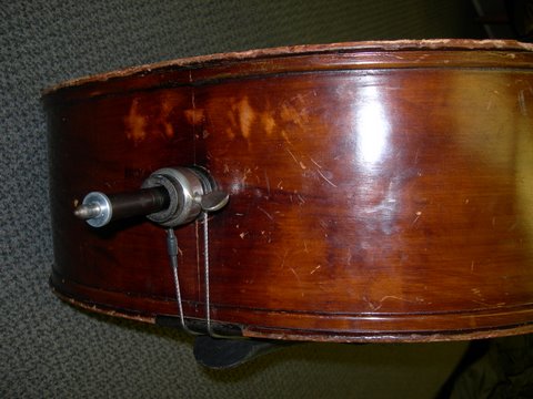

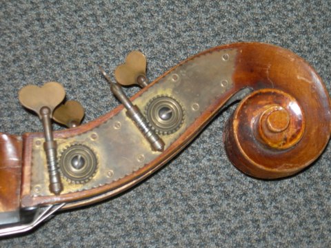

Ken Smith 11-14-2008 01:47 AM
also..
It looks like the Scroll/Pegbox was broken off at one time and repaired. I see Screw scars by the Nut area and a repaired graft mark under the pegbox in the rear by the button.
This is not a good sign because if it needs a neck graft again to fix it properly, it will exceed its value 2-3x the worth of the Bass in its current state.
I would walk away from this Bass. Even for free, it could cost way more to fix than it can ever be worth.
Don't feel bad. There are tons of Basses like this and worse that are on the market. The problem is that many people buy them without knowing what they are getting in to.
