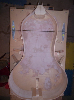

I played with the shape. It isn't exact, but you get the idea. I also think this would help with the bow clearance issue.
I agree with Ken (Smith) about the rib depth. My bass isn't particularly deep, but has a very deep fundamental. I think very deep basses have a lot of "spread" but not too much core. However, if you are going to 5.5" or 6" taper at the block then having her "fat on the bottom" wouldn't be such a bad idea.
Brian
