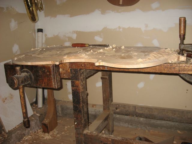

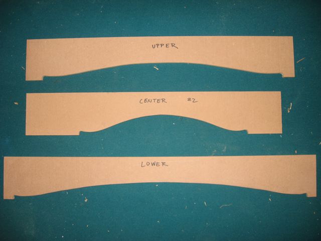

Craig, you are doing some really nice work there. I think your arching profile shown in the pic could use some tweaking, though. The transition from the convex arch to the flat (or slightly concave) zone around the edges looks extremely sudden to me. Personally I find basses sound best when the plates have gradual, rather than sudden curves. Hope this is helpful!
Thanks for the input Arnold. I made a new center arch and tried to flatten out the curve at the transition area as you described. Arch #1 did seem abrupt. Arch #2 is a lot smoother but I may tweak it some more. The top and bottom arches are much flatter at the ends and may not need adjusting.
I spent this weekend wasting away the spruce top by hand. I do not mind the grunt work; its a welcome change from the finicky stuff to come.
