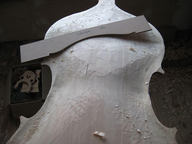

Photo #2
Top carving. Roughed it out, then started to work on the "east-west" or horizontal arching. Here is the C-bout arch getting close to the outline of the template. My plan is to establish the top, middle, and lower arches, along with the long arch. Then, blend them together into a beatiful bass top.
You may notice a pitch pocket of some kind has appeared in the top. It was not there when I started to carve, but slowly revealed itself as the top got closer to the finished size. I may have to do some type of repair.
