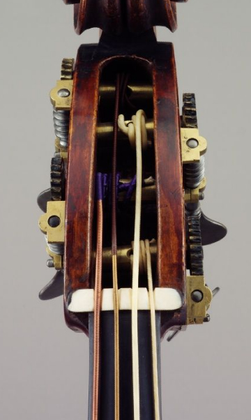

Here's a photo of an instrument attributed to Goffriller from the Cite de la Musique in Paris. This looks like an ivory nut?

Old 04-21-2010, 10:46 PM
Default ok..
I have seen a few pictured only but I wanted to make sure. On that bass above, any more pictures you can show of it?

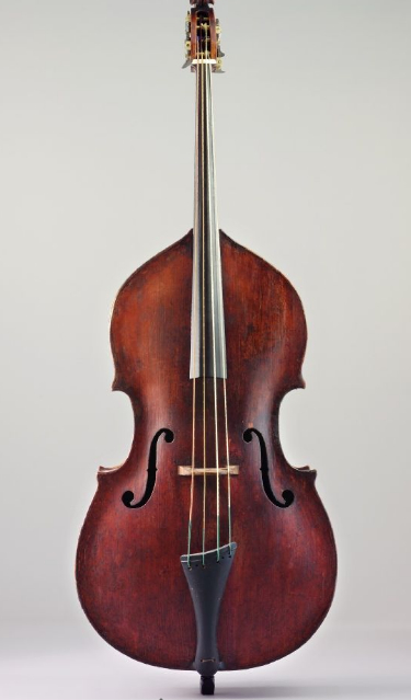

Hi Ken, sure, here's another photo. It may even be a Busan or Montagnana. It seems that they have no real record at the Cite de le Musique.
