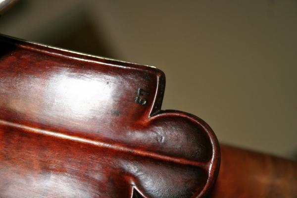

Ken, any idea what the 57 is????? other than heinz, lol

Well, can I see better scroll pics like the 'entire' back to get a look at the form? Is there another number on the other side? Like I said in the beginning, use my DB site for ideas on 'what' angles to shoot.
57? An inventory number from a school, store, shop?
