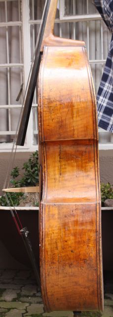

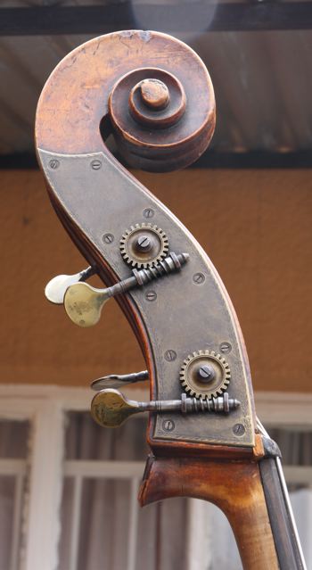

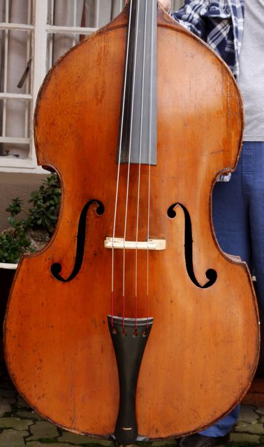

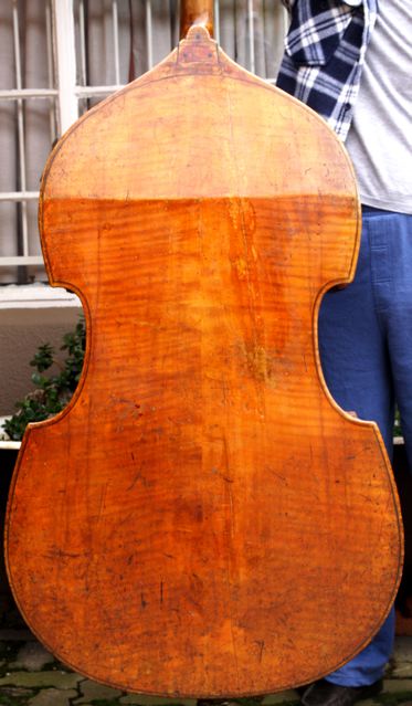

Yes, I think it is Germanic but Germany rather than Czech (Bohemian). I would go with Markneukirchen area or northern Germany in general rather than southern (Bavaria, Mittenwald area). Although the Purfling style is taken from the French, the outer linings/moldings and the angle bent flatback are Germanic in style and make, not French. The Scroll is another obvious sign of it being German over French as well. This bass also has some age to it from the early 20th century at the latest and the late 19th century or so on the early side. Ofcourse, upon personal inspection I might find signs that would date it closer but from the pics, that's my guess. The varnish also looks light pointing to a possible refinish at some early date but not recent.

Hi Ken , thanks for the info . The pics I have are high res so I could edit some close up details for you if it would help you better pinpoint the age ?
Also you are spot on with the older refin ! The owner says that the finish under the scroll plates is original and of a 'slightly reddish' color!

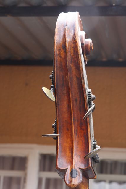

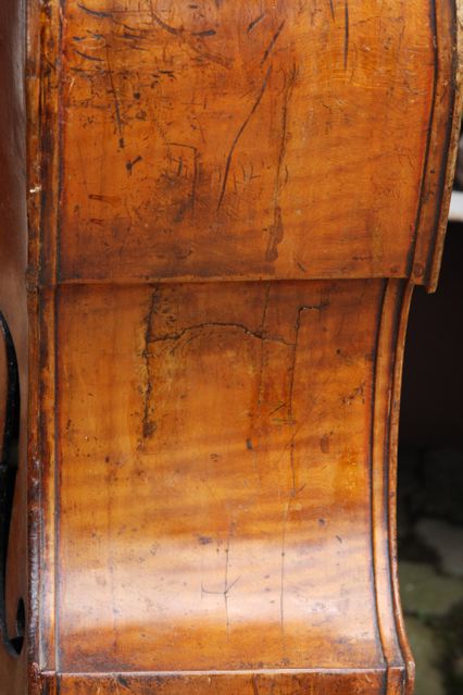

More to the point, you've got a screw through the back of the headstock -- strike one! It's questionable how well the neck-block is attached to the back -- strike two! There a bucket-loads of presumably-repaired top- and side- cracks: Whether this bass strikes out depends on how well the work was done, and that is just about impossible to assess online. (More accurately, it's often easy to tell online if work was bad but it's pretty hard to tell if it was good.)
Bring this guy off to a bass specialist for detailed, careful review before you pay anything. Sure, you could be getting a bargain, but it's at least equally likely that you're getting a project which will never achieve "full value" no matter how much money you sink into it.
Oh yeah -- whether it was refinished or not, having a slightly different color under the tuner-plate is pretty normal. That is the part of the finish which is not exposed to air or UV.
