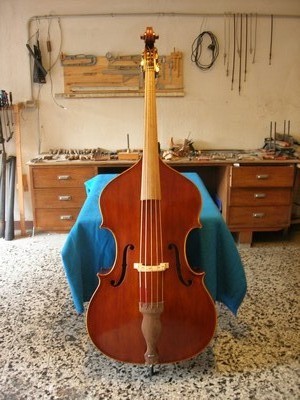

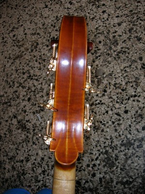

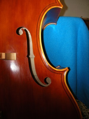

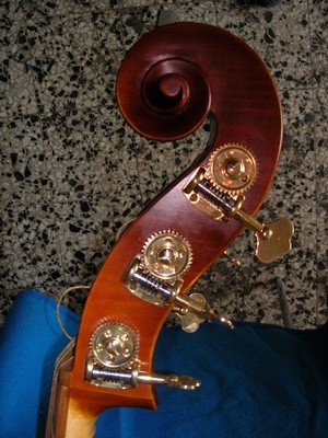

Hi All,
some pics of my latest instrument, and the best wishes for the new year 2010 to the bass players and makers
Name:	Violone Grosso0170.jpg
ID:	1404  Click image for larger version
Name:	Violone Grosso0171.jpg
ID:	1405  Click image for larger version
Name:	Violone Grosso0172.jpg
ID:	1406  Click image for larger version
Name:	Violone Grosso0174.jpg
ID:	1407  Click image for larger version
Name:	Violone Grosso0175.jpg
Name:	Violone Grosso0176.jpg

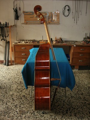

Old 01-06-2010, 01:22 PM
Join Date: 06-08-2009
Posts: 57
Default Violone Grosso
Some more pics

Old 01-06-2010, 02:07 PM
Thumbs up hummm
Very nice! Is Maggini a big influence of yours?
Old 01-06-2010, 06:45 PM
Very nice workmanship!
Old 01-06-2010, 07:14 PM
Join Date: 02-04-2007
Posts: 169
Fantastico Pino, bravo!!
Beautiful workmanship in the modern Italian style.
Old 01-07-2010, 02:32 PM
Posts: 57
Default Thanks
Thank you so much!
This is my first "Maggini influenced" instrument, as the musician's need was the right one to try it.
A period music instrument to be tuned DD GG C E A, with a short string lenght (102 cm, a bit more than 40) and a generous body size.
I think I will develop this design to make a modern double bass, the next time somebody will ask me to make a short string one, as I like more this shape now than before.

Old 01-07-2010, 09:30 PM
Posts: 57
Default Yes

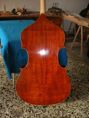

102 was the maximum SL I was allowed to reach, as the musician plays with a finger per fret (with the finger on the fret, not in the space between).
That shape of the body has a short body stop, mm556,5 (21,88) measured from the upper edge of the top, while the body length is mm1071 (42,16).
So I could make a long Eb neck to place the seventh fret before the curve of the heel and reach the 102 SL, while the body size is not too small
The lower bouts are mm662 (26,06), the upper bouts are mm519 (20,43),the C bouts are mm346 (13,62).
I hope that this let the sound be warm enough even with short strings.
Also, with gut strings we can try different diameters and materials, like sheep gut.
To design a new modern instrument I think that more SL is better, maybe working on the upper part of the body to lenghten the stop.

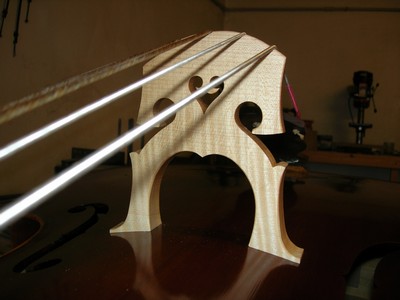

About the string angle: The width of the body of the Maggini "Dragonetti at the C bouts is mm 352.
If you want a low bridge you can't put on it more than 3 strings, or you can't bow them, even with wide string spacing and a flat bridge.

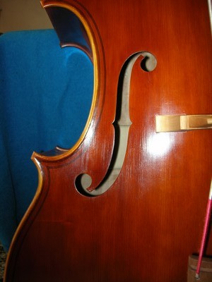

About the tailpiece, ther is a similar model on Praetorius.
Another is in the Elgar book, on an instrument attributed to "Pietro Zenatto".

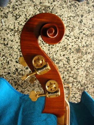

Tuning gears, to avoid spending half the time tuning and half the time playing out of tune.

The minimum thickness of the front is 4 (3,5 along the edges), the maximum is 8.
I don't think it's heavy...
