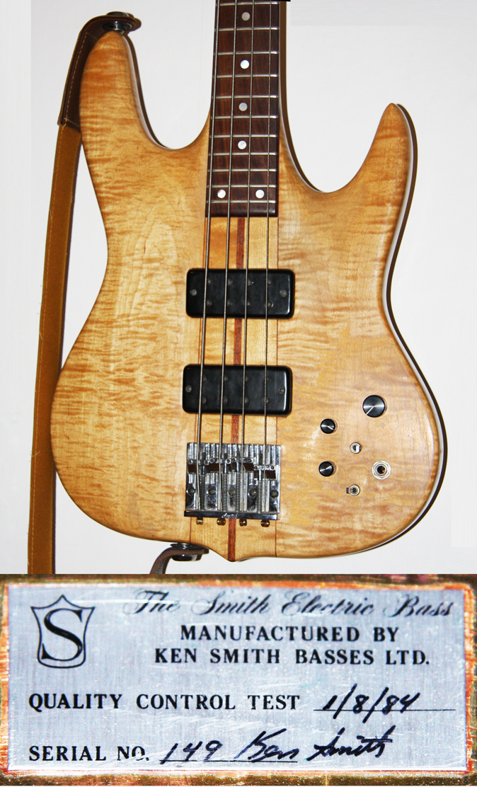

Hi...Ken, bought a PassII from you when you worked down the block frm me...was it 10th st? After 26 years it is still the finest instrument I've ever played...wondered if anyone could provide any information about it. Or point me to a source.
Serial # 149....1/8/84. Any favorite quirks that showed up over the years? What the original finish was? How many were finally made (I think you got more into active electronics after that)...do any brocures or tech sheets survive?
I'll attach an image if I can manage it...in the meantime, thanks for an instrument that turned out to be a lifer.

It would be difficult to list all the versions of the PAS II we made as well as the S II Set-neck models that were made. I would guess about 30-40 neck thru's at most, from memory of course. I don't have records from back then but I do have pictures in my files. Maybe 70% of the first 200 basses or so, maybe more. I think we made more or as many in the set-neck (dovetail) models as we did in the neck-thru models like yours.
The neck center on yours is Mahogany. I made a few in 5-pc as well and some I remember may have been 3pc maple with 2 veneer strips around the center of a rosewood 'like' wood and color. I experimented back then and did them several ways, some with out without Graphite. I inlaid the Graphite fibers mixed in epoxy myself. It was not as safe to do back then but I managed. No one else in the shop would touch the carbon fibers.
Nice bass there and glad to see it's been loved so much for so many years. Puts a smile on my face every time I see one of the earlier basses still strong and healthy..
