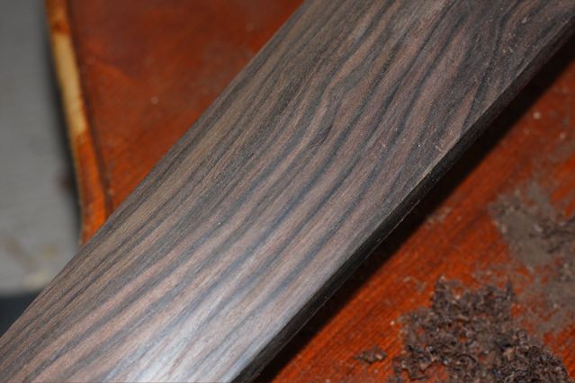

while planing an e-bevel out of this board I discovered after the black dye was gone that that the wood was not a great specimen at all / it looks kind of like rosewood to me , but also could be ebony . Any advice on wether or not to change the board
There are many species or ebony and several cuts from each log as well. Most ebony is NOT black as the grain is brown if noticed. This piece looks like the wood we use from Indonesia. This is true Macassar Ebony aka diospyros celebica.
To me, this is the best and most stable Ebony I have found. I use pieces up to 6 inches wide with no cracking in storage or use. For the Indian and African ebony's I can't say the same.

I think boards like that looks kind of nice - nobody will notice it from the audience anyway, so why not have a little character. Take the micromesh to it and get a mirror polish!
Few things irritate me more than playing a bass and coming away with black/purple fingers from a dyed fingerboard either - I just don't see the point in being vain about a jet black board!
Ken - do you have good ebony in sizes for DB fingerboards that you'd sell, or is your stuff reserved for your own instruments?
