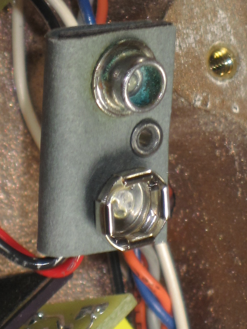

Ok here are some pics..If i touch the battery contact while its plugged in it makes static noise.. It even came back on once and then died again.
I think the wiring may have gone bad on the connection. You can see the bluish green corrosion and also a brow ring around the negative side. I do have a soldering iron.. this seems like it could be an easy fix

Ahh, that's what I suspected. I would replace the battery cap and wiring. It is an easy fix and if you are comfortable doing it, you'll be good to go before you know it.

So cleaned off the contact with a machinist stone and they defiantly need to be replaced...The connections are all loose but I got it working again..the connections seem really touchy.
I think I'll take it into a local shop and have them solder it I don't have the tools to do this.

Why not just locate a new battery cap with new wiring?
All you would need to do is cut far enough behind the damaged battery cap (including a determined amount of the original wire behind the damaged cap). Then just splice on the new cap and new wiring to the good/remaining wires. Make sense? It would be a very easy fix, however, if you are not comfortable doing this, then find someone qualified that is.

Based on what you have described and with the pics to support it, I'm not convinced it's the input jack just yet. However, you should clean your input jack and 1/4 cable plug ends on occasion with a good Contact/Control Cleaner & lubricant. You can get this at Radio Shack and it will last you a lifetime. How to? Don't spray it into and inside the input jack, just spray some onto your 1/4 cable plug-end (not dripping) and insert it into and out of the input jack a few times. Do the same thing to the inputs of your amp. This will remove any dirt and oxidation that may be there. Afterwards, wipe your 1/4 plug-ends dry.
While you are at Radio Shack, buy a new battery cap.
That sounds like an easy fix I'm willing to try.. As long as I dont have to solder anything! I thought I had to take the wire off and re solder a new one to the circuit board.. I think I can handle splicing the wire!
