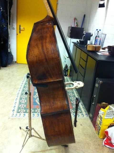

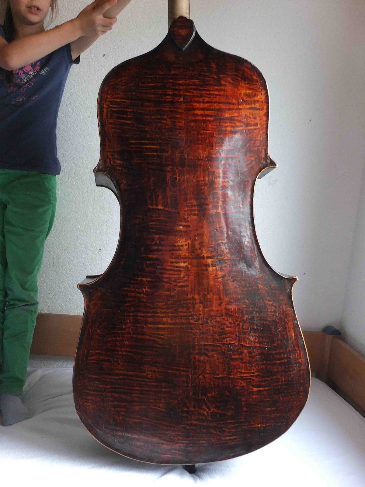

need help for idendification of a bass: italian or fake (hungarian) dear folks,
i am not sure how to post a new thread, so i am trying to find some answers here! there are a lot of fake basses around and i need some opinions from some proīs like ken.... here are some pics of the bass which is presented as an old italian bass. there are some characteristics that it could be italian but very hard to really be sure. i would be very thankfull for infos what kind of bass this could be. thanx in advance.

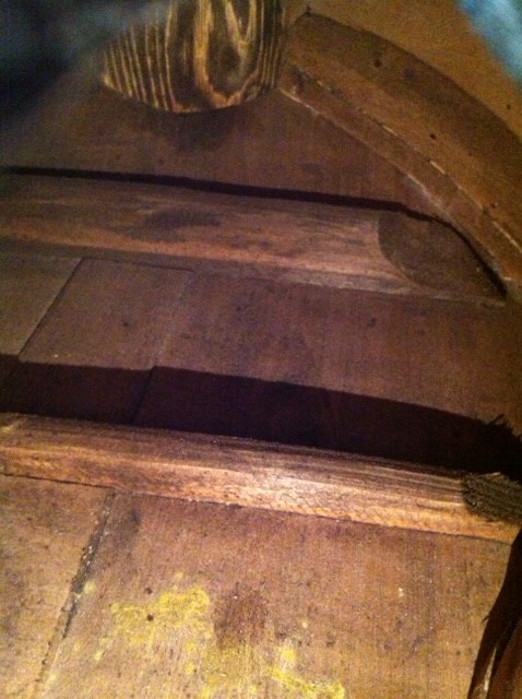

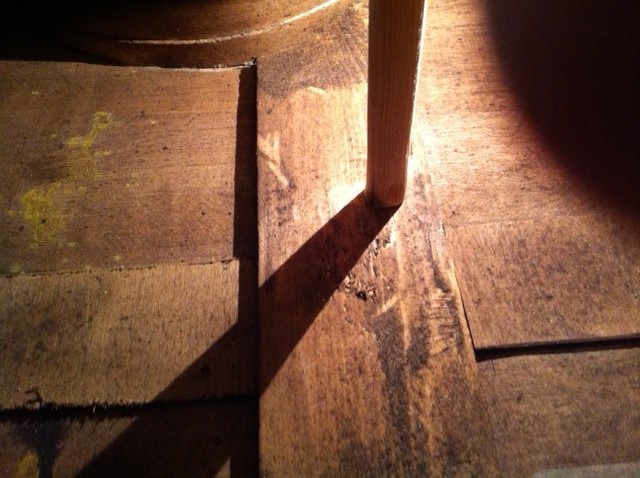

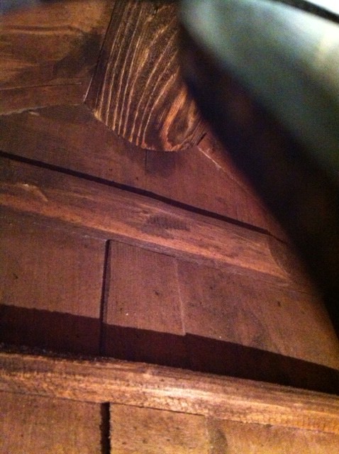

some more pics from inside.......
thank you in advance!!!

Lightbulb It's a fake
The wood looks to be acid treated inside to make it look old. Take the bass apart and scrape the top down and re-graduate it slightly and smell the fresh Pine wood.
The Scroll is Hungarian style, something you will not usually see on an old Italian.
When you remove the Top, you might learn how poorly the blocks and braces were fitted. That is common with some of these fakes and copies. Also, in time, things will move and come apart. Maybe not so much in a more humid place like Germany or Italy but in NE USA, this would come apart in a year going thru the seasons.

I can't tell exactly the woods from those pictures but the bass seems fairly new. Old Hungarian basses look Hungarian. Old Italian basses look Italian. This looks like a recent fake.

well, thats a clear message. not even an old fake.
itīs discusting how many fakes of old basses are floating around.
i had hope that it could be a simply build old bass, but i was wrong.
thank you very much for sharing your experience.

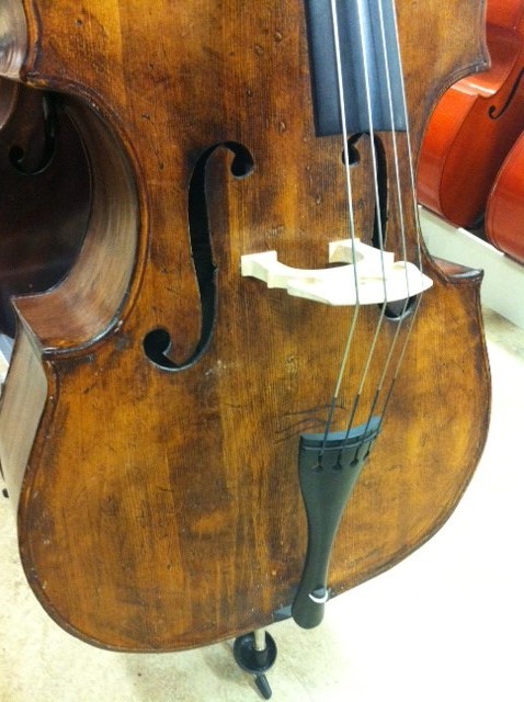

dear folks,
somebody offered me another bass. the seller told me that this is an old italian or english bass. again, i am not sure if this is a fake. very hard to tell!
to me it definetly looks old, but the back of the bass looks a little strange?
i would be thankfull for any ideas or identification-marks! my eyes are not experienced enough to really tell.

This bass has the same type of work as the other. Possibly the same guy in Hungary made both. If the bass is not close to $100k-$400k and has some history of where it has been and who played it, it is not an old Italian or English bass. Old basses don't just pop up from no where.
Now, I have seen a few, bought and sold a few and even have a few old looking recently made basses. I sell them as new basses that are made to look old but never represent them as being old. If you like the bass and it sounds good, buy it at the right price. But, don't go thinking that you might have a Busan or Goffriller for a steal at 1/10th the price.
One of the best restorers and makers in Europe is now also working in his 2nd Berlin shop as well as in Hungary, back and forth. Raez Barnabez. He is one of the guys that can tell what is fake or not because he knows the guys in Hungary that are doing this kind of work. Ask him!

The Top is a softer wood and cracks easier than the hardwood back. Round backs do not crack as much as flat backs. Cracks can be put into new basses and new basses can also be made with cracked and distorted wood to fake aging. A genuine old bass will show its distortion and condition over time depening on how it was cared for.
In Hungary, people there make from about $400-$600 a month in income from what I was told by Hungarians, Luthiers, Doctors, anyone, unless you have some other business on the side with the outside world. They are 100 years behind the world 'we' live in. To make a fake bass is their goal, those makers. Survival is to fake and make more money even if it takes 2-3 months to make it. Not all the Luthiers in Hungary are fakers, just some of them. They even take new basses from Romania and fake them as well to look old. I have seen them and had 2 of them here.
As for finding a good deal on a real old Italian bass, good luck. You will need it. lol
