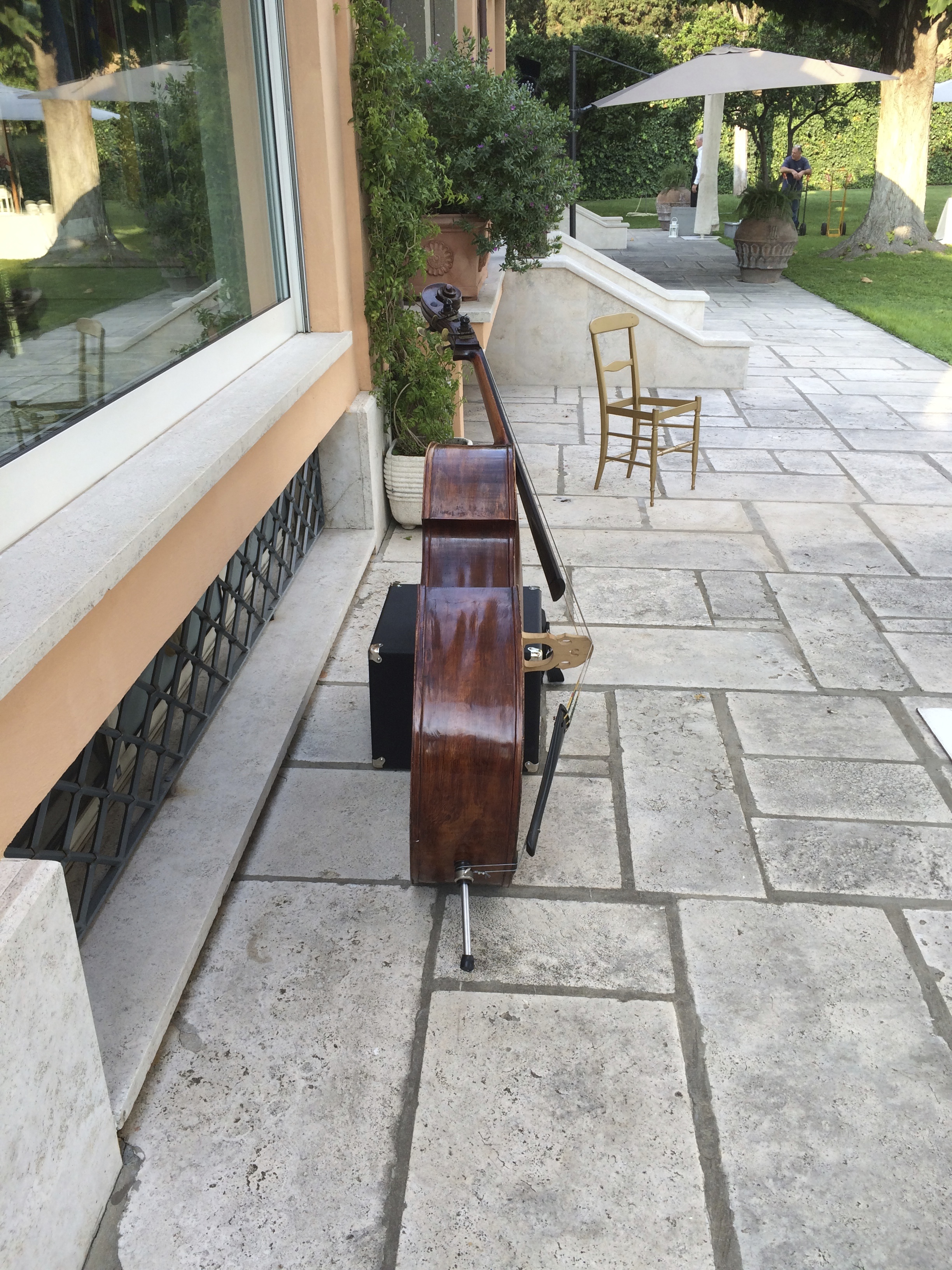

Hi all
I found a private selling this full-size bass (114cm string lenght) just few weeks ago. There's no label inside and he doesn't know the provenance.
The bass was supposed to have been decades unplayed.
Could you help me to find the origin ?
Thanks in advance.

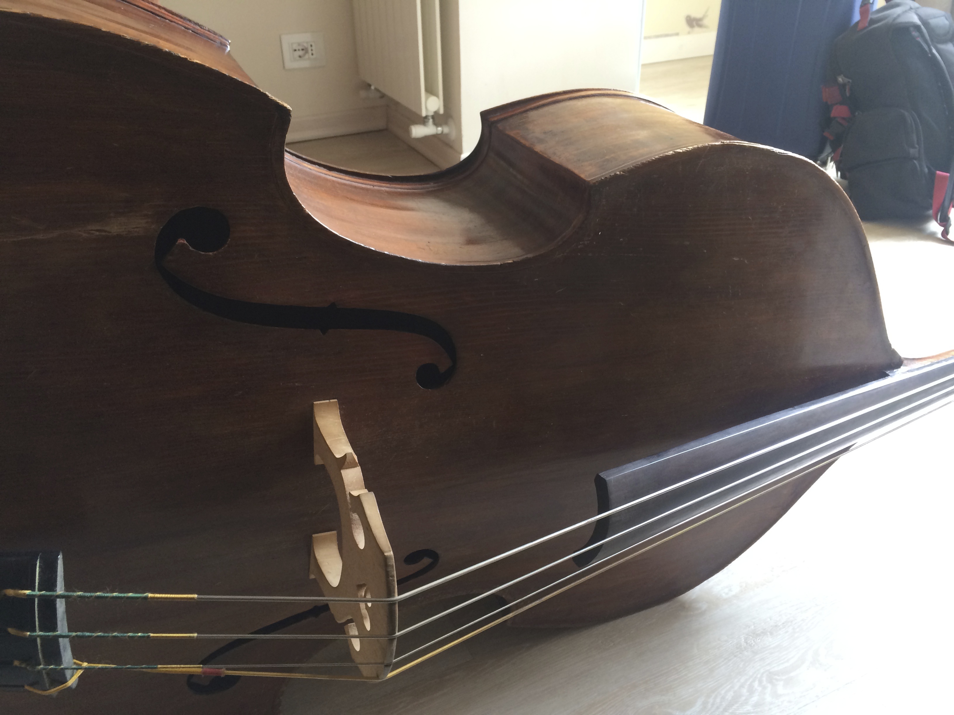

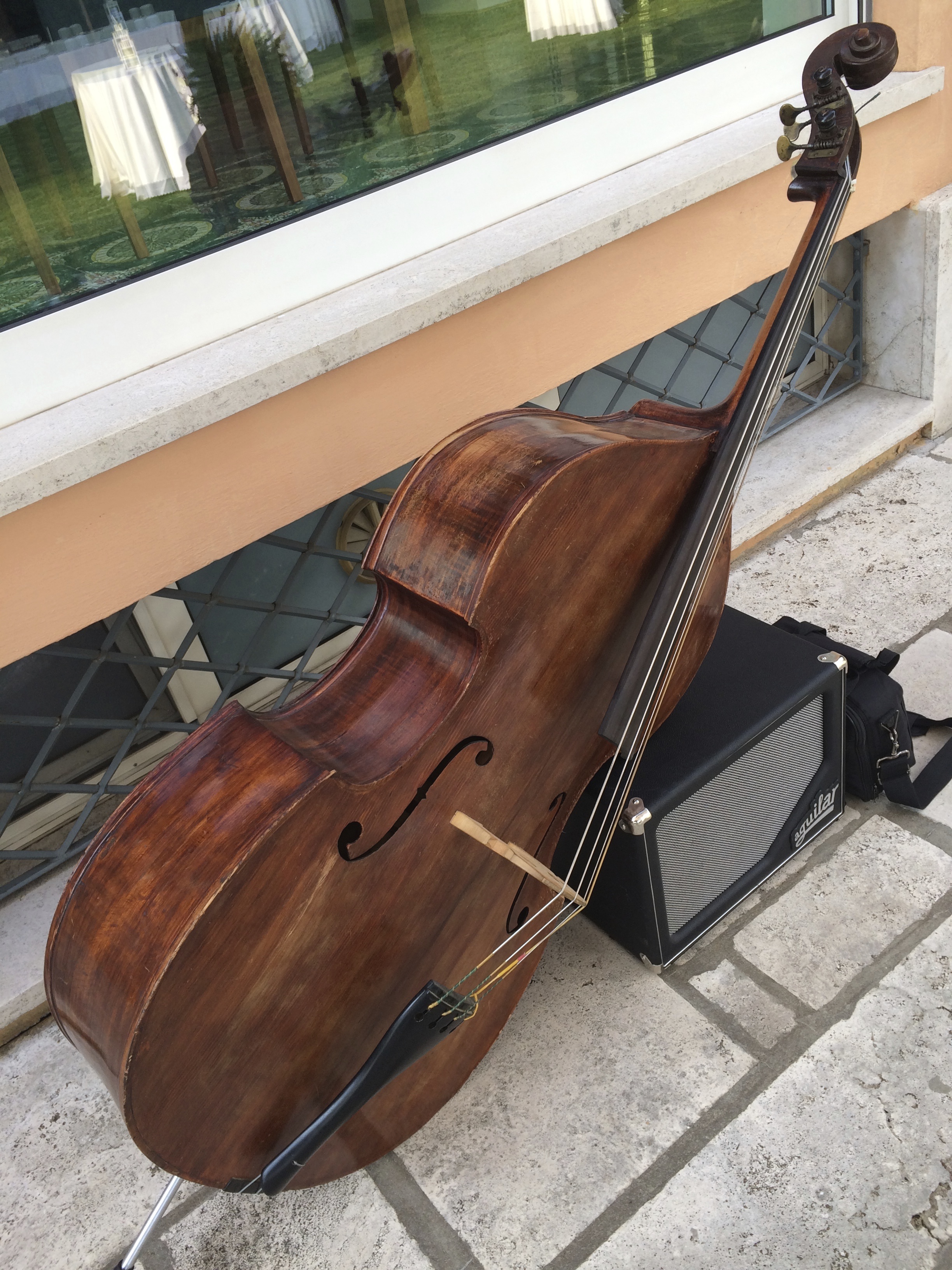

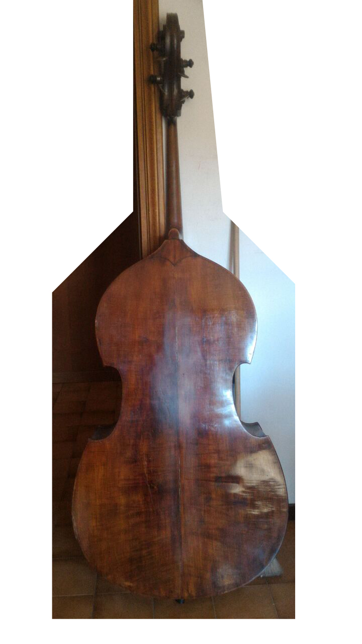

This is a Low End (made on the cheap) Germanic bass, turn of the century or so, Flat back with plain woods and beech neck. Many ugly repairs but not too many of them. Over or re-varnished as well. 114cm is WAY too long for playing anything today professionally unless you are over 6 feet tall, a Giant. 107 or less should be the maximum length in my opinion.
Even if this is for free, playing this bass long term can be painful in the short and long run. Both physically and musically.

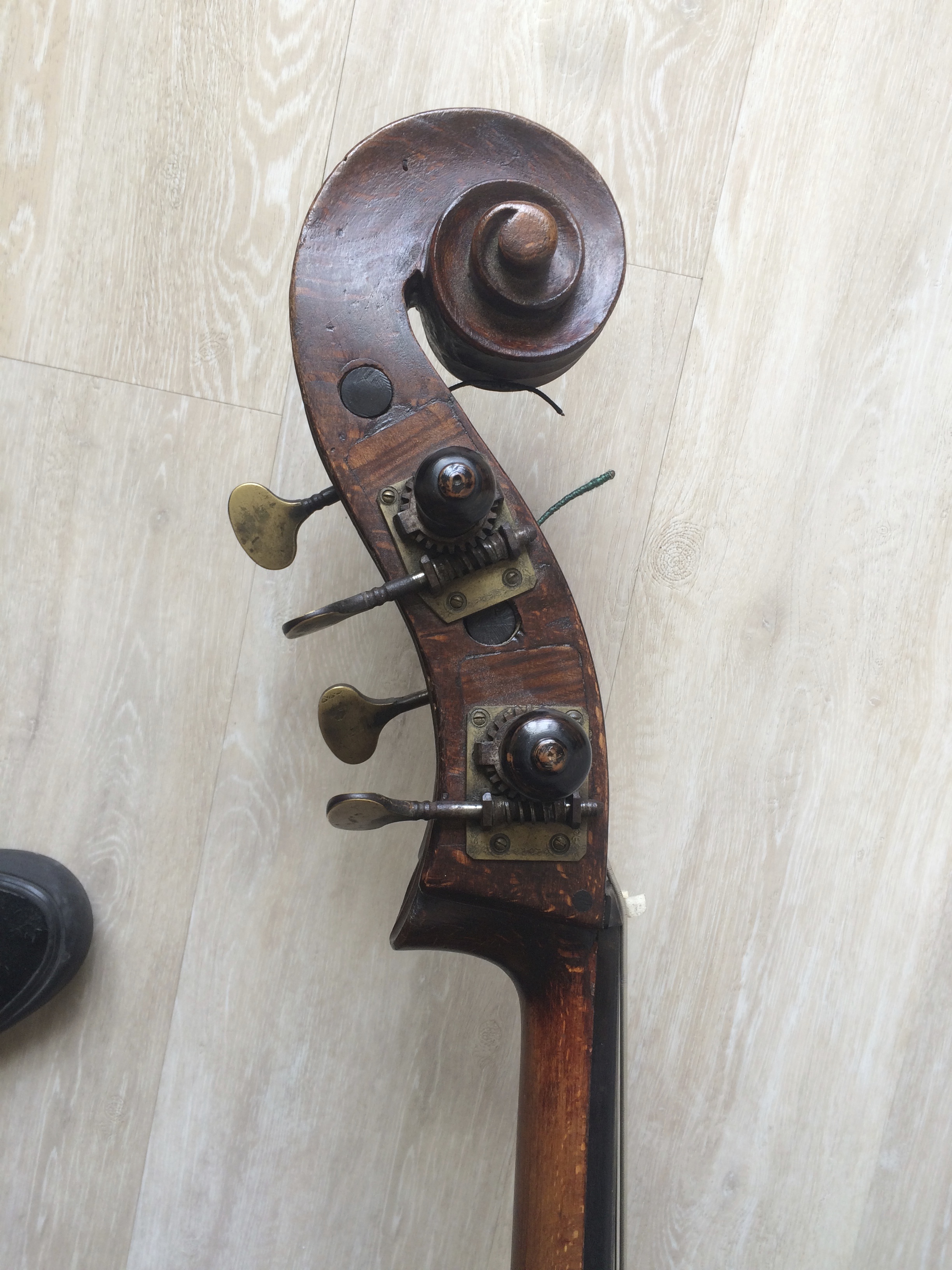

Which repairs specifically ?
Could it be an old 3 strings ('cause of the scroll) ?

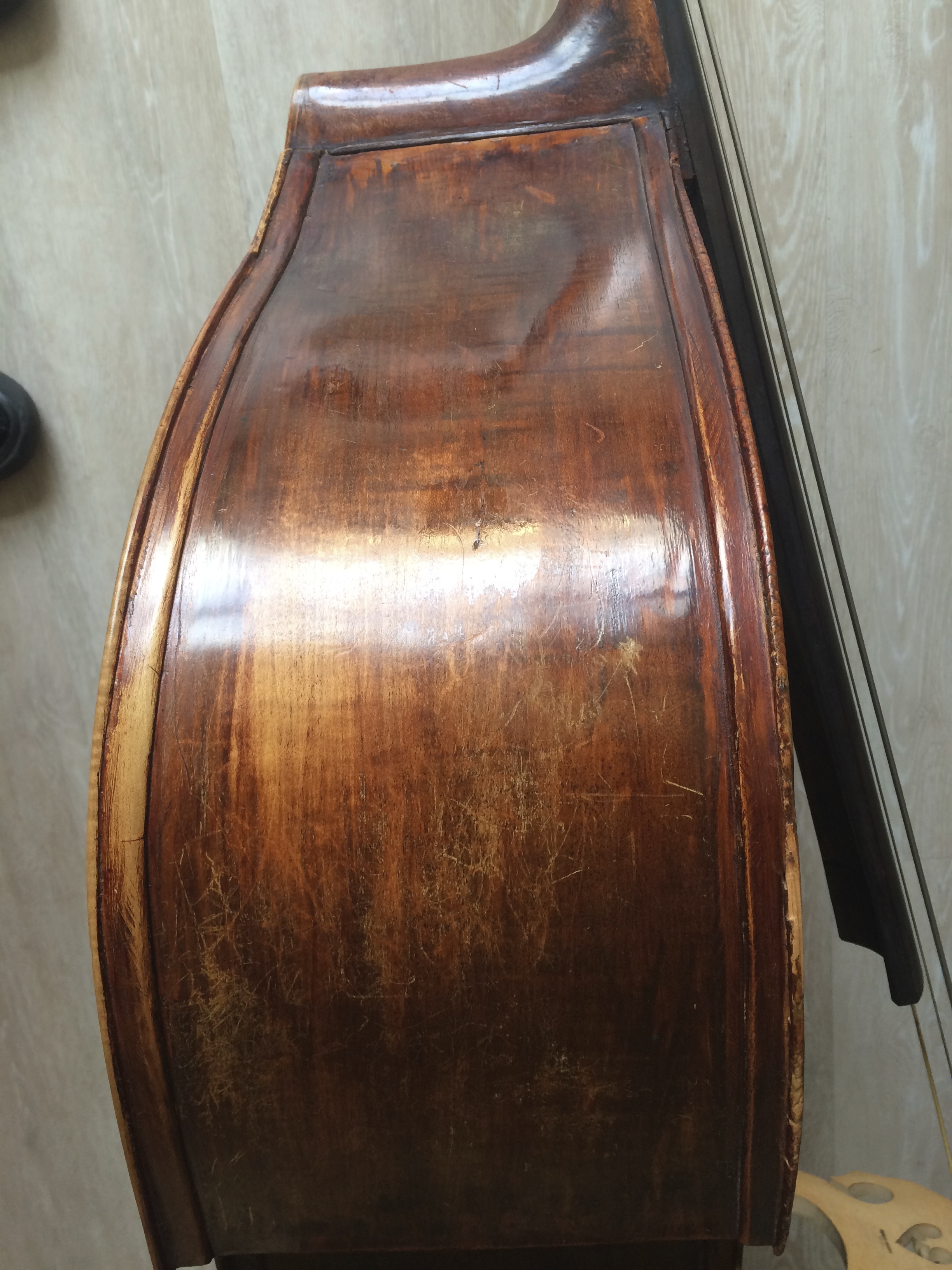

Scroll Repaired, back repair where the neck broke out from it before, bad over varnishing, etc.. Value for a bass that no one wants to play? I don't want the bass at any price. Fixing it and making it 42" scale will cost more than the bass is worth many times over. It is just too big. 3-string basses were made into the 20th century. That means nothing. The health of the bass means a lot and the size. If too big to play comfortably, I don't see it being worth any investment at all.
