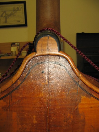

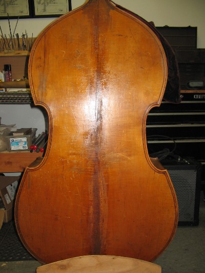

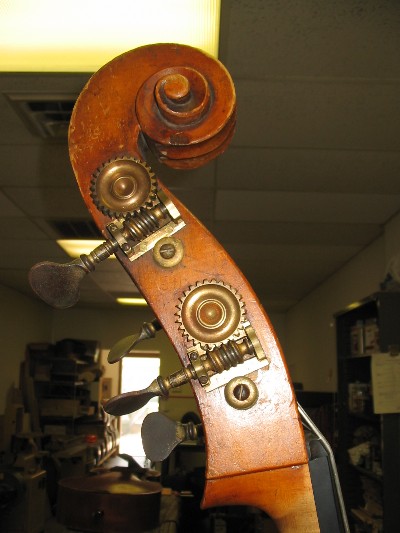

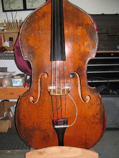

Hi. Someone brought this bass to me for some minor work. Here are some measurements:
lower bout width 25.5"
upper bout width 20.5"
rib depth not including plates lower bout 7 7/8"
rib depth at neck block 7 7/8"
length of back from bottom of bass to top of button 45 3/4"
string length 42 3/8"
no "break" in the flat back.
Very long scroll and pegpox.
Three back braces.
Top looks heavily wooded.
The back has a center seam inlay and the varnish over this must have deteriorated, giving the varnish on the back that look.
There is a faint stamp in the back that's impossible to make out and a partial label that says "Bonne..." The stamp looks like it's from a general musical instrument shop. Pianos, organs, etc.
Anyone have some insight into this bass? It sounds great.

It want's to be a Jacquet and might well be. The Purfling is a big further then the edge from the others I have seen so not quite as nice. The scroll is the typical Guild/Union made Scroll as fond on most French Basses from the latter part of the 19th century. I only have the body, purfling, FFs and Varnish to go by but even then, the Varnish was done by the Guild as well.
The Back style without rib taper or angle break from either the upper corner blocks or both the lower and upper on some does not fit any Jacquet I have seen. The FFs don't match the examples I have seen from 3 of the makers, the 4th having worked with one of the brothers or his brother-in-law so I have never seen his personal work.
This family of 4 makers specialized in basses and became quite famous for them. I would not rule out a lower grade Mirecourt copy either.
Jacquet style is all I can say for sure. Unless someone has seen a similar labeled or branded Jacquet bass and deemed authentic I can't say for sure it can be attributed to them. Just 'in the style of' is the safest way to go.
