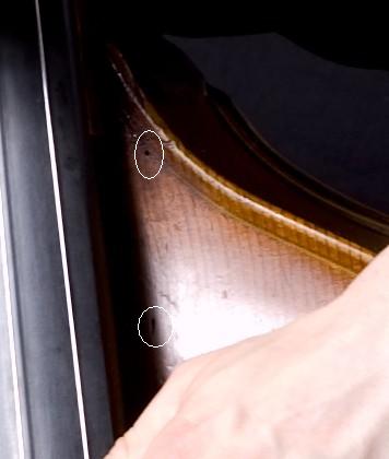

Hi everyone
I just got a horrible surprise when I picked up my bass and found several small holes dotted around the top near the neck block
It looks like woodworm
WHAT DO I DO????????????????
Help
thanks
Will
Old 04-16-2009, 05:57 PM
Default well..
Are the worms active? Old worm holes?
If alive, kill them with some kind of insect spray unless there is a better method.
If they are dead, have the damage assessed IF it's even a concern. Many many old English and Italian basses as well as other basses that lived in these countries have old worm damage. It's part of the sound and if need be, the areas can be repaired depending on what's needed.
Show some pics if you can.

Old 04-16-2009, 06:42 PM
William Stephens's Avatar
William Stephens William Stephens is offline
Join Date: 08-03-2008
Location: Newport, UK
Posts: 18
William Stephens is on a distinguished road
I just found a pic taken last summer...I zoomed it up and it looks like 2 of the holes were there then..
maybe they are old holes after all......
As soon as I saw the holes I went into blind panic with visions of my bass being eaten away to dust in a matter of days......

Lightbulb worm?
I looked at the pic and unless it needs to be more clear on the focus I would say that it's not a worm hole. Worm holes look like tint pin holes. Also, that's a factory German Bass from what I can see. Worms usually have expensive taste and only eat in the best places, that being inside English and Italian Basses..
Old 04-19-2009, 05:04 PM
Location: Wainuiomata
Posts: 0
I looked at the pic and unless it needs to be more clear on the focus I would say that it's not a worm hole. Worm holes look like tin(y) pin holes.
I agree, our 'worms' tend to make several holes near each other, but maybe we have a more energetic class of worm Down here (NZ).
