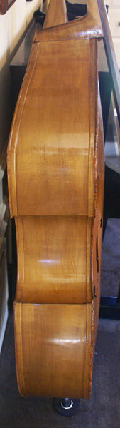

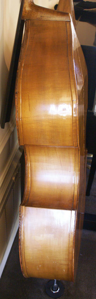

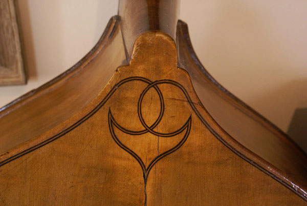

I'm getting ready to restore this bass. I would like an opinion about this instrument before I decide how much to do. I can't tell who made it. The only label is the "Made in Chechoslovakia" sticker. Can anyone tell the approximate age? I have owned it since 1958 or so. Played many jazz gigs over the years.

A "Made in Czechoslovakia" sticker means it was made after WWI and labeled for export. This bass already looks like it was refinished and not such a good job. The varnish on these 'factory/shop-type basses made for export' is usually of low quality. I am sure since the original varnish is gone another better attempt wont be such a bad idea if done to a high violin grade standard.

Well, a bass like this is not one for international marketing or even national for that matter. It is something you will sell more locally or just use it yourself. That being said, it is worth what it will bring in your area, not mine. I don't know your exact market or buying range for players there.
On the Bass itself, it has extensive damage to the Back and the Top, both of which look to have been poorly repaired in the past. This will be an expensive restoration to set right. The Ebony parts is not your main expense but rather minor in comparison. To cost to restore this bass might exceed its total value in your area as well as mine. If it were a German roundback of a similar vintage I would say it would hold slightly more value as the Round Back is rarely an issue. Your best bet might be to clean it up as inexpensively as possible and put a new Fingerboard and Nut on. The TP is not important unless it's broken. I had a rosewood type TP on my 18th century Italian bass for 20 years and never thought twice about changing it.
For the Varnish, knock down that gloss and unevenness about it and put some darker coats over it. Don't bother stripping it. It's not worth it and not so easy either.
These kinds of basses sometimes sound better than they look and sound more expensive that they are worth. Get it ready for use and enjoy it.
