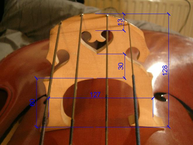

All things being equal, how much wood between the crown and the heart is ideal? I’m asking because the bridge on my bass is very short. Please see the attaches image. The string height (in mm) at the end of the bridge for: E=10, A=10.5, D=9.5 and G=8.5.
I am going to take the bass to the local luthier. I know that they cut their own bridges but if they follow the “industrial standard” (Despiau, Aubert) it would mean I’m gonna end up with a bridge looking just like my existing one and I really don’t like the look of it. Mind you the feet of the existing bridge are only about 0.5mm thick. I think the feet should be thicker than that, which means I will lose even more wood between the crown and the heart. Only way I can think of getting more wood between crown and heart without increasing string height is to shorten the legs. Does the length of the legs of the bridge have a direct/huge effect on sound?

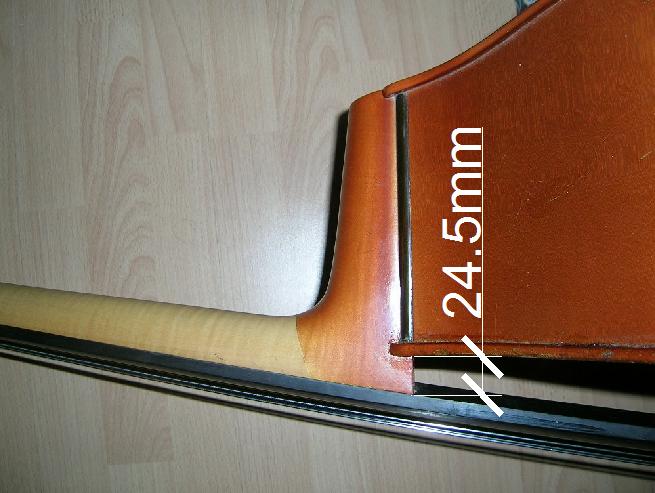

I’ve also attached an image showing the overstand at 24.5mm. I don’t think that this is particularly low, and the arch of the table doesn’t seem particularly high. Maybe it’s the angle of the neck/heel?

Wow, such a low Bridge with such high string height. I don't know if these are carved or laminated basses but being generic Romanian Factory basses, they need work that could cost more than the value of the Bass.
The Overstand at 24.5mm is very low. I think that 35mm is much better and almost a minimum. The Bridge should be about 6.5" or 165mm high in the middle with the Strings over the fingerboard at the end from about 5mm/G to 9mm/E or so. I play lower even.. To go heigher, raise the bridge adjusters that you should have as well.
To get this Bridge height with lower string height which will allow better Bow clearance at the C bouts as well as easier upper register fingering, you need a combination of good overstand (35-40mm) and proper Neck pitch in the Block. In your case, moving the neck out will only increace the Bridge by about the amount moved unless the Pitch angle is increased as well. You need a lot more angle to go from about 5"/128mm to 6.5"/165mm.
This is what I consider a normal set-up to play the bass in todays world. Anything less is a struggle. This Bass in my opinion was set-up wrong when it was made in the factory. It might be cheaper to get another bass and sell or trade this one in.

Even though the crown is narrow, and the blank is a cheap one, the bridge looks kinda normal shape to me. You see that "lowbrow" look quite often.
You say the first thing to do is to change the bridges, and yes a nice new bridge blank will certainly look nicer and may sound a bit better, but I suspect that any improvement in sound just due to bridge crown shape, or the amount of wood over the heart, or leg length, may be small compared with the improvement in sound you could probably get just by giving the basses to a good luthier to tweak a little, and putting on some new strings. I suggest asking the luthier what he/she suggests is the best way to spend your budget!

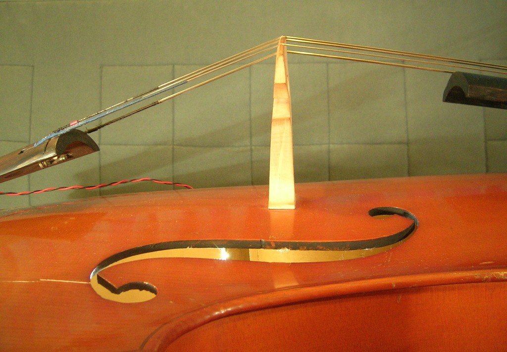

The reason behind getting the bridge replaced is due to the way it is current fitted. The bridge is perpendicular to the table on the fingerboard side, instead of the tailpiece side. Please see the attached image.

Well, again, that bridge looks kinda familiar. They often come in like that but my instinct tells that unless there's a compelling structural reason to rectify it, just changing out the bridge so the back face is vertical instead of the front face is not necessarily money well spent.
Stabilising that crack before it gets worse, on the other hand ...
I think you need to think of finding a luthier as signing up the last team member in your bass adventure. Its you, your teacher and your luthier. He/she will be able to give you advice that no-one here really can, cos we're not there playing the bass. If you're willing to pay someone for their expertise you may as well listen to what they have to say, even if you think you know better!
Lastly, when you can buy a serviceable bridge blank for between $50 and $90, why bother making your own? The cost is in the time and effort the luthier puts into fitting it to your bass, and you can't do that on a CNC machine ..
[edit: Despiau, Aubert etc also manufacture their blanks in different leg heights, tall/squat, so you can probably get what you're after if your luthier knows what to order. Also you might like to put adjusters in the legs, then you can do pretty much what you like, cut down the legs on a taller blank, if you really want to! And again, IMO changing the bridge wood/shape/height etc may change the sound, but not as much as other adjustments might do. Get the basses set up to play well; fingerboard work, soundpost adjustment, nut slots, cracks glued, general clean-up etc will do wonders!]

A cheap fix is to lossen the top from the neck block and along the ribs all the way down to just past the top corner blocks. Pull the bass neck forward and try to get about 150mm height projected to the bridge, or inside f hold nicks. Reglue it. Put a piece of spruce in the gap betweent the top and the neck.
Bridges are also sold with different width feet to better fit in relation to soundpost and bass bar.
Finally, you might consider a smaller bridge e.g. a one half size.
None of this is what you'd do to a really good bass, but it can make the bass playable for a lot less money.
