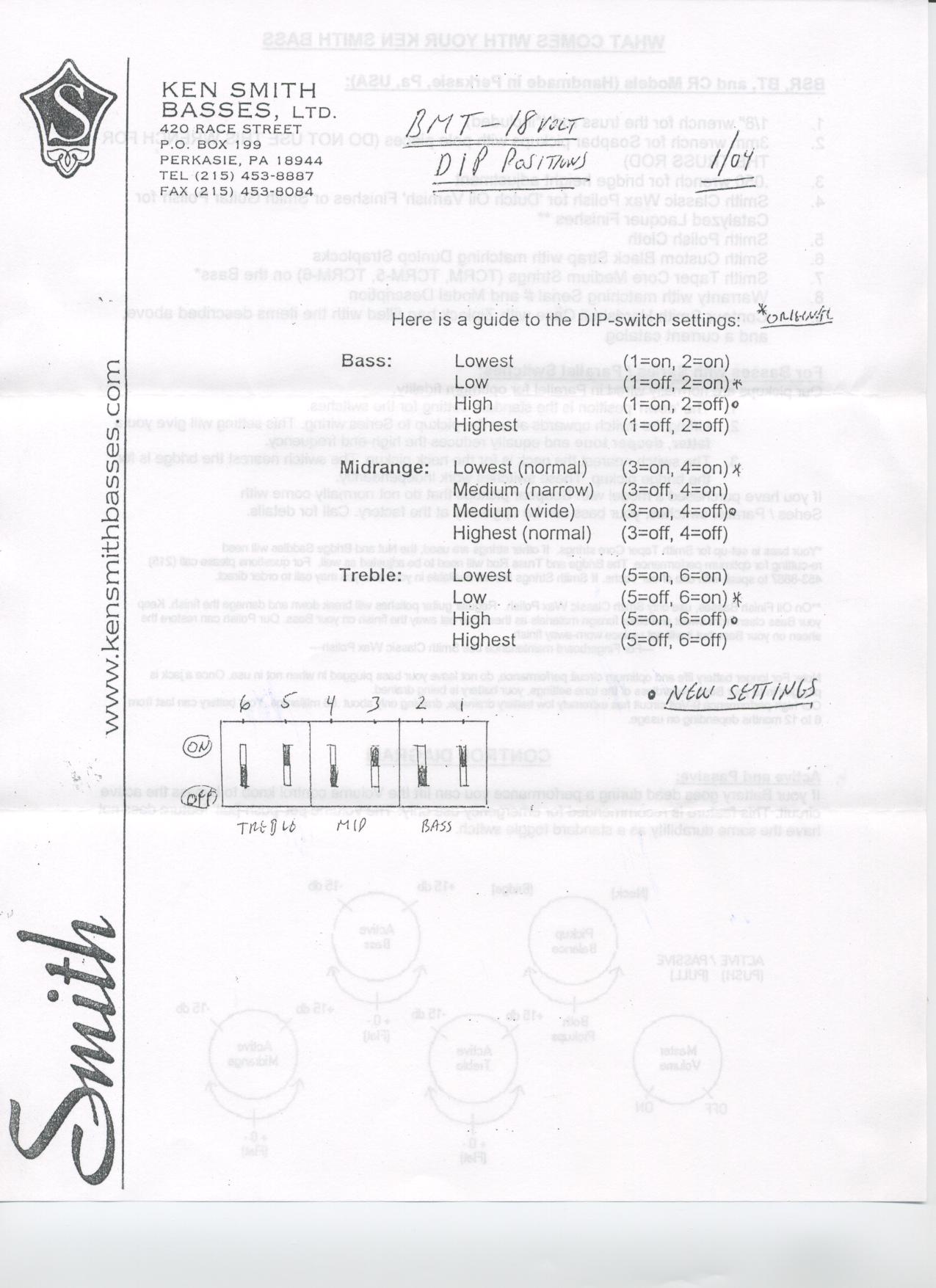

I know, I'm as dumb as, as.....a very dumb thing, but I am struggling a little with DIP switch settings.
I have a new to me '05 BSR5GN and upon searching found that my DIP switch settings match neither the OLD or NEW settings as discussed. Mine are all over the place. It still sounds good if a little mid oriented, looking for a little more warmth if poss.
Anyways, my question is really simple, is ON up or down ??? I can't try the other settings till I know this.
And whilst I've got your attention, the TRIM pot, is that the WHITE column with the white wire coming from it ?? I know on the 9V models its a little BLUE switch. Mine of course is 18v.

That is the Bridge ground pin. Don't touch it. I think Up is facing the wood as it's installed. Look here at the PAPA layout for the DIP settings; http://www.kensmithbasses.com/papa/P...et-rev7-09.pdf

Here's a print of the "Original" and "New" settings.
