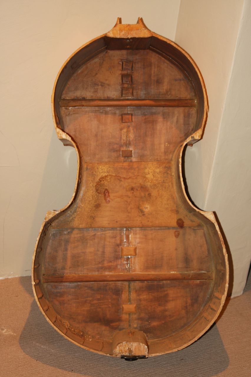

What is intriguing is that this bass has been worked on by a number of people over the years , the original finish looks to be gone but the inside of the bass looks to be pretty old ?? I have no idea how to judge this instrument as the outside varnish is new but something tells me that that this may have been a good instrument .

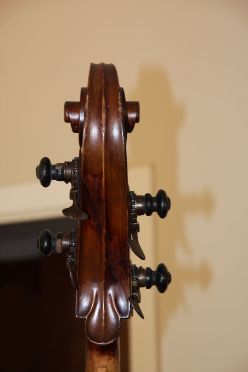

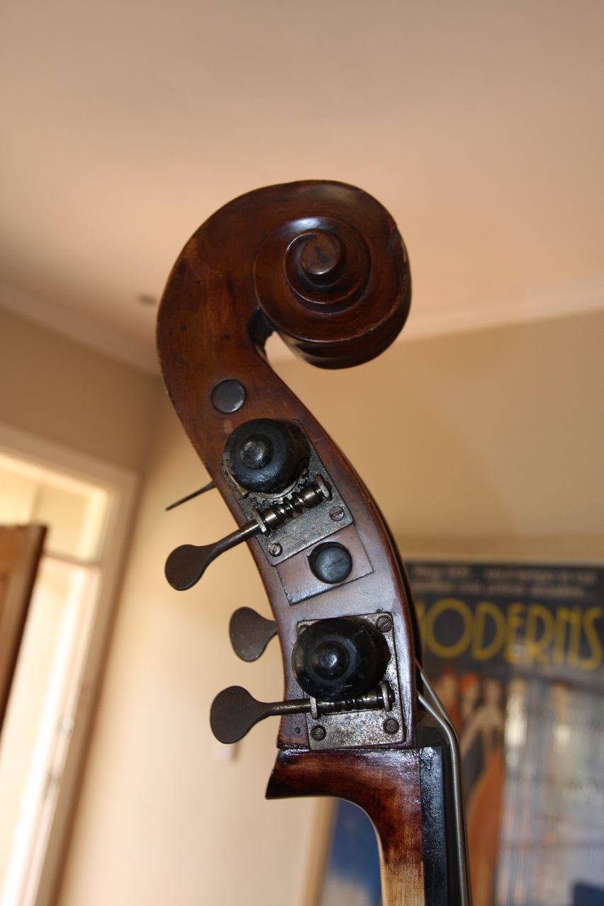

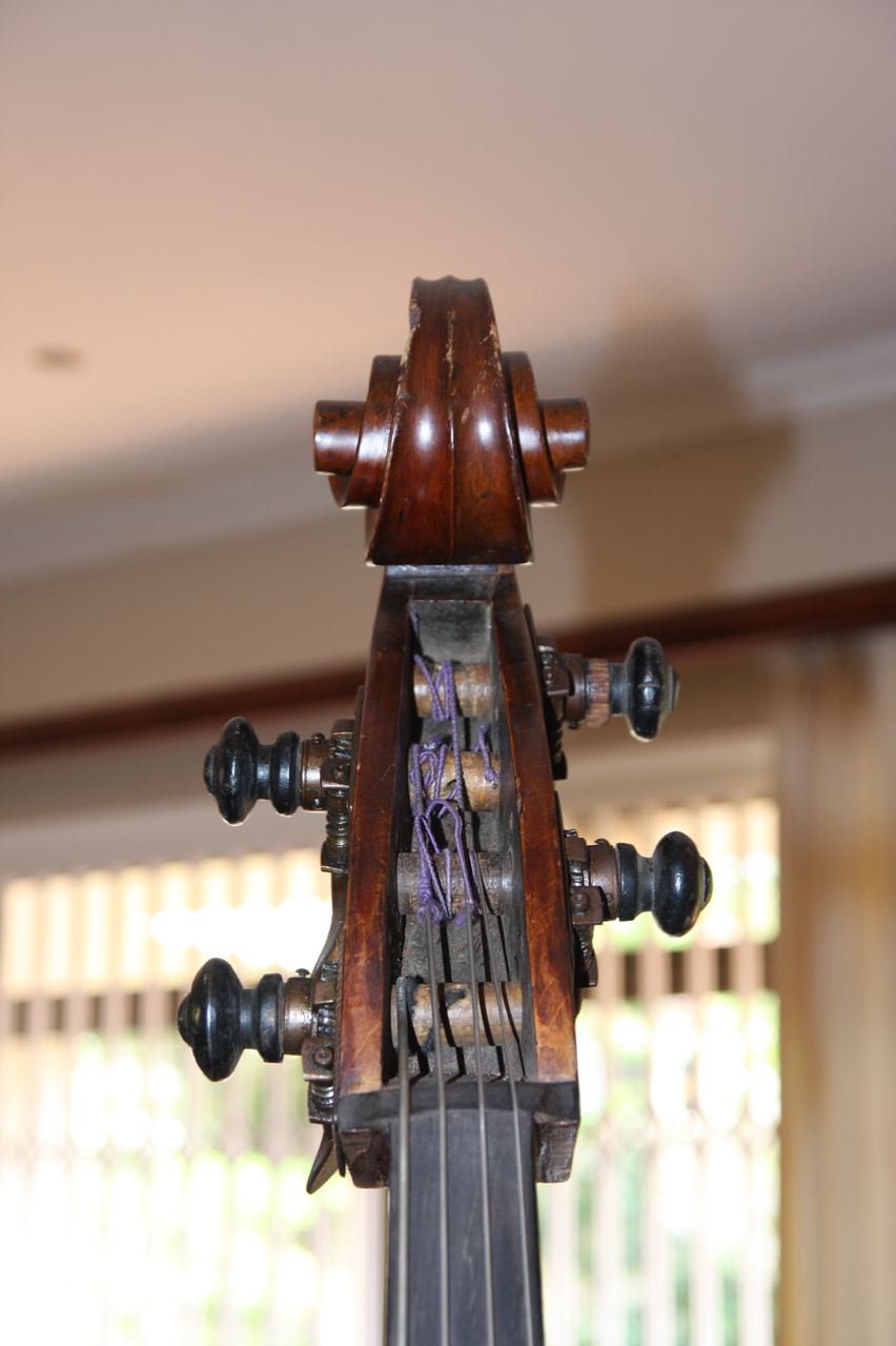

Ill include pics of the actual scroll that was on the bass , its actually quite nicely carved.
Ok Ken , do your worst !!

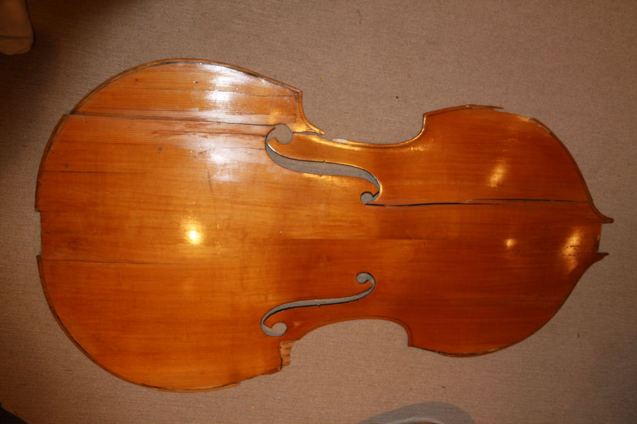

This looks French from the inside and the Back does as well. The Top is in poor shape and hard to see its true form but I would say Mirecourt factory Jacquet school. The Scroll is French as well and was maybe a 3-string converted to 4 but modified with German Gears. A total mismatch in my book.
Re-varnished poorly as well as the Scroll in a darker color does hurt the value quite a bit. The Scroll although French as well is no guarantee it belongs to THAT bass. The Scrolls were usually 'Guild' made anyway and were supplied to more then one shop from the same supply but having it all original is a plus.
That center wide crossbar is original but the upper and lower bars were maybe added later. The French did not usually mix those two designs that I have seen.
Sounds interesting , I guessed maybe French ! It does look like it may have been a 3 string at one time ( at least the scroll does ).
What age do you estimate it to be and do you have a pic of a bass that you think may be from the same school and era ?

That huge crossbar is whacky! The soundpost would need to sit on the northern edge of it to be properly placed.
Old 11-30-2009, 02:28 PM
Wink ??
Arnold, looking at the Top and the F-notches, the 'Post would be the lower third of that 'Bar just south of the middle of the C-bout. If you click on and blow up the pic of the inner Back you can see a mark from the Sound Post on the lower 3rd of that wide Bar.
Old 11-30-2009, 07:58 PM
Right. I was seeing the space between the middle and lower bars as the middle bar. Now I see...
