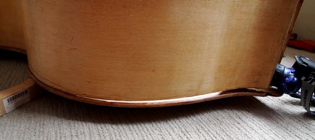

There are 3 possibilities
1. as you say , the back lost its shape
2. the ribs were cut down at some stage
3. the maker didn't mind 'springing the back'
I have attached pic with a torch shining in the gap to highlight the gap...
Old 11-26-2010, 09:05 AM
Make sure the back makes good contact at the upper bout linings and neck block. Of course you want to size the blocks. Then glue the back on starting at the tailblock, and working your way up. (You'll need to keep it temporarily clamped at the button area to maintain alignment.) This method will spread the "spring", just like the original maker did. Hopefully, you have already flattened any obvious high spots, and made sure the glue surfaces are true. The small amount of spring in the back will actually tend to counteract the string tension, so don't be concerned.

Old 11-26-2010, 09:41 AM
Join Date: 08-28-2009
Location: Johannesburg
Posts: 215
Adrian, you are the cautious one, no doubt.
No more gap than what you have, i would glue it - will it not draw down fairly easily?
I had a seam pop open on a flat back and the back and there was a gap of about 2 inches. This was several years ago and it was a bass that I had made. I called the maker and he said to just glue and clamp it. It worked.
You don't have anything to be concerned about--from the picturre.
good to play it safe and ask some questions, however
If you are concerned about it you could add a couple of strip support(just a short piece of wood added to the ribon both sides)which will give you more to glue to. Probably not needed but it might make you feel better about it
You could also use rabbit hyde glue. I have been told that it is the best ie strongest- get it at International Violin, or let me know I can send you some
2 inches and I was worried about a few millimeters lol: !! I just need to get everything as perfect as possible. I have so many basses lying around that have been badly 'repaired' that I never want to be someone that adds more messed up basses to an already messed up planet

Old 11-26-2010, 11:23 AM
Lightbulb French Backs..
Ok, I waited to reply and didn't see anyone mention this.
French basses are often built with a gradual bend from the upper corner block to the neck button as opposed to the obvious upper back bends as seen on many German, Viennese, Italian and English basses.
This is normal for French basses. Here are the links to 3 of my French basses (past and present) with gradual bends to look at and compare. It is quite common on French basses.
http://www.kensmithbasses.com/double.../jacquet-gand/
http://www.kensmithbasses.com/doublebasses/vuillaume/
http://www.kensmithbasses.com/double...uet-pillement/
Follow what Arnold has told you. He is the most experienced restorer here on the Forum and knows his stuff. Thank's Arnold for chiming in.
