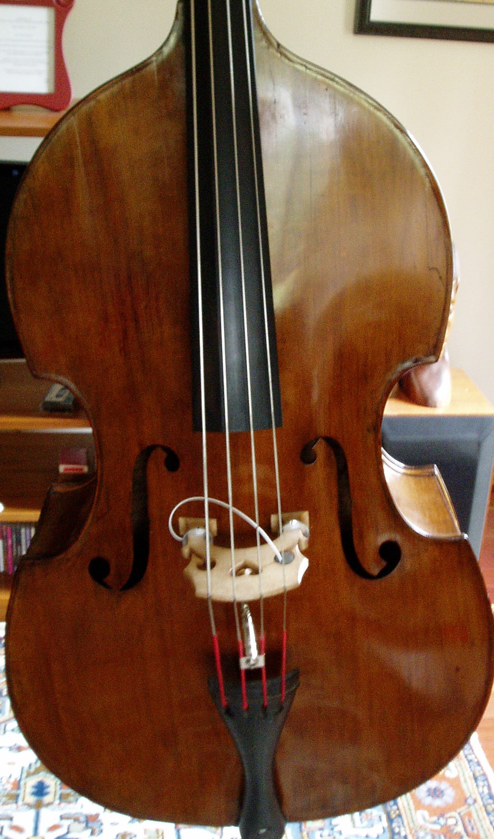

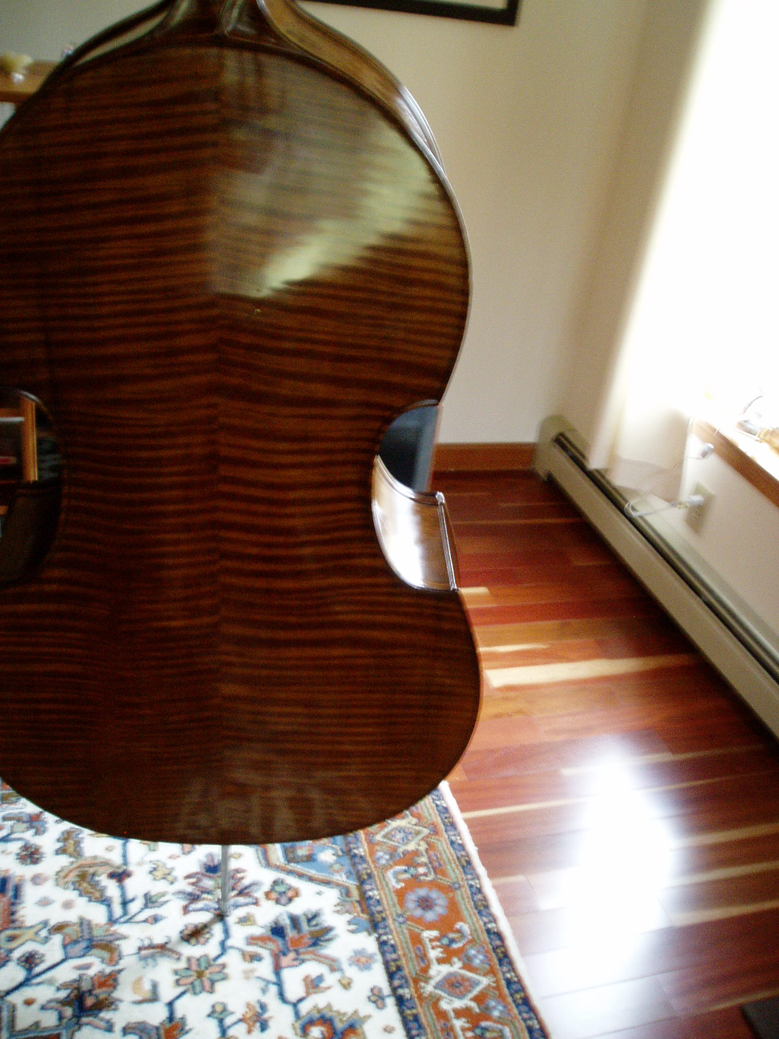

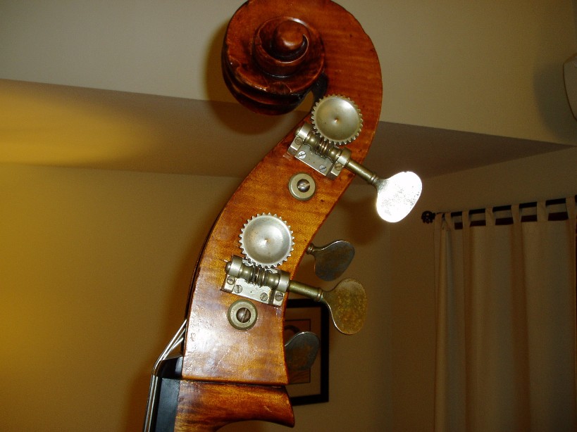

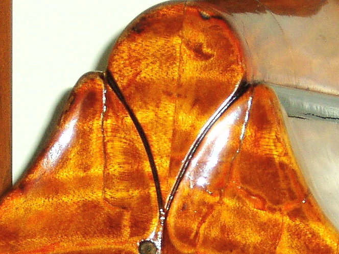

Default My bass has that carving
It visited Arnold in 2010 so it may be the one you saw there, Ken. When I picked up my bass, Arnold showed me the bass he had built for you.
Because he had not seen that carving before, Arnold thought it might have been added by a creative luthier at some point. I guess it should also match the back of the scroll in some way if it were original.
"I still think the button carving was done after the bass was built. My only reason ,though, is that I've never seen it before. The bass is German, likely late 19th century, in my opinion." Arnold
Anyway, this may or not be someone's signature but I enjoy my bass.

Cool ok..
So, after viewing all 3 basses in the same period of time I conclude that this is a specific maker or model. Made where? Germany, France, Belgium of maybe even the Netherlands. Somewhere in that region.

Default Something about the f-holes said
Markneukirchen to Arnold

Seeing pictures of your bass now, the one Arnold had awhile back, I notice it has outer linings. The other two basses do not have those linings but everything else matches up. Assuming those outer linings are original and I don't see and indication to the contrary, you can rule out the French origin.
I have never seen a single confirmed French bass with outer linings. Those linings are the most common features that disprove French origin attributes. The most common basses with outer linings are German. A few basses from England and even more rare from Italy have popped up with outer linings. Sometimes, added during a restoration. But, this bass has nothing to do with English or Italian work.
Arnold has seen the bass and I would think he looked inside as well. Markneukirchen is in Saxony, a region on the Czech/Bohemian border. Several other towns in Saxony are also famed for violin making. When I included Germany as a possible origin, Saxony was in my thoughts but not exclusively. Mainly because this bass looks too original in design to be associated with the trade instruments made in that area but seeing those linings now on this particular bass above, I will say that Germany is most likely where it was made.
Sometimes you see a single feature and then, the fog clears up and you can see clearly.

Default Maybe all three basses
have been repaired by the button carving luthier!
Old 09-10-2012, 02:20 PM
Smile lol.
I highly doubt that but I see the humor in your suggestion. lol
