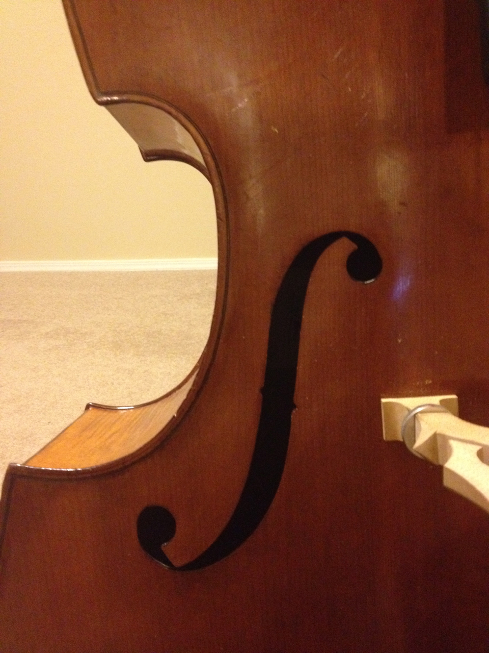

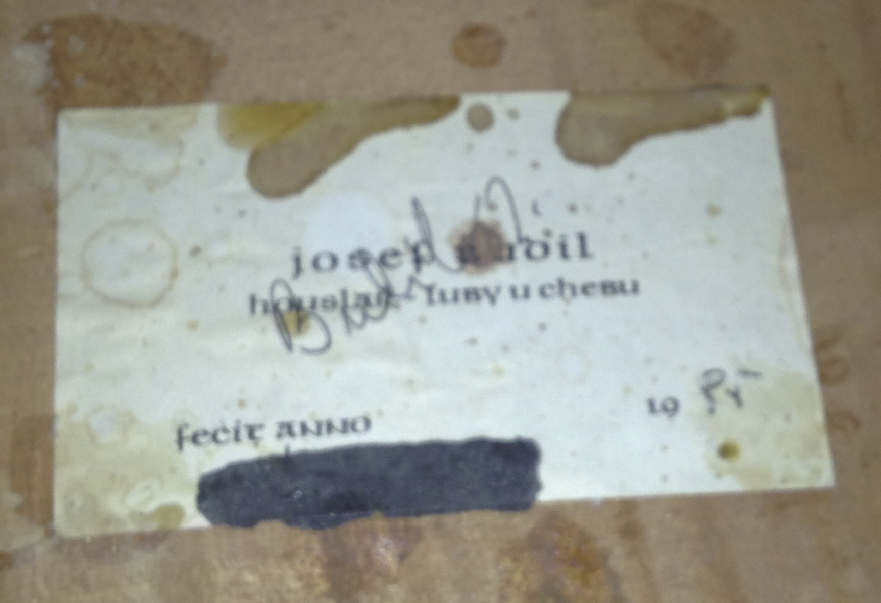

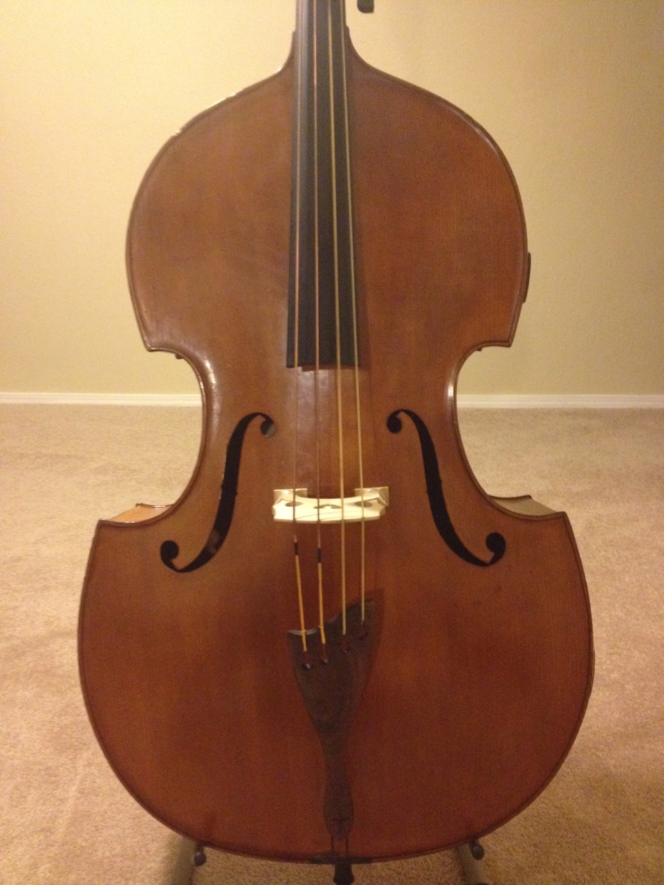

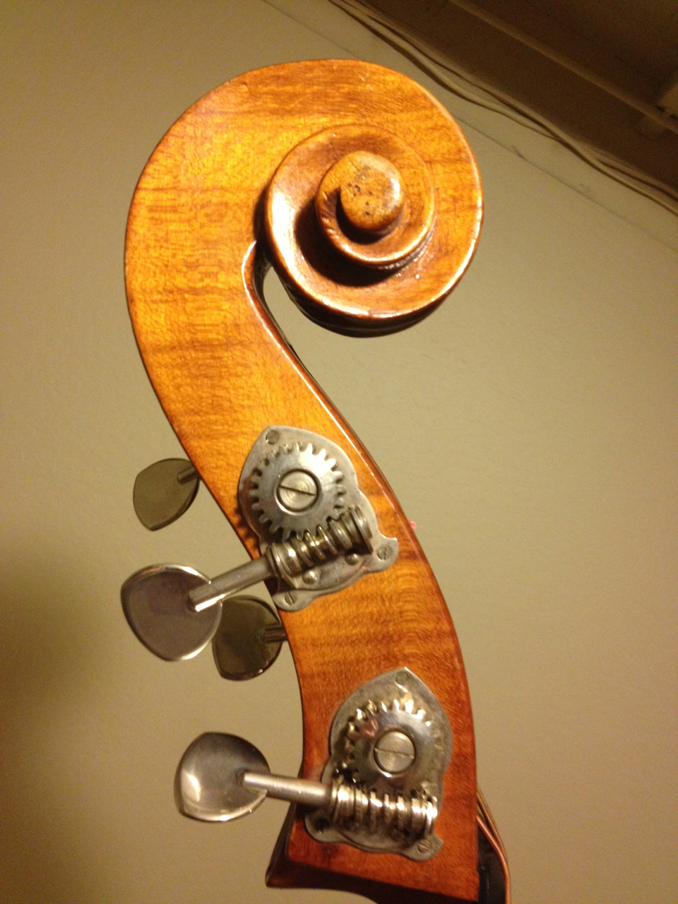

Here are some pictures.

I think I have seen this before when you posted it on TB. Interesting looking bass. If it is holding up well then you are in good shape. If the sound is not what you expect, maybe it can be opened up by a good luther, the top graduations adjusted and a new bass bar. That can do wonders for a bass. He can use a magnetic gauge before opening the bass to check the graduations.

Actually the top may have been to thin to begin with. You might notice a little caving in at the bottom of the f-hole. The bass bar had become unattached at the bottom and my luthier here in AK had to take the top off and get it re-attached properly. It seemed to give it back some of its original shape, but not quite all of it.
This was noted by Hammond Ashly when I brought it over from Amsterdam in 2003 and had them appraise it. Not to much movement in those eight years, but I figured it was time for it to get fixed so we went for it.

First off, I don't see any 'carving' around the f-holes. The Varnish looks all original. Second, IF the Bassbar came loose then, it was probably 'sprung-in'. A HUGE NO-NO for bassbars and basses. The Top will deform, cave in, split or the bar pop loose or all of the above with a sprung bar. If he reattached the same bar, then you might have a problem waiting to happen. That bass needed a NEW Bar. Not the same one glued back in. This isn't as Kay bass. I hope you were misinformed.
I have never seen nor heard of a Budil bass before this. I don't know if such a person exists or it was a trade name for this model as many instruments have fictitious names. So, I can't give you anything past what you have heard in Europe, sorry.

Not carving. Caving. And I know it is bad. In person you can see pretty clearly around the bass bar area where the roundness of the top seems to have flattened out quite a bit since it was new. I could have sworn that Hammond Ashly told me when they first looked at it in 2003 that it would need to be reattached at some point. I related that info to my luthier here in Anchorage, AK and he went ahead and did it for me.
What he described doing sounded fairly unorthodox and I can imagine it will have anyone who knows what is what holding their heads in sadness. He explained that he had carved a very small type of cross brace to fit the very end of the bar into and then glued the whole thing down. I winced a bit when he told me this and thought, well... no one else to take it to in Anchorage so I better hope that it holds for a good long time.
Josef Budil (b.1932) seems to have been a real person who worked in Luby for many decades. Studied under Hrib and Pechar and was a double bassist himself according to this scan. The owner of Lemur thinks he may have met him 20 or so years ago while bopping around Eastern Europe looking for basses.

Your bass is not properly fixed as far as the bar re-attachment goes. The strip across the bass under the bar is ok but your top has to be pressed out and then a new bar goes in. That will run on the low thousands and up depending on how depressed the top is and how long it takes to get its shape back in the process.

Posta played a Grancino very similar to your bass. Maybe this was the bass budil copied.

Aha! I hadn't caught that connection in the Budil bio, though I have seen the Posta cover and noticed the vague similarity between his Grancino and my bass. Interesting that Budil might have actually had a real Grancino to copy.
The other one of course for comparisons sake is the Grancino at the Contrabass Shoppe in the UK. Both of theses basses seem to have somewhat narrower upper bouts in proportion to the lower bouts that mine does.
