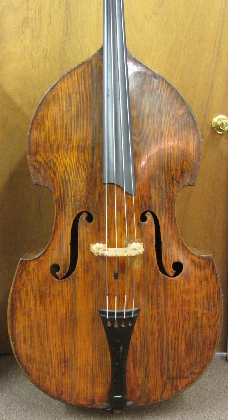

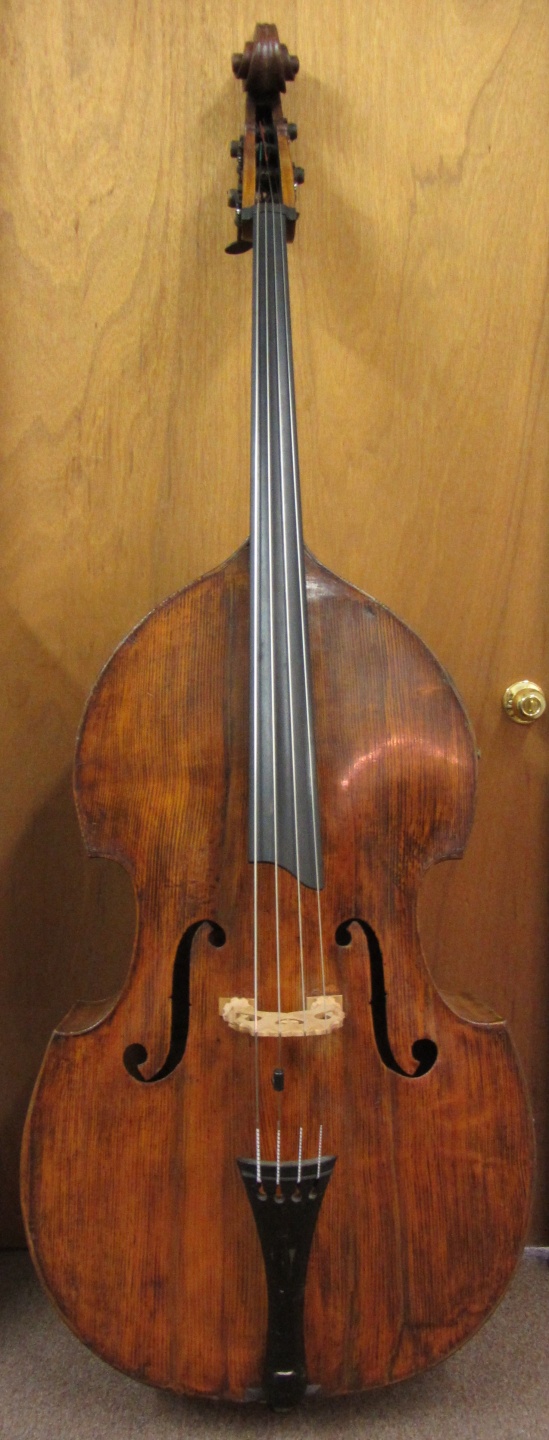

Ok, this Bass is home now and it is one sweet Bass.

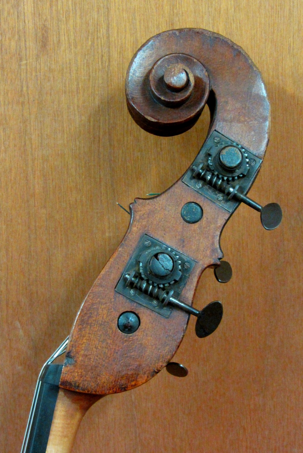

After quite a bit of research I think this is really a Prague-made Viennese 'style' bass and not a Viennese made instrument. There was one Bohemian maker that worked for a short time in Vienna as well as other border places who finally settled in Prague. I found another bass from this maker that in detail, style and measurements, could easily be its twin. That maker is Joseph Anton Laske. I would usually go with school of origin or maker but in this case finding another bass that is its twin and labelled as well, I have to say 'attributed to' for lack of having an original label inside the instrument. In an auction house with a twin to compare it to, would more likely list it as "probably or possibly by" or, "IS BY" the named maker.
The details that match are the near exact shape, F-holes, measurements, scroll, pegbox fluting from the top and then flat all down the back, the top purfled and the back not and the back angle break position to name the main features. Of the 4 other Laske basses I have seen (pictured only), 3 of them, have the exact same scroll/pegbox as this bass. Only one is of this exact size and model within a few millimeters. Being over 200 years old, time, repairs and usage has added to its slight distortion of exact measurements. From condition alone, I would say this is the oldest of the 5 basses but in style, I think it's in the middle. The near twin to this bass is dated 1788 on the label. If I had to make a wild guess, I would date this to the same or a year before, about 1787.
I have sent some emails out to people in Europe that knows these types of basses well. When I first sent that pic of me playing it, they thought it was probably not Vienna but more likely from Prague. I should get some confirmation on this soon.

I know nothing of basses this old so pardon my ignorance. Do I see repairs to the top and back at some point? Or is that just age?
Old 04-24-2013, 11:02 PM
Yes, many many repairs. This is fairly common with old basses. Depending on how they are built, how that are cared for, how they are repaired and how they travel around the world climate to climate and all combined is what determines how much 'experience' will show on an old bass like this.
Many of the trade basses made later in both France and Germany from the mid to late 19th century thru the 20th were made more robust for travel and export to the USA and around the world. The sound though on these basses will not develop usually in ones lifetime and many have had modifications to achieve a better more pleasing mature type tone.
The bass listed here within is one of those older handmade basses that were built on the lighter side by today's standards. Had it stayed in one place all its life, it might have gone thru much less trauma. Still, the sound is beautiful and the bass is holding up well despite its current looks. Only a full fresh complete restoration could make it look better. If that were to happen, it would take a few years or more for the sound to come back to where it is now.
Usually when I get in an old bass that is in fairly good repair, I only fix what is necessary and then play it. In this case, a few cracks that were previously repaired were re-glued to tighten up, the fingerboard and nut replaced, a new adjustable bridge and tailwire put on to complete the set-up. I left the endpin and the gears alone as they work just fine. If something breaks and the bass has to come apart, then I would consider a full restoration while the bass is apart.
For now, it's set-up and ready to play.
