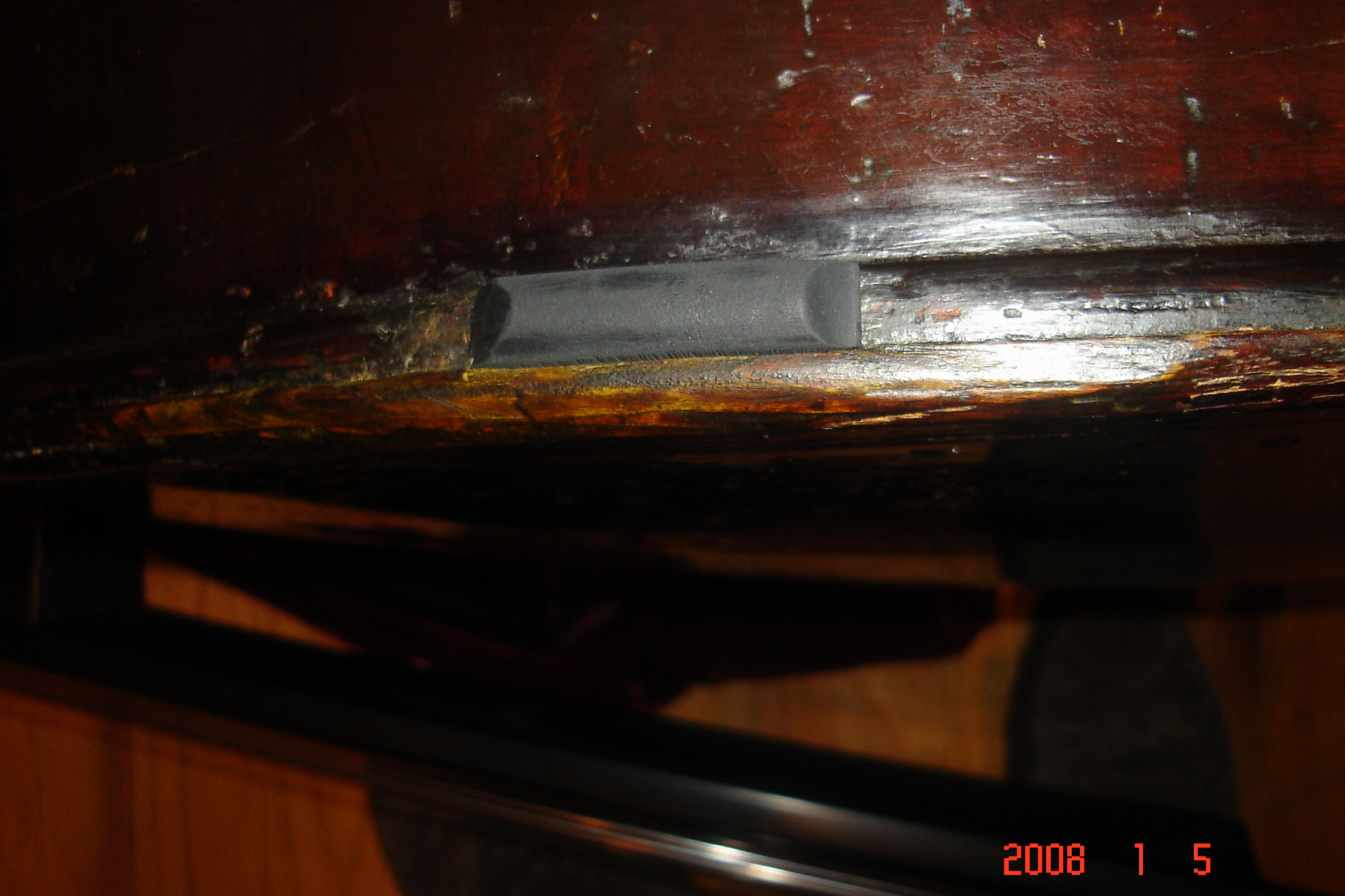

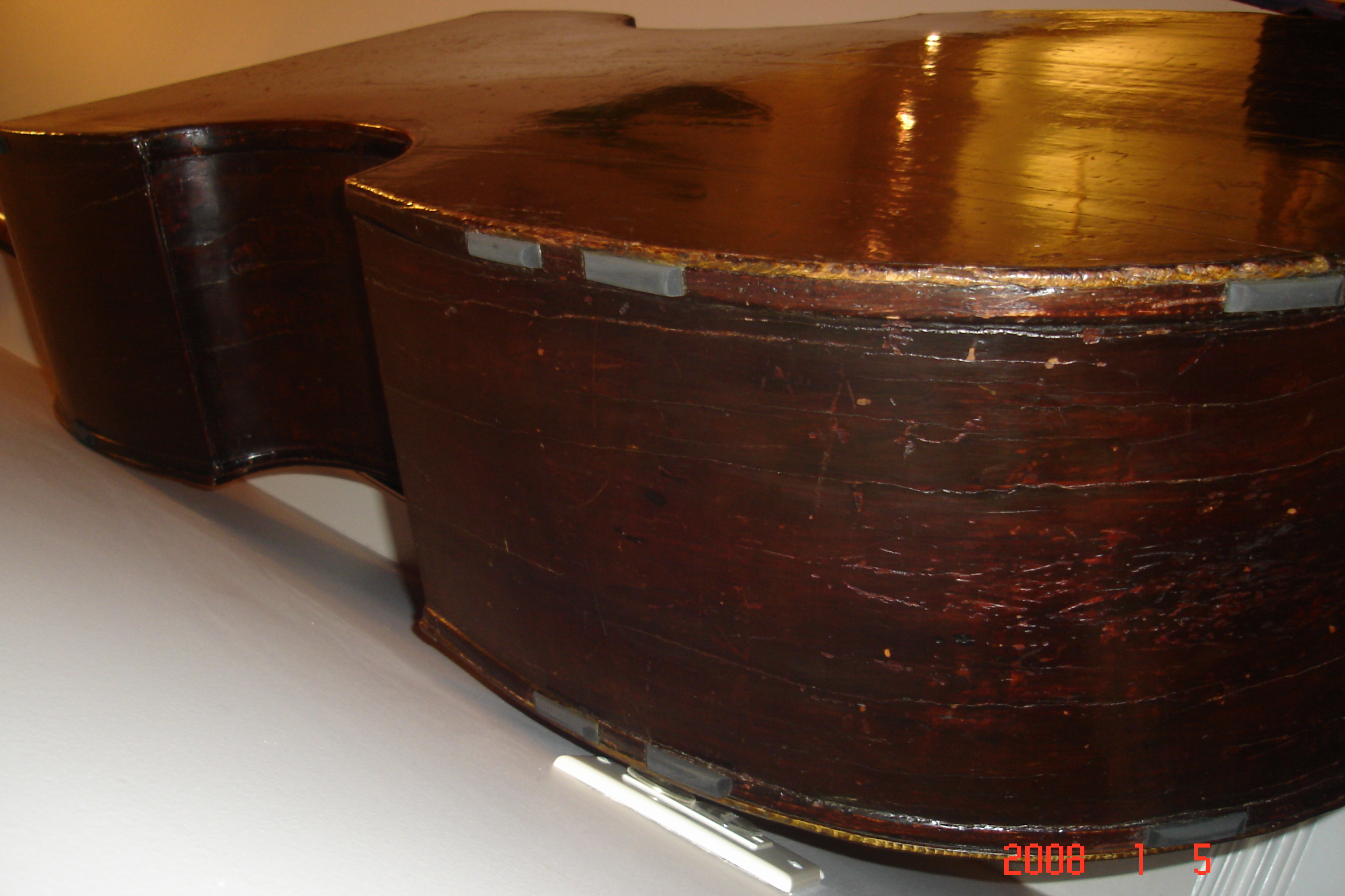

This past summer I decided to finally get my Prescott much need bumpers. The G side upper bout edge was really taking some abuse and I was carrying around an Ingles bass stand to all my gigs just to avoid further damage. From a long life of heavy repairs this bass has some amorphous and uneven rib linings. I took my Prescott to Jeff for bumpers. Eventhough I was initially repelled by the idea of gluing rubber to the bass, Jeff talked me into his fitted black neoprene bumpers instead of hard wood. He sited several advantages to the neoprene. The wood ones would be harder to fit unless I put them further away from the top and back, directly onto the ribs. This would run the risk of possible future damage from the bumpers popping thru or cracking the rib wood. Wood bumpers would have to be glued on by hide glue or some other very strong glue and would not adhere well unless the varnish underneath was sanded down to then bare wood. Short of this some kind of screw or pin would have to be used to prevent the wood bumpers from coming off, perhaps taking precious original wood off along w/ them. OTOH Neoprene bumpers could be glued on with contact cement which would not damage the finish and could easily be re installed by the player if one were to come off w/o any damage to the bass.
The neoprene looks like ebony and provides the bass w/ a bit of cushion when placed down on a hard bare surface. I'm less than 5' 7" tall and play w/ the end pin out only about 2 inches, so when I place this bass down w/ its fairly large lower bouts it rolls along that bout edge a bit. For this reason we decided to place four pairs of bumpers on the G side. One pair on the upper bout and three pair spread along the lower bout. Now I can roll the bass down along the lower bout w/ a pleasant cushiony feel knowing that my edges are being fully protected. In almost 5 months of heavy use none of them have come off yet, knock on wood . Jeff shapes them by hand very nicely so they look good as well. I'll post pix of them when I get a chance. THANKS Jeff!
Ken, I too had read those bumper TB threads in the past and had agreed w/ you about only wanting to use hard wood or maybe leather in a pinch, but I have to admit that Jeff's neoprene really has worked out well and they can always be easily removed w/o any damage. No more schlepping a bass stand (unless I'm doubling on BG on a crowded stage) or a rubber mat to gigs. You may want to consider them for the Loveri, which I saw, BTW, with the top off in Jeff's shop. A beautiful bass.

Best ones I could take. These pics are under the intense flash of my camera. In regular light they look like ebony.
BTW-Anselm, did you by any chance play in a youth symphony in Bremen under Herbert Kolovski back in 1989?

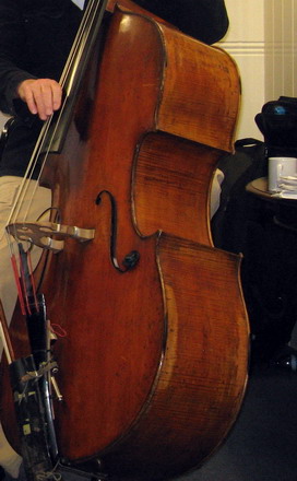

I've recently been on a weeks course with the English player, Danny Thompson.
His fine old full size French Bass, is attributed to Gand C1865 and Danny had Ebony inlaid into the the actual edges of the upper and lower bouts several years ago.
No doubt a tricky job, but it works very well. Has anyone else come across that solution?
My Hart Bass had small round Ebony bumpers on both sides of the Bass upper and lower bouts. They were inlaid thru the Rib but not thru the Lining. These were very old. The previous restoration was done in 1944 and all the Ribs were doubled inside without any lining so the Bumpers were under the Doubling but thru the Ribs.
All of this work was removed during the recent restoration and the Bumper holes filled. Ribs were re-repaired and Lining was installed inside the Bass as it should be.
