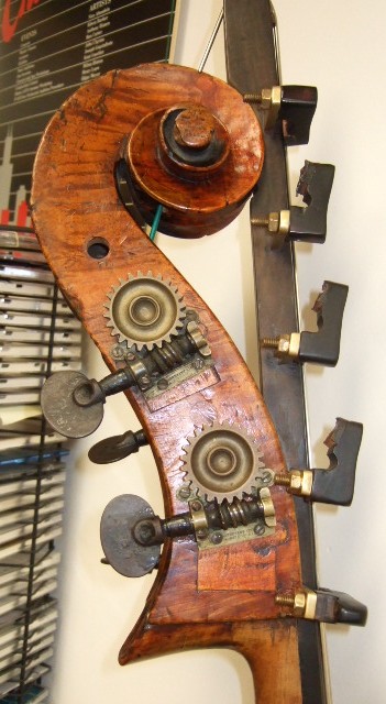

I just got my bass back from Robertsons last night. They put on a beautiful extension with snakewood capos. Unfortunately, I haven't gotten a chance to play the bass much yet, but I'm very excited about it.
Here's a picture
Old 08-01-2007, 08:32 AM
I think the Robertson extensions are elegant and beautiful. But I have two questions: 1)Why do they screw the extension on (in two places)? This makes it difficult to change strings and near-impossible to dress the fingerboard. 2)Why do they cut fancy filigree into the back of the extension? Sometimes a player needs to quickly get his thumb behind the extension to hold a long note manually, and the dips and points back there make it dangerous.
Arnold, I have almost hurt myself on the Lott I have here with the Robertson's Ext. when fingering fast notes in the Beethoven. Also, I know that E-latch will hit my Eye one of these Days as I play the Bass kind of Low. Why or how they screw it in place beats me because I don't see any visible screws on the one I have here. If I end up getting the Lott, I will have to have at least have the E-latch re-cut for eye safety and then the tension loosened on each latch so I can knock them all open in a hurry with my left hand forefinger/thumb joint when needed. When I try that now, it's like jamming my hand into a piece of Ebony as the first Latch stops and jams my knuckle.
Your Ext's work so easily as does Jeff's first chromatic he made which is on the Bisiach labeled Bass. I think re-cutting the back is not a bad idea either. It looks pretty but it's almost like having sharp ridges in the Neck between positions. I might need to carry some First-aid stuff to play with it as it is now.
I think the Robertson's is a good Extension overall but for me, I need it modified to what I have become used to and that's smoothness, ease of use and very comfortable all around.

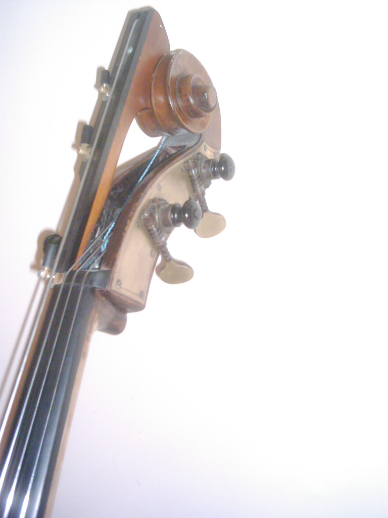

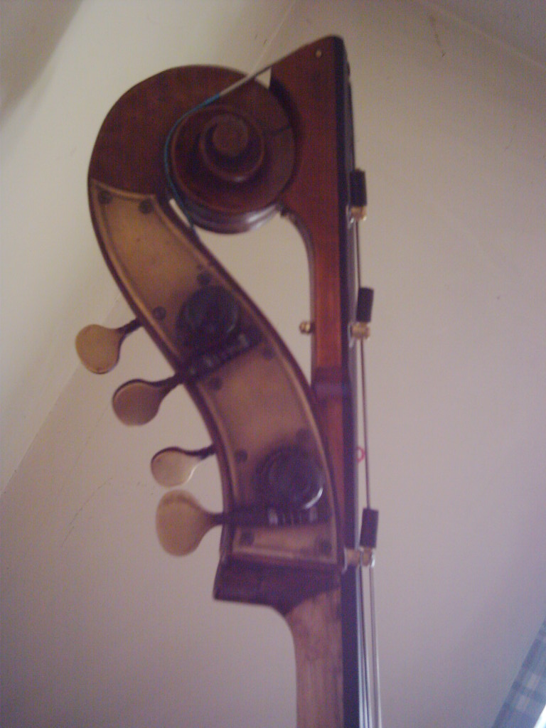

I've always liked the look of hat peg tuners....that is until I had an extension installed on my current bass!
The G tuner is positioned perfectly to stop my hand in it's tracks when reaching back for the D and Db on the extension!
I wonder what others have done in this situation? at first I thought I'd just learn to cope with it, but I can easily see myself making some sort of "modification" in a brief moment of frustration
I wonder about the history of fingered extensions....
As far as I understand it the early ones were exclusively mechanical, staring in germany around 1880 or 1890 and then sold commercially by Max Poike.
I had my extension made by Mike Hart in Suffolk, UK who has probably made more fingered extensions than anyone else over here.
He told me he made his first in 1971 after a player returned from the states where he had seen Ron Carter play. I think in those days the norm over here was the Fawcett-type mechanical, although these days they are rarely seen in the UK (with the exception of London), Fingereds being the general rule now.
Did the fingered type start as a result of removing the mechanism?
how common were fingered extensions in the US in the 60's and 70's?
Just wondering.....

Old 08-21-2008, 08:20 AM
Wink Fingered's..
Ok, in 1972 or so I was in a car accident and my Mechanical Ext. was broken along with the Neck. The Bass was restored by Peter Eibert in NY. When I went to pick it up it had a fingered Ext. with just the E-latch. Peter opted for that rather than to try and fix my Mechanical one. The Bass was way way lighter and quieter as well.
Now, on your latches which I have played on other Basses you cannot quick-flip easily with the edge of your fore-finger/palm-strike like I can with my ebony-fingers. Also, the tension cannot be adjusted as minutely either.
I see others using 2 or 3 fingers to 'lift' the closed latches to open the Ext. partly or all the way. I can run my hand back up there sideways and knock them open in a flash and then set them easily with one finger.
Speed of usage is a major factor when you have little or no time to open a gate or close one. The Robo's are a nice idea but work too slow for my taste and hurt my fingers/hand when trying to open them in a flash like I can my Ebony's.
I don't know the exact history of the fingered extension but if you ask around in the UK shops you might hear a few stories. I have the 3-set Elgar books and in either 1 or 2 he talks about extension ideas. This was written in the 60's so it was in use easily by then. Being 'in use' and being commercially available are two different things.
