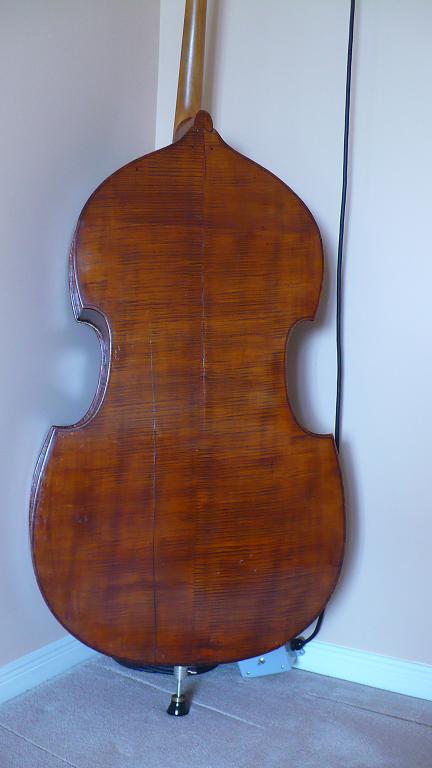

I have recently aquired this German/Tyrolean bass from a friend. The bass is one of the best sounding basses I have yet had my hands on. Notes just seem to jump out of it, with a thickness to them that I haven't experienced from many basses. It also plays like butter, making Spirocores sound dark almost out of the package. I took some time deciding on the bass due to its condition. The price was definitely favorable, but the top has quite a bit of sinkage in the lower bass bar area. It looks like the bar was replaced at some time. However, the top has been stable for the last 7 years that I have known the bass. I made the decision based on the fact that if I put the money into a full restoration later the cost would still be reasonable to me based on how wonderful the bass sounds/responds. I am not sure as to the origin/age of the bass. It does not appear that it was ever blockless, but the shape does resemble many Tyrolean instruments that I have seen. Here are some pictures that I have taken:

The back does not appear to be original to me. I have not often seen tightly flamed maple like this in a double bass. The color is slightly different than the sides(which also have a nice figure to them).
Another of the top:
Ok, do two things on the Back issues. Measure the purfling on the Top and see if it is identical. Then get a UV/black light and look over the bass in the dark and see if the opaque colors are the same on the back, ribs and scroll. You will see repairs and some purple from touch-up but check the hue between those areas. Look at the top as well. The varnish under uv looks closer on the top than under the eye.
I have seen many many basses with high tight flame from all over Germany from north to south of that country from about a century or two back. The back is a 'slip match', not a book match. This is more of a hand made instrument than a factory bass from looking at the back which shows repairs consistent with its age.

The purfling is different. Its uniform on the back about 3/32" all the way around, however the Top purfling looks hand made. Its not uniform, the ebony(or other) is thicker in some places, and the width of the purfling varies from around 1/8" to around 3/32 or 7/64ths of an inch.
Scroll pics are on their way...
Also, show some pics of the Top Purfling as well.
