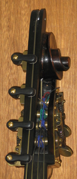

No one noticed that my odd D extension is actually made from a single fingerboard with the extension cut out.
Half size string length with added 2 notes on a 1/8th size bass. Tuned A D G C with a low G.
Bass bar and soundpost modifications were necessary.
The bass sounds great.

Posts: 309
Originally Posted by Bryan Leinwand View Post
D extension
That's... unusual, at least!
Got any more pics? What do you use the bass for?
