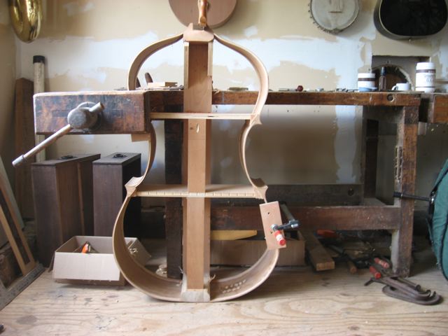

Here is the Rib structure without front and back plates. I just completed the mortise for the neck joint (notice the saw).
