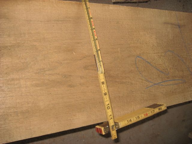

Old 05-16-2010, 06:26 AM
Join Date: 06-29-2008
Location: Pompey NY
Posts: 110
Can you show a photo of it just for yucks?
Here is a photo of the Butternut wood. This piece would be for the ribs (4/4 stock).
I wet the board with water, so the grain and color, would be more evident.

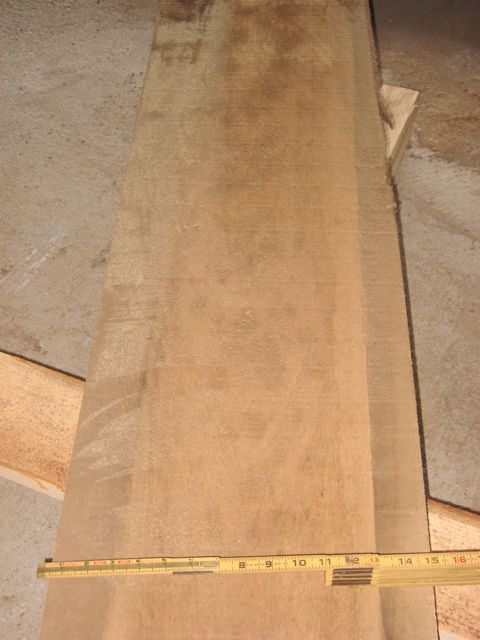

Old 05-16-2010, 06:35 AM
Location: Pompey NY
Posts: 110
I have two choices for the back. The piece below is 15" wide, and 1 5/8", or 40mm thick (rough cut). It would make a nice two piece back, but the swell might be shallow.

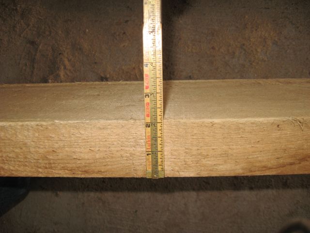

Old 05-16-2010, 06:50 AM
Location: Pompey NY
Posts: 110
The other is 2" thick, but only 12" wide. This would require some "wings" glued on the bottom bouts to make the full width. This board seams to be a little lighter, or less dense, than than the 15".
Its all beautiful lumber that was earmarked for a furniture project, but now I am thinking a bass might be more a more exciting project.
I am going to see how it bends before I make anymore decisions.
ID:	1607  Click image for larger version

Old 05-19-2010, 12:56 PM
I vote for this one. I have made several nice round-backs using 6/4 stock (1.5").
