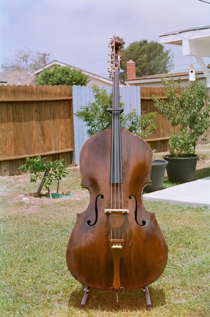

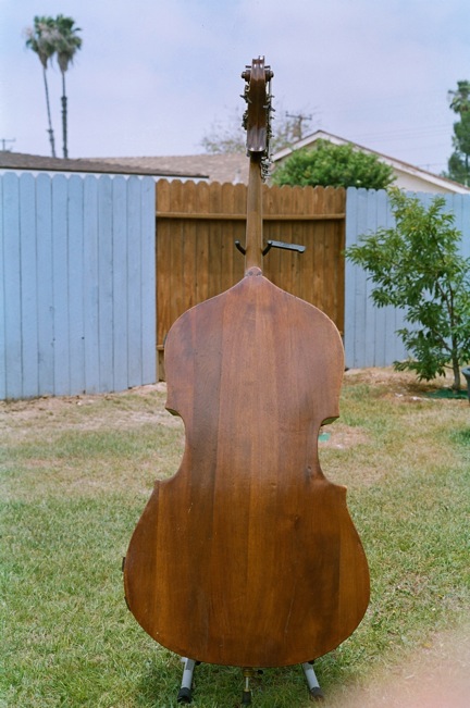

Dear Friends,
For the past two years I have been trying to identify this wonderful bass I acquired.
I hope the forum members can help me.
In my amateur efforts to identify the bass I have perused many books, and have compared my bass with many hundreds of photos, and can find nothing that seems to match. To my eyes the F-holes are unusual in shape. Note also the knots on both the front and back.
For F-hole detail see: http://img153.imageshack.us/img153/5761/fholelft.jpg
The bass originally had three strings. Three tuning gears are identical, and one is slightly different. Interestingly the tuner worm gears are located above the round gears. Therefore tuning is done in a reverse direction compared all the other tuning machines I have seen.
Here are some measurements:
Lower Bout 59cm
Center Bout 37 cm
Upper Bout 51.1cm
String Length 105cm
High-resolution photos of the bass can be viewed at the following link:
http://profile.imageshack.us/user/dmcnutt/
After you click on a thumbnail, you can click on that image and find an option to enlarge the image considerably more, showing details.
Thanks for any assistance.

Ok, your pictures are not the best but if I could see more I would like 4 angles of the head, all sized straight on and better shots of the top and back. Also, some rib shots. Pics that I can see the wood and its wear/experience.
This bass was either sanded down recently and refinished or it is not an old bass from what I can see. The bass is made on the crude side, not an old maker of any professional skills so looking thru books will not help. The Back looks new and frankly, from what I see it looks like a recently made bass made to look old. That is from the pics you show.
Recently I was shown a bass that was for sale from some shop (cannot say who) and was selling as an uncertified old Italian. I looked at the bass and asked what name maker was selling as and wrote the name on a piece of paper. I was right and I have seen that same work from a modern Hungarian guy, some antiqued and some not. It was a total fake, new bass. I have seen many of them now. Made various ways and made to look old, antiqued inside and out.
I need to see more and better pics. If I can have the bass here and check with UV light, I can see the varnish much better. It doesn't look like an old bass to me. Just an old 'style' bass.

Looking at more pics on that Link (and not so easy to work with I might add), I can't see how anyone with decent eyesight would consider this an old Bass. The Back, Ribs and Scroll are like brand new. The Top which is a softer wood is easier to antique, crack and re-glue. That label is new as well. My Simandl book from the mid 1960's shows more fade in the paper than that label dating from well over 200 years ago, perfect ink and paper. Not possible in your wildest wet dream! It looks like this bass has never had any use with a bow either other than maybe recent delicate playing.
The actual playing wear, wear and tear and life experience an old bass gets is just not shown here in any of the pictures.
I hope you didn't pay too much for this. If you want to talk about who sold you this and for how much and as what kind of bass, email me.
In the last few months alone, one player I know got a full refund arranged for an expensive Italian bass and another if he was smart, gave the faked bass back after the trial or bought it for much much less if the dealer didn't take it back to wait for another poor uninformed soul.

These were posted last night before my reply. I saw them. I made my comments after looking at all 4 pages of these pics, navigating thru each one back and forth. Where can I send my bill?
Old 05-01-2011, 03:34 PM
Cool Label..
Besides the Label being a total fake and new, the period for Dini was about 50 years earlier and the town would be in Italian, not Latin. Many fakes made in eastern Europe show up with Latinized Label writing to look possibly fancy or indisputable as the 'old' language. Makers in those time were often not the most literate people and spelling by themselves of their own names varied on occasion.
Forget about that Label being anything in name related to the bass. The only relation it has is in the attempt to defraud the buyer.
