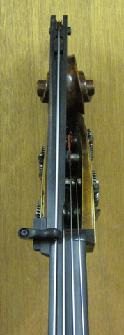

Looks great, I was thinking a two piece extension would make routing the string around the scroll easy. Glad to see someone implement it the way I imagined. Here is an extension I finished last night.
Yeah. It would certainly be much more difficult to do a multi-pulley design out of a single piece - at least with my skill level. I was able to do all of the slotting for the string path and pulleys with a table saw. I know most people consider it a crude tool, but I bet I could make a working clock with one if I had to! I chose this piece of purple heart because I knew that with a clear varnish it would exceptionally compliment the red varnish in my Geiger. It will be awhile before I can actually mount it since the bass is in the shop for another repair, but I'll post results when I can.

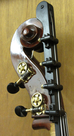

These 3 Extensions were made by Luthier Mike Magee near Pittsburgh, Pa.
These are very well made, as are the other extensions I have gotten from Arnold Schnitzer and Jeff Bollbach. These have very good mechanics but different than both Jeff's and Arnold's work which are different to each other as well. All 3 of these Luthiers now use tunable brackets with hand made ebony fingers.

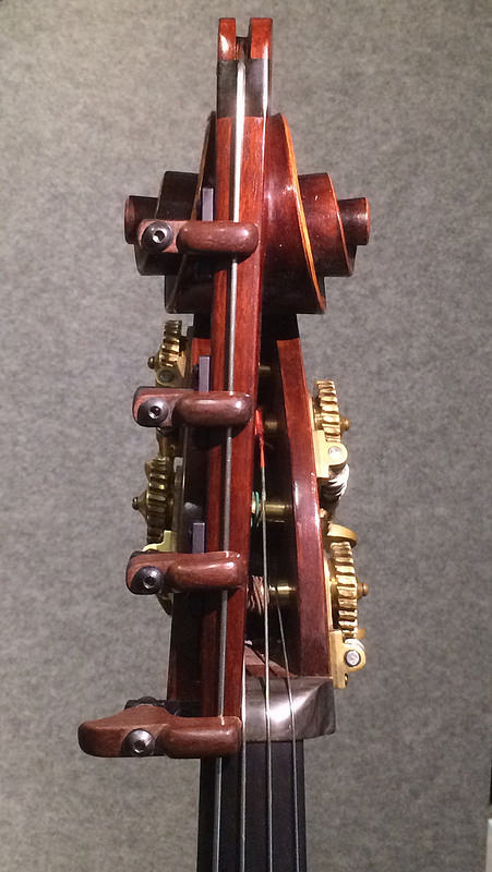

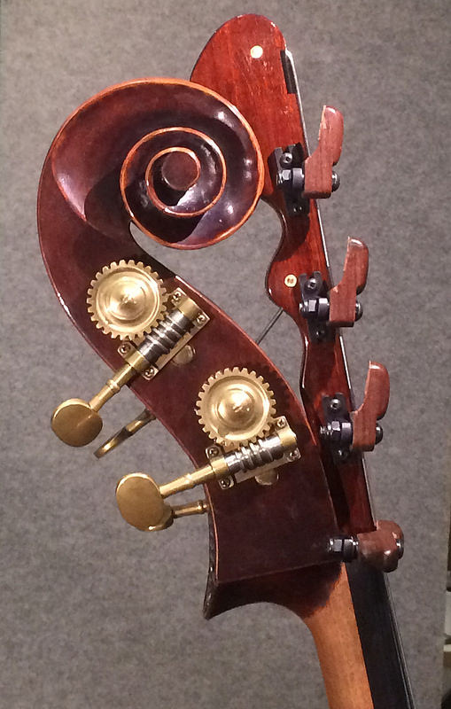

Here's an extension I made for my Lott model bass.
The stick is Jarrah, the latches are an extremely hard local desert wood called Doolalia. Harder than ebony.
I chose not to use ebony for the body or fingerboard, as I wanted the extension to look a part of the scroll, not as a chunky addition.

Wow! That is a nice design and nice work. It looks like you brought the Long E string around the top wheel for a 180 degree turn, then on a second wheel, diverted the string to the "E string" gear. That trick is new to me.
