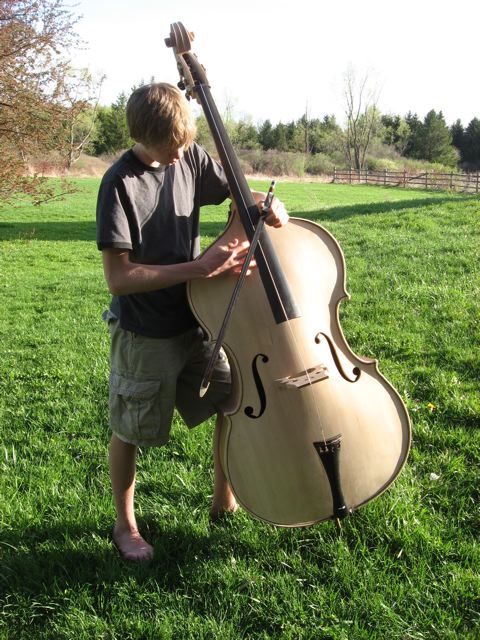

With only one string on the bass, I could not resist plucking out the first note....
Then I let my son try it with a bow.

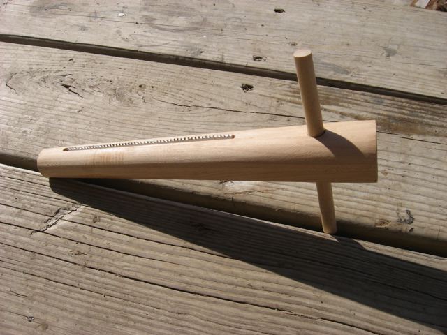

The $3.99 end pin reamer.

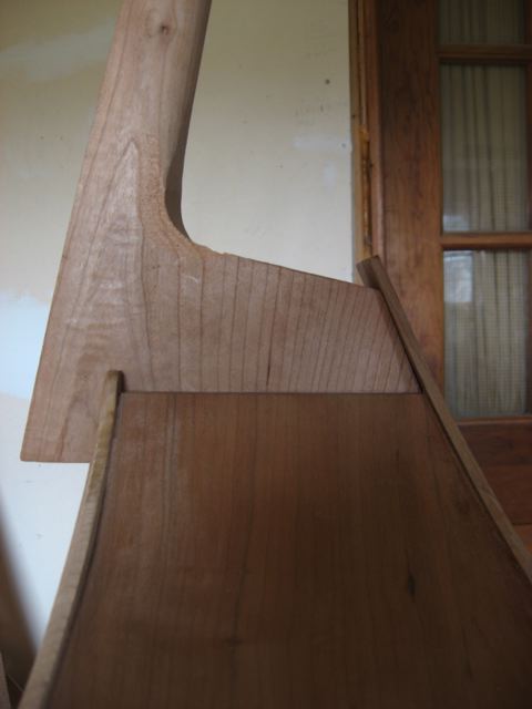

Neck fitting.

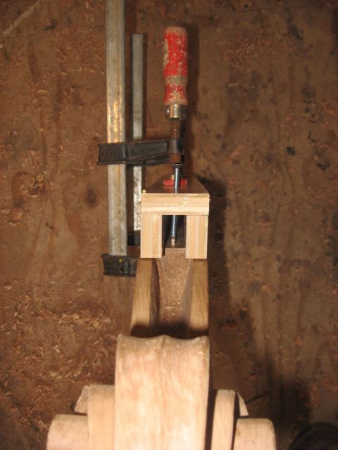

Neck gluing rig.
