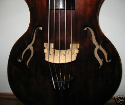

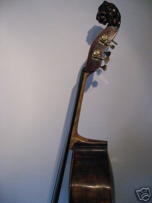

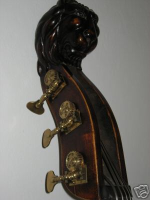

hm...well...ok...not spanish...not italian...
but cornerless, hungarian, and cheap
http://cgi.ebay.de/5-Saitiger-Kontra...QQcmdZViewItem

  #92
Old 02-28-2008, 08:13 AM
... and ugly! what's with the whacky ffs? Beurkh!
Well, Not Italian but it's the thought that counts. Figure that 'Cornerless' has been going on in Italy for about 500 years or so. Then we see it 200-300 years later coming out of Spain (that's just a guess). This just means that it's never too late for someone to start including the Hungarians.
With all the great fakes that have come out of Hungary in the last few years I am not surprised at all to see this. But those FFs.. YUCK! You are supposed to go to the Bar for a drink (or two) AFTER you finish work, not before.

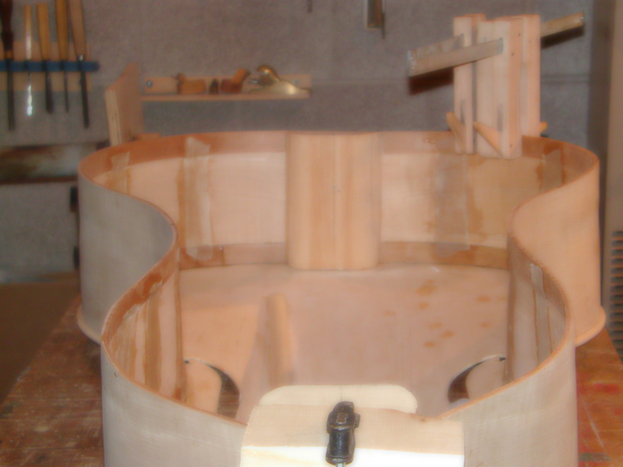

Linen linings in place on my cornerless bass.
Actually Martin, I did try some cross strips at first but took them out because I didn't like the feel. I think they made the sides too stiff. I had the ribs without mold and I could bonk them to assess their stiffness.
Just like Arnold, who advised me, I would advise you to forgo the wood and go with linen if anything.
