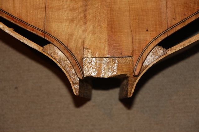

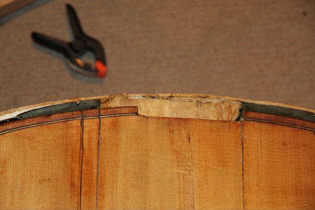

Arnold,what size do you cut your linings?
I'm redoing all the linings due to their size and wear.I removed the top today to find that the neck and end block are not totally flush with ribbing , this has caused cracks in the top . The pics should show where the cracks are in relation the the blocks ...
This in part must have had a hand in the bass not quite sounding as I envisioned it should (at least I hope so).I know that it's not always the best idea to take back and top off simultaneously but nothing was in place really besides the blocks and ribs.
In my research I have found out the bass has been opened at least twice in the last 15 years, as well as being refinished for some reason or other.Im starting to think by looking inside the bass that it suffered water damage at some time , the end block as Ken said earlier on certainly points to the possibility.

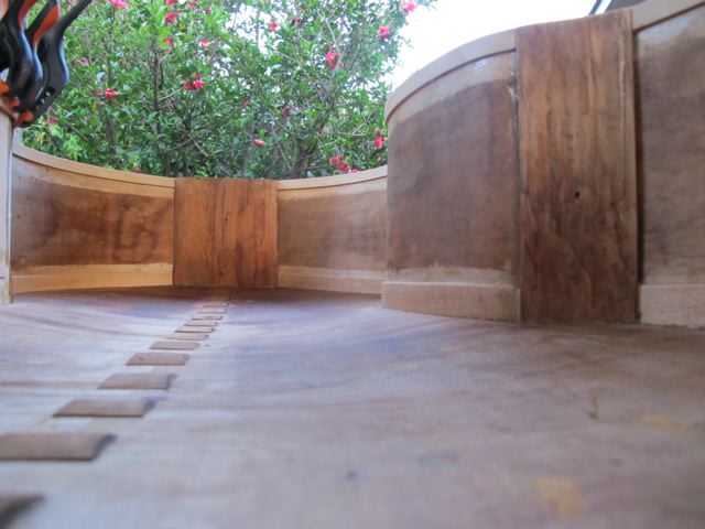

I have finished replacing all the linings on this bass now .
The back linings are 22mm wide and 2.5 thick and the top linings are really small at 10mm x 2.5 . Its my bass so I'm prepared to experiment with the small top linings.
The last linings were up to 10mm THICK on the c bouts and about 32mm wide all round.
I've read so many contrasting viewpoints on the difference that smaller linings can make ...
Im not expecting a miracle though
In the pic you can see the 'clean' wood where the old linings were.

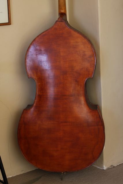

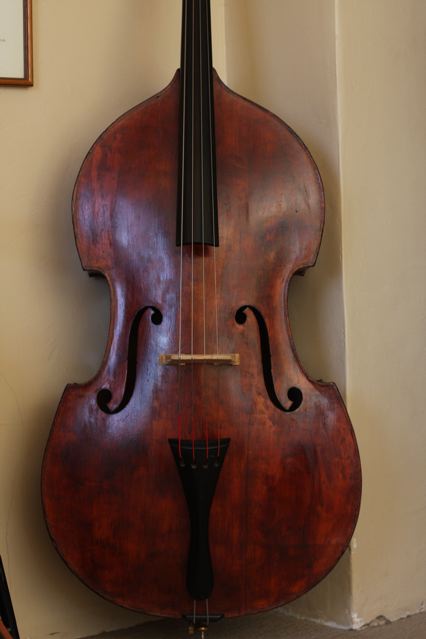

The bass is now done , and varnished. When the varnish is totally hard it'll get its final touch up and polish. Its such a pity that the instrument had its original varnish removed!
The real experiment was to replace the very large linings with smaller than conventional ones in the hope that the bass would simply sound better.
I also did thin out the bass bar and am happy to report that the alterations have made a big difference to the sound , especially the attack which is now fast . The bass has retained its original 'darkish' sound but is now more responsive and I think a little brighter sounding than before

Well done. It looks great - can you record a bit of sound for us?
I love the shot in your previous post of the linings from inside the bass. Architectural!
