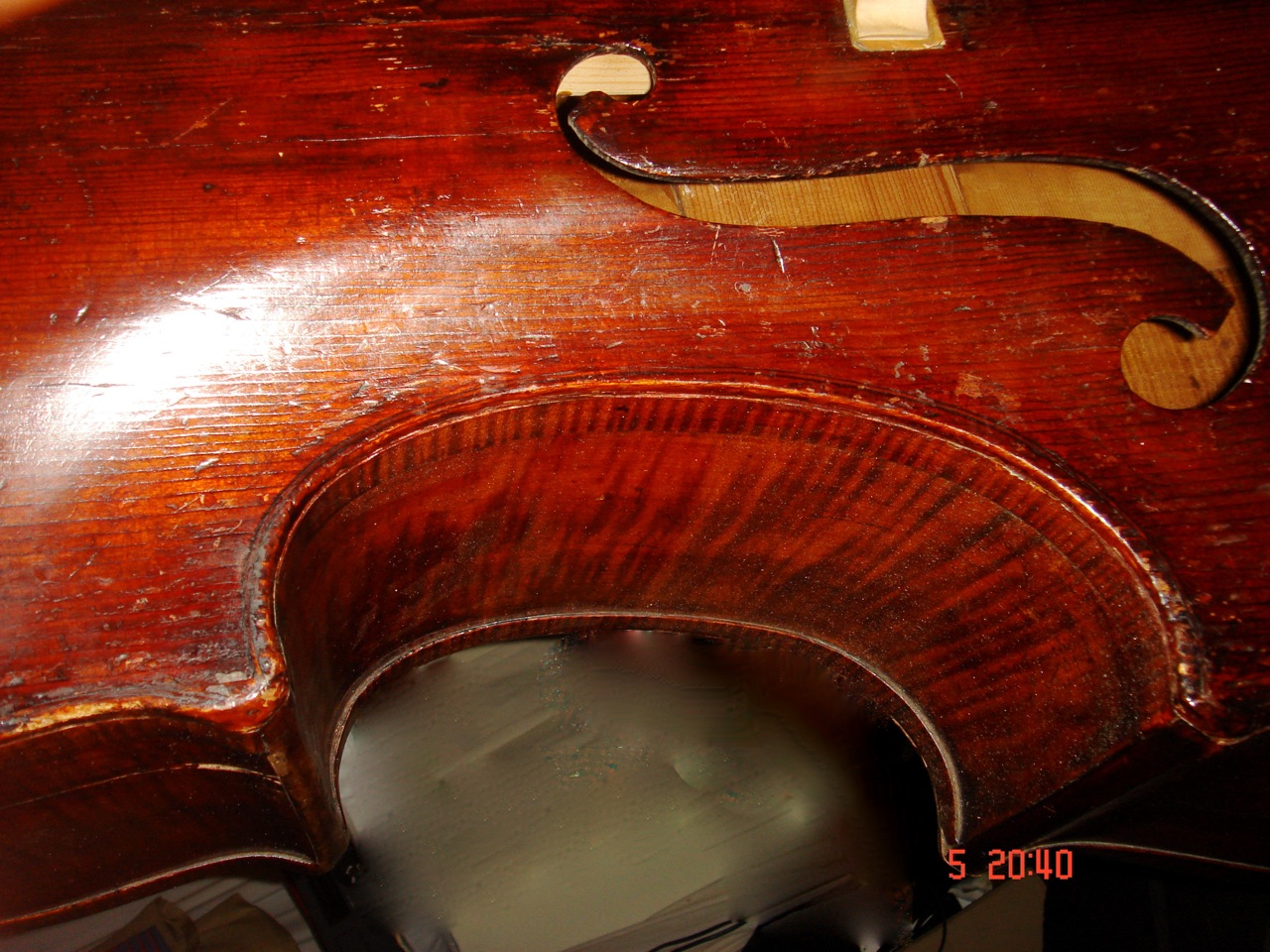

Old 02-04-2011, 01:16 PM
nice bass, chris. do you have more infos?
Old 02-04-2011, 01:24 PM
Lightbulb corners
Originally Posted by Chris Shaw View Post
The picture doesn't show it too well, but this is the sort of corner treatment that seems to appear on Forster basses - and that's probably why this one is attributed to Forster - not sure which Forster they're going for though!
The corners are usually more blunt than that. These corners look quite pointy as compared to the others I have seen.

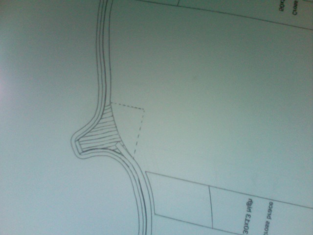

Old 02-23-2011, 04:15 AM
Now these are what I call blunt corners! Is that what Thomas had in mind? These are on my bass - attributed English
Hard to see on that pic david but I think we're talking more like this.
Here's a pic of a Dodd from Kolstein's website
This is from a plan from a Lott-attributed bass. I'm just about to start building one of this model. The ends of the bouts, as Arnold mentioned, do lend themselves to the possibility of a little decoration.
Name:	Photo on 2011-02-23 at 19.11.jpg

That's cool - thanks for posting it. Do you plan to do the ends in maple (or whatever the ribs will be) or something contrasting?
Old 02-23-2011, 06:52 AM
Affirmative

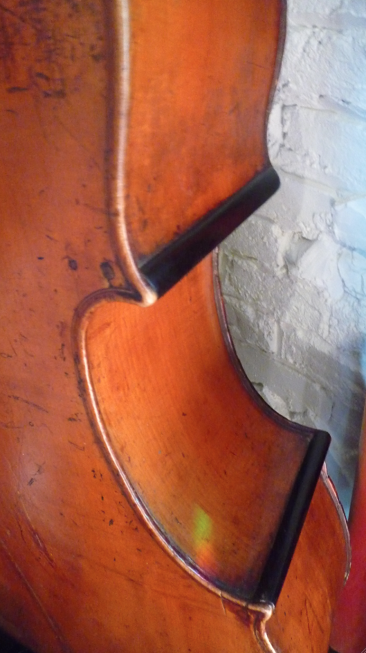

Old 08-21-2012, 06:34 AM
Join Date: 01-10-2012
Location: UK
Posts: 18
Default Ebony Corners
one of my basses has corners like this...
i'm still unsure of the maker of my bass tho... any ideas would be greatly appreciated.

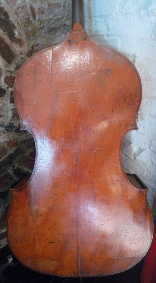

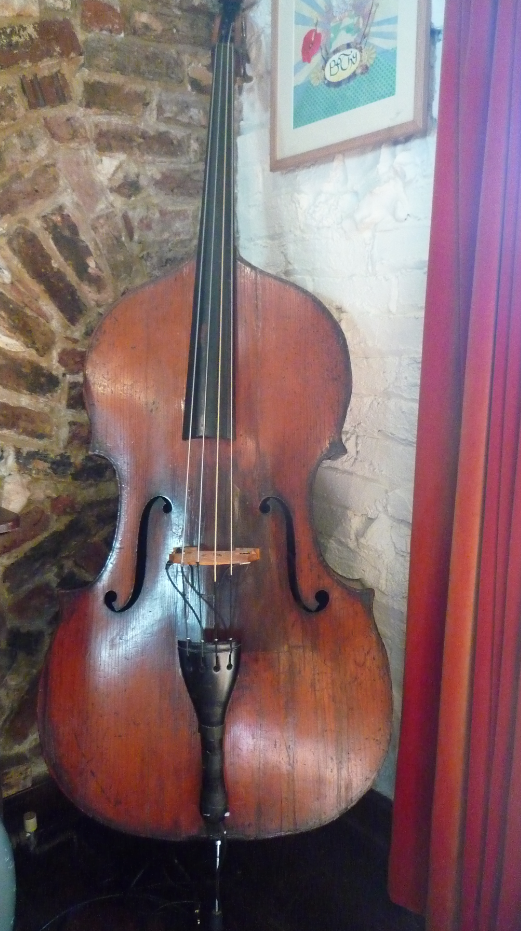

Old 08-21-2012, 07:37 AM
Those ebony 'wrap arounds'(?) look like they were added after. The Dodd and Forster basses I have seen with square corners finish flush with the plate corners, not overlapped. Also, they are rounded and not square not to mention ebony. Ebony was quite rare back then. I don't know what the fingerboards were but the tailpieces were stained black over maple or boxwood. So, ebony corners seem doubtful.
What do the shops over there think your bass is? can I see the scroll, all angles? If it's old enough, it could be from the Dodd shop or one of his out-workers.
I had one that was attributed to Dodd that looks vaguely similar to your bass. Tony Houska thinks it resembles a Craske her recently had. I think some English basses were similar back then but not uniform in size and details from bass to bass, even from the same maker. I have seen a few Fendts that varied in size and string length made on the same exact d'Salo model. You would expect them to measure up close to each other but they didn't.
Nice bass you have there regardless.

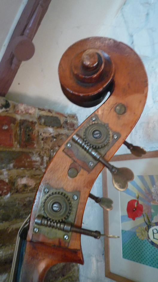

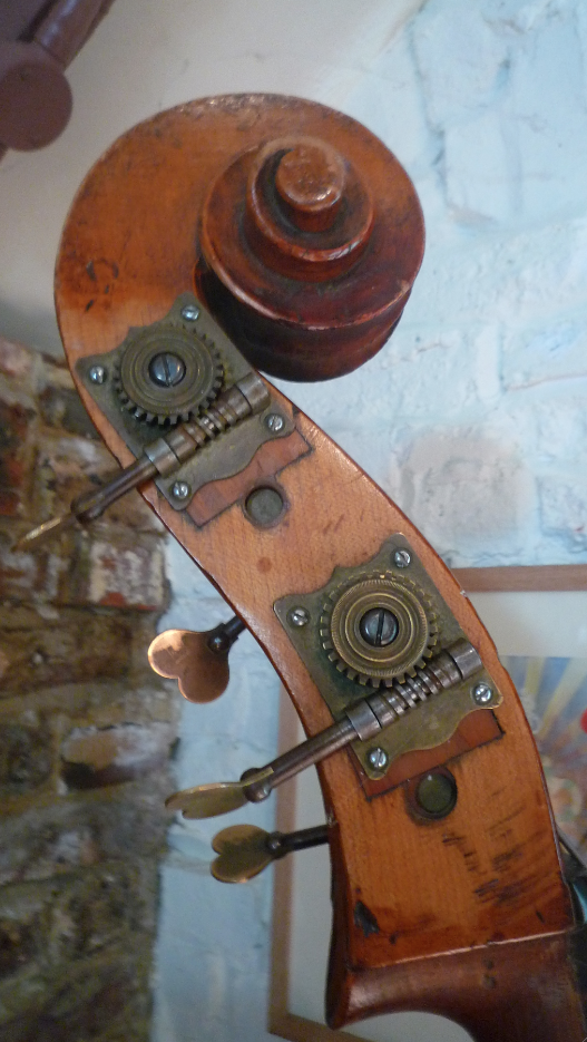

it has ugly machines.. not original. i want to get them changed. are their any you can recommend that might be vaguely like the originals it may have previously had?
the previous owner who had the bass since the 50's thought it might be a Hawkes.
Name:	Screen shot 2012-08-21 at 14.20.57.png
ID:	2493  Click image for larger version
Name:	Screen shot 2012-08-21 at 14.20.41.png
Old 08-21-2012, 01:30 PM
Thanks Ken, thats very interesting to hear.
Ok, not a Hawkes. The Flatbacks I have seen were all German made and had outside linings regardless of what shop made them for Hawkes and then sent from Germany. The C bouts are too long as well.
The Scroll is later 19th century French and not to this bass. Some Hawkes basses were French before the Panormo model made by the Jacquet family. I have never seen a French model with an angled bent back.
It looks like a French head on an English body. Go see Martyn Bailey. He might know more seeing it first hand and also has nice English Gears for your French head.. lol .. Hopefully, War will not break out between the head and the gears..

I'm with Ken on the ebony strips Jim. They look very much like later additions. I'm also with Ken on it not being a Hawkes of any type. I think I'm right in saying that all the Hawkes flat backs (the Professor models) have angled backs. The Concert and the Panormo are both swell backs. Other possible guys to try over here for information are Tom Martin, Martin Lawrence, Roger Dawson or maybe Adrian Warrick. Depends where you are?

Wow that neck looks crooked!
Old 08-23-2012, 03:45 PM
Exclamation wow..
Yes.. Perhaps the restorer put the ebony corners on to distract attention from the mis-aligned neck set.. Maybe?
