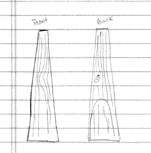

U guys left me all by my self , that's ok... Update!!! I did get some advise from one luthier, I am going to be opening the front to repair the bottom and the back opening, he explained how to…(He recomend not to open never the back because the bass will lost it shape!!!) I am waiting for my DB repair book to arrive, and he also showed me an used ebony fingerboard for $200, nice figure but it worries me a little knot in the back and a little wave in the front, I made a sketch for u guys to see it, by the way if you want to recommend somebody to buy a fingerboard from or you have one send me a PM, I am not at the point where I need one but I would like to start studying the case
Attachment 1925
You have long way to go 'til you need a fingerboard! Worry about the rest of the bass first!
