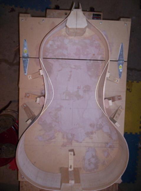

Ken (McKay)-
I played with the shape. It isn't exact, but you get the idea. I also think this would help with the bow clearance issue.
I agree with Ken (Smith) about the rib depth. My bass isn't particularly deep, but has a very deep fundamental. I think very deep basses have a lot of "spread" but not too much core. However, if you are going to 5.5" or 6" taper at the block then having her "fat on the bottom" wouldn't be such a bad idea.
Brian

First off, fat on the bottom should not mean it needs deep ribs at all. Deep ribs are often used on smaller Bass to add air space. Too much space on the bottom and it may be slow moving the air out of the Bass.
Second, if the width is too narrow, the FF's eyes at the top will be very close causing it to need a very narrow bridge. You don't want a 1/4 sized Bridge on a 3/4-7/8's Bass. That will kill the whole Idea having the Bass bar so close to the sound post with wide lower bouts.
Guitar shape or not, the upper and lower bouts should have harmony with the center curved as needed. Ask Arnold and Jeff about this. Also, take a regular Bass you know and like the sound of and convert the shape to cornerless by just shaving off the corners and maybe with some slight modifications to get the desired look artistically. Less is more when altering shapes and designs from a proven model. Also, note on that proven model how deep the Ribs actually are. The deeper the Ribs, the more room for them to flex or maybe crack. Since the Cornerless Bass can flex more than one with corners, I would only assume that slightly 'less' Rib depth would be better.

First off, fat on the bottom should not mean it needs deep ribs at all. Deep ribs are often used on smaller Bass to add air space. Too much space on the bottom and it my be slow moving the air out of the Bass.
Second, if the width is too narrow, the FF's eyes at the top will be very close causing it to need a very narrow bridge. You don't want a 1/4 sized Bridge on a 3/4-7/8's Bass. That will kill the whole Idea having the Bass bar so close to the sound post with wide lower bouts.\
Maybe my "terminology" was a little off. I meant "deep at the bottom". I would figure that if the bass is tapering off to 6" at the neck, then you would need a deeper rib depth at the bottom to add the air space that you are losing at the neck. (That is if he planned on a certain airspace that he was shooting for...)
I didn't suggest that the width be too narrow. Maybe the bottom and top would have to expand to make the shape I was suggesting. Ken McKay is the engineer on this project, so I will let him work out the details. I was just suggesting what was visually more appealing to me. I am sure Ken McKay would take into account all of those aspects as this isn't his first bass.
IMHO,
Brian

Ken (McKay)-
Brian
Brian, I get your point clearly. It does look rather harmoneous with the drawn in lines. I am playing with the plan and looking at the important points that Ken Smith brought up about the bass bar and bridge positions. I am leaning towards an ff like the Lemar bass as that is closer to my shape and it may fit better. Thanks again.

...not much for photos but there are some updates starting here http://www.upnorthstrings.com/cornerlessbasspage4.html
I did two things:
1. Narrowed the waste just a bit by removing the linings and bending the side in just a half inch above the narrowest part of the middle bout.
2. Planed the ribs for less depth by tapering them from tail block to neck. This will leave the ribs about 9 1/2 at the end block but narrowing to 8/12 at the area where the back bends in, then tapering in to 6 1/2 for better reach-around.
Oh yea and I jointed, joined and started planing the top. Nice old seasoned spruce wood.

I am accepting opinions on this question of what shape you prefer. http://www.upnorthstrings.com/cornerlessbasspage4.html
Thanks in advance, and please respond here in Ken's corner.
Brian and all,
Click on the link above and have a look at my new shape, although subtle, I think it did make a considerable difference. I think it is very close to the Testore bass which unfortunately I only have the small photo.

Brian and all,
Yes! that is definitely sweet looking. It kind of has the proportion of one of those Alexandria basses, without the corners. I think Pollmann makes them. I always liked the big difference in the upper and lower bouts. Testore would approve!

Testore or not, small upper bouts make for a smaller sound. It would be good if you came here and played and then measured my Bass. Sue Lipkins mentioned that David Wiebe was very impressed with the Riccardi Bass and soon after made a copy of it.
The bottom end of my Bass is like I have never in my life heard, never. You know some of the Basses I have played and owned and nothing has ever matched this Bass. Take a closer look at the measurements if you can. There is something to learn from this Bass.

Brian and all,
Ken,
I really like the shape. I say go ahead and make this one. Then, when you make #2, you can pattern it after KS's Bass.
I understand the need to "experiment" with the shape and have your own pattern. Go for it!
Brian

Ken, thanks for the invite to measure the Reccardi bass I may take you up on that someday. I also do want to play and hear it!
We are going to have to see how this one turns out and it will be a lesson to us all I think. Keep in mind that my lower bout is very wide at 28+ inches making the upper bout look small. It will be 18 inches, which is still smaller than the Storioni by about 2 inches, but not as much as the Lemur bass which is 15 1/2 (anyone know how that one sounds?) and the Bass attributed to Ruggeri (Sciachia's), is also 18.
The way I arch and graduate the stiffness of the top, along with the bridge height (downward pressure) is going to have a big effect. I also think that your string length (mensure) goes a long way in defining the huge sound! I have heard this from other experts.
So keep the comments coming, every morsel is gold and a learning experience for me.
