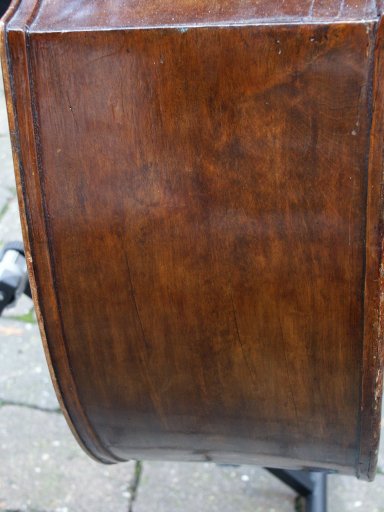

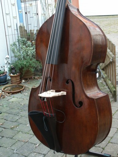

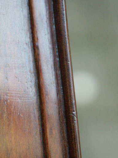

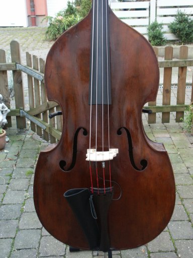

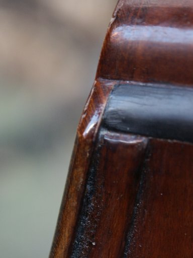

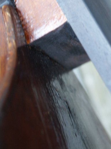

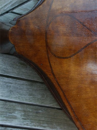

So, finally got some good daylight and some time to take pictures. The overviews now show the color correctly to my satisfaction, and I hope the close-ups are showing enough detail of the wood grain.
Below: two views showing the edge of the back plate. No signs of laminations to my inexpert eye, looks to me like wood grain all the way across the edge, so I guess this is a solid wood back.
Below left: Lower bout rib on the E side. Below center: No sign of a dovetail joint where the neck joins the top plate. Below right: Another shot of the teardrop purfling decoration.

Bohemian, c.1900. Neck has been reset, much of the button lost.
Yes - my luthier thinks the neck was completely replaced.
