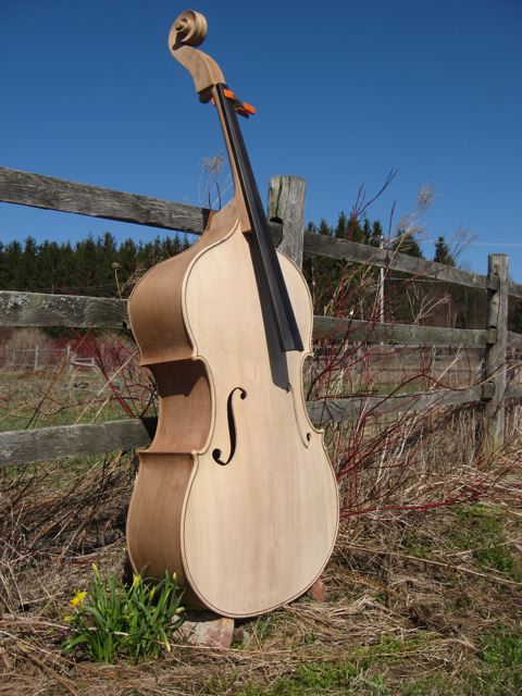

Default Hope Springs Eternal
Today is sunny and warm, and for the first time, it feels like Spring.
Here is a photo of the bass, and for the fist time, its starting to look like a bass.

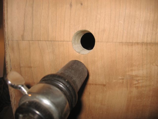

The $3.99 end pin reamer.
ID:	988  Click image for larger version
ID:	989  Click image for larger version

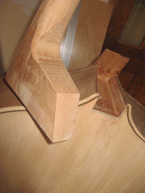

Posts: 110

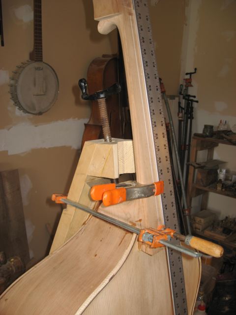

Neck fitting.
ID:	992  Click image for larger version

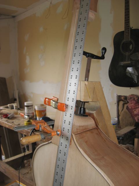

Neck gluing rig.
ID:	994  Click image for larger version

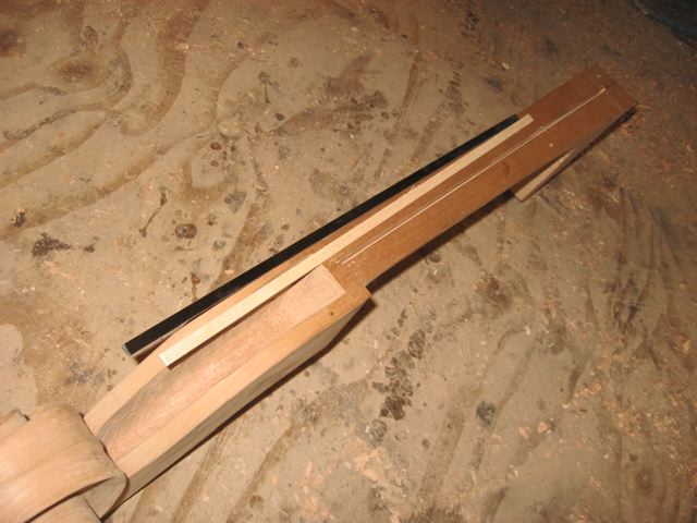

Carbon fiber implant.

ID:	999  Click image for larger version
