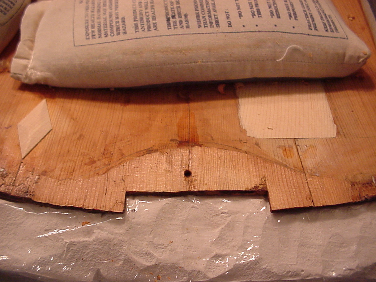

Default Some Progress, Finger Patch by the Bass Bar Bottom
In my check list of Top repairs:
Cracks -Done
Sound Post Patch -Done
Edges -Done
Finger Patch - Done
Cleats -50% -Next
Bass Bar -Next

Old 05-18-2011, 08:19 AM
Ruben, most luthiers agree that patches with straight edges that parallel the grain lines are not the best idea. There is a good deal of strength along this line, which can contribute to forming a new crack. Hope this is helpful.
I did not think about that, I have seem many repairs made this way, its does make sence that an
straight grain patch can cause problems, in this case the patch is being feather in all 4 the edges, and its also small.
I suppose next time that If I do an square patch make sure it doesnt align with the grain, or make it oval.
Arnold! Any advise on the bass bar placement ???
  #160
Old 05-19-2011, 08:34 AM
Originally Posted by Ruben E garcia View Post
Attachment 2097
Yes. It goes on the E side.
Ba-dum-bump!
Seriously, you want to first choose your bridge width. In general this is not much wider than the distance between upper f-hole eyes. Then you lay out the bass bar so it is slightly outside the center of the bridge imprint. The angle cannot be set by the violin-maker's method because basses are not standardized. I personally like the distance from the center line to the bass bar to be a bit more than half at the top what it is on the bottom.
