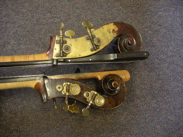

@Ken: The scroll is a new one?
Ken Smith 10-19-2011 11:25 PM
It's original..
The Scroll, Tuners (3 of 4), Plates and Varnish and everything else except the endpin, soundpost, braces, bridge, fingerboard, tailpiece saddle and strings are original. I have the original endpin, saddle, fingerboard, and bridge. The past owner kept the 3-string tailpiece.
For the scrolls, here are 3 to compare from JB Allen, the only 3 basses I know by him. The two with the unusual Gears are from 1841 (mine and David Oberg's). The one with German quarter plates (Phil Palombi's) is from 1842.
http://www.fretshop.com/webpics/dobergbass2.JPGhttp://www.smithbassforums.com/attac...9&d=1319141265http://www.philpalombi.com/images/ba...s/IMG_1265.jpg
Any Photoshopper's care to size these and post them side by side to compare better?

Arnold Schnitzer 01-06-2012 08:46 AM
Very nicely done, Ken, with one exception: There is nothing Prescott-like in that scroll. It is totally unique.
Ken Smith 01-06-2012 09:20 AM
I see some similarities but the Allen is on another level.
The small step at the bottom of the Peg Box reminds me of Prescott.
http://www.kensmithbasses.com/double...scrollleft.jpghttp://www.kensmithbasses.com/double...croll-left.jpghttp://www.smithbassforums.com/attac...9&d=1319141265
Sorry for the size differences.
Ken Smith 01-06-2012 09:35 AM
also..
As the story goes, the Prescott's with the lower rounded corners (or all of them) were copied from an old Mittenwald Klotz-scholl bass, so were the gear plates of the Allen bass as far as that loop at the top. To compare, look at the Allen beside 3 other old Mittenwalders posted here on the Forum;
http://www.kensmithbasses.com/double...roll-right.jpghttp://www.smithbassforums.com/attac...7&d=1273597622http://www.smithbassforums.com/attac...6&d=1274452623http://www.smithbassforums.com/attac...5&d=1277501886
Although not two plates on these basses are identical, they all have the rounded loop at the top.
So, mix a Prescott with a Klotz-school bass, refine it x10 (:D) and there you have it, 'Americana' by JB Allen.. ;)
