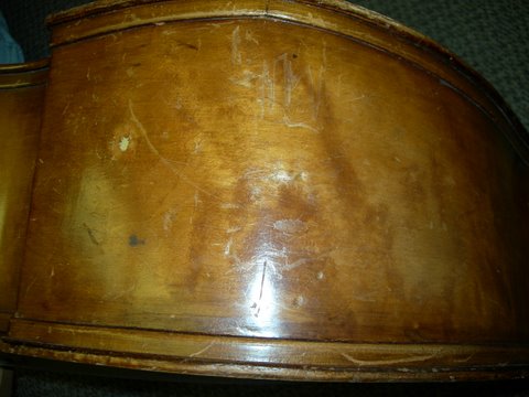

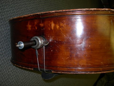

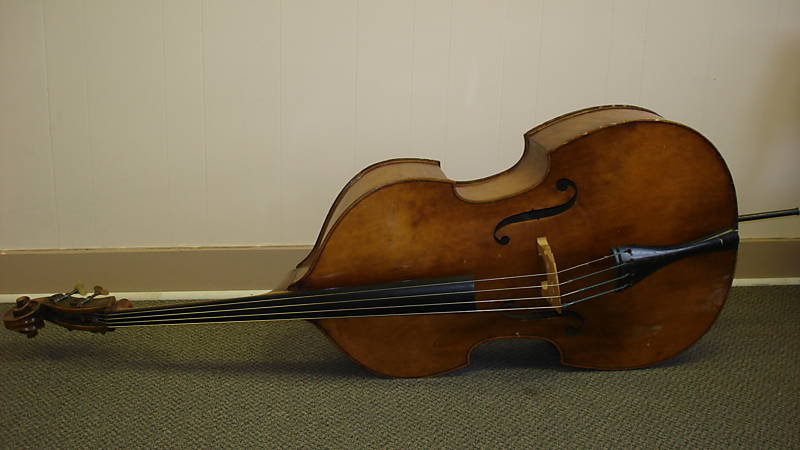

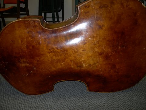

Hi there everyone;
I've been doing a lot of research on this forum and elsewhere about Juzeks because there is someone in my city selling a used Juzek half-sized bass and I'm trying to decide whether to buy it or not.
I was hoping you folks (Especially Ken Smith if he's around...) might be able to tell me a little more about this bass from the pictures (i.e., what possible year it might be, what its history might be, what one should expect to pay for it...)
I know the pictures aren't THAT great, but I did my best. Somehow over the years it ended up with a Hammond sticker on the inside that identifies it as a Juzek SB236 (alongside the normal Juzek sticker, I have a picture of it, but ran out of room to post pictures. If you need to see it, let me know!) but I don't know what this serial number might mean. S.tudent B.ass perhaps? I was able to identify it as obviously a laminate, but other than that I don't know much about it.
I went to play it today. It sounded decent, but not better than the bass I have now. But my problem is that with my level of experience I can't tell what a good luthier COULD do with the bass and whether it'd be a step up from the bass I have now which is a very nicely set up Engelhardt EC-1. My teacher is not really available to evaluate this bass for me so any thoughts you might have on its pedigree would be greatly appreciated.
Any general thought you might have on what a fair price for it would be (considering that it will have to be properly set up) would also be much appreciated.
(You should be able to see a slightly larger version of the photos if you click on them... I think...)
Thanks,
Genna.

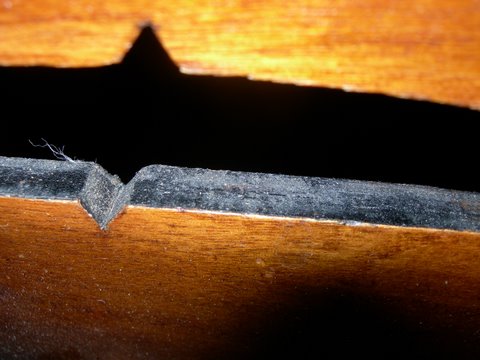

I read this over on TB yesterday and today. I can view there but I can't post or message. I read that you think it is a Laminated Bass. The pictures you posted are not clear or close-up enough to tell that. Even Laminates can have normal type graining on the outer layer. The best way is a close-up of the edges on the Top and Back, individually. The F-pic you took doesn't help because it is painted black, sorry!
On the extra label "Juzek SB236", it sounds like a store label added to the Bass. I think I remember about 4 models give or take, and that is c.1965 I am referring to. The first being a laminated Bass, the second a basic carved Bass (no hybrid then) and the last the Master Art. There were a few models in between but only a 1965 catalog would clear things up for me. That would be at MetMusic in Vermont in the possession on Bobby or Robbie Juzek (John's nephew and his son).
The Laminated Bass in 1965/6 was $150. I had worked that summer and saved up just about $200. My teacher in M.B. Florida told me NOT to get that model but to get the carved model which was $200. Well, with the cover, Bow, tax etc I just couldn't swing it. Actually, it was about another year before I could swing it because Jazz was not on my menu yet.. lol..
Ok, back on track here, jokes aside.. I bought the Laminate with a Bow, rosin, rubber stop, music stand and a tuning fork and it was about $191.xx? or so. Guess what? I STILL have the Tuning Fork.
I don't know exactly what a 1/2 Bass like this is worth now but probably it is best judged AFTER it is in tip-top playing condition. This goes for any Bass really, 1/2, 3/4, 4/4.. all of them. Buying any Bass even new, one must look at the cost of making it as playable as possible. I have even seen new Fingerboards needed for a new Bass yet alone an old one which is more often than not. For me, solid condition of the Bass, good Fingerboard, Bridge and all the fittings including strings make a saleable Bass out the door. If not, one must estimate the value of the Bass and then deduct for each item that is not up to par.
I have a recent made English Bass and as a Player, I am the first owner. The maker I believe made it as a copy of his personal old Bass but had to sell it for finance reasons. This Bass needs a fingerboard, Bridge and Strings, out of the case when I got it. The wood used for the Fingerboard is second grade and buzzing. By the time I get it working, it will be thinner than I like. Then, when it buzzes again from its 2nd grade quality, it will need more work. Might as well fix it sooner than later.
This is just one personal example I am giving. Usually, I would suggest one does what I would do because I like my Bass in the best possible condition all the time. The cost for a new Fingerboard, Bridge and Strings is in the $2k range or so PLUS, it needed a new Soundpost which Arnold did already. On a carved Bass, a poorly fit, oversized or short soundpost will not only hurt the sound, it can hurt or crack the Bass in time.
On a Bass like this, $2k is a smaller fraction of the cost/value than on a Bass like you've described. More often than not, Basses come up for sale that need more work than the Bass is worth. This is called 'negative value'. Do not settle for a Bass that is less than 'good' in the playable department. There are many choices and this factory Bass is nothing to loose sleep over. Have it checked out by an independent professional Bass Luthier that will look at the areas mentioned.
I don't know what type of playing you plan on doing or what size Bass you think would fit for it but the 3/4 size is the industry standard for the average person.

The question I have is: is a 1/2 size the right size for you. If not it's a pass.

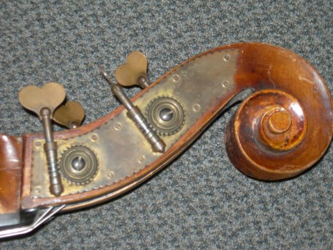

It looks like the Scroll/Pegbox was broken off at one time and repaired. I see Screw scars by the Nut area and a repaired graft mark under the pegbox in the rear by the button.
This is not a good sign because if it needs a neck graft again to fix it properly, it will exceed its value 2-3x the worth of the Bass in its current state.
I would walk away from this Bass. Even for free, it could cost way more to fix than it can ever be worth.
Don't feel bad. There are tons of Basses like this and worse that are on the market. The problem is that many people buy them without knowing what they are getting in to.
