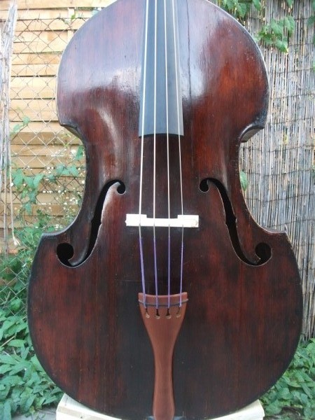

Cool more previews..
I will probably have a bit of set-up work to do as usual once this bass comes in. It's inflight from Europe and scheduled to arrive early next week. Then the fun begins!

I just packed the bass after setting it up. It usually takes me within an hour to put the post in and bridge on that were previously fit. The Post went in fine but, that bridge was up in the sky. 16mm on the E and 11mm on the G with some solid core steel strings. The E measured. .116". As thick as my Jargar E/C but that's a relatively soft feeling string. These things were so stiff, I could barely coil them as I was taking them off.
So, the bridge was a Belgium style with that tall arch and the top was cut down close to the heart. It was only 6 5/8" high in the center so I didn't have any room to cut from the top so, I drilled it for adjusters and cut out 1/2" of wood from the tall legs and set it up with some old old adjuster wheels I had lying around.
The bass needs a new bridge, endpin unit (maybe) and tailwire as well as a fingerboard dressing. The tailpiece is this creamy brown colored wood and it's quite heavy. I think it is European boxwood. It is heavier than maple and weighs an ounce more than a similar size maple TP I have on the shelf so I think I'll keep it on the bass.

The E is louder than the A. The bass has a powerful deep sound. The upper register as well as the low register is smooth and silky. Close your eyes and you will swear it's a 200 year old Italian. Someone yesterday told me the F-holes remind him of Testore but I highly doubt this bass is anything Italian.
The FFs are not evenly cut from one to another. Not the nicks, the holes, the curve, the placement or the fluting at the bottom. This is a one-off hand made original. The shoulders are not symmetrical either being that the treble shoulder is slightly more curved for playing then the other side. The C bouts are not even as well. Like my Gilkes was, the upper corners are opened up for bow clearance with the lowers being squared across.
This bass was made for comfort. It was about a 43" string length before but after restoration, it's just under 42".
