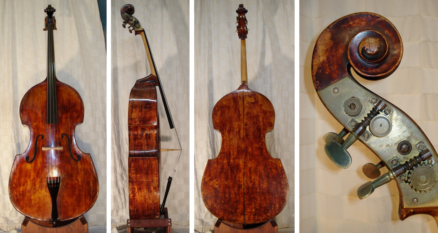

Can you explain to me what you see as similar, except that it's a shade of orange and worn in spots? I'm not being facetious; I just can't understand how anyone can see a strong similarity - inferring I suppose that it could be in fact the same varnish - from two small photos taken in different light?? Educate me.
Actually, both Basses were 'shot' in the same room. One on the floor and one against the door. The carpet is almost the same shade so the lighting was similar in each pic. Matt, it's also not just the color. It's the layering with the Gold under the Red giving that orange-red glow. Same basic idea in both Varnishes. The Top of the Hill has had many more repairs then the Back and Ribs. The 'over varnish' has darkened the original color quite a bit. Also, being a smaller Bass by comparison, it has been used quite a bit rather then being stored away due to its cumbersome size like the MB.
Also of note are the C-bouts. While one is Violin and one Gamba, they both have similar curves (long and slightly shallow), especially in lower section. The extra curve needed for the Violin corners should be overlooked and imagined as a Gamba.
Age wise, if the Hill which is confirmed is from the 1780s, then how old does the Mystery Bass look in comparison. The Back and sides on the MB are of a softer variety of Maple than used on the Hill. Perhaps it was imported wood.
The FFs though are completely different in thought. The Hill being of the Amati pattern and the MB more Strad like. See below and compare for yourself;
Varnishes and finished wood are notorious for being difficult to photograph accurately, however, the same varnish will always photograph the same way under the same light, in my experience (given the same film or in these days, the same digital camera). I have photographed quite a bit of finished wood professionally, so I have years of first hand experience. One of my clients was Signature Interior Woodworks. They were often tasked with matching a new finish to an old one. This was difficult and getting the two to look the same in a photograph was practically impossible even if the two looked similar to the eye. Vary the light source and it might get better or worse.
What is fairly determinative in this case is that many finishes that appear similar to our eye will not appear similar at all when photographed. Cameras just don't see things the same way our eyes do. The dye peak sensitivities of film or digital cameras are not at the same frequencies as those of our eyes. This means that if two things look the same to our eyes and look the same to a camera or to film, it is even more likely that the substance is the same chemical formulation. Chromatography is a process by which color absorption or reflection is used to definitively identify substances. This is an abbreviated explanation, but covers the concept.
You asked for an education!

Old 01-26-2008, 01:08 AM
So what you are saying in an abbreviated way is that because in two small digital photographs the varnish looks a similar colour to you, even though you have not seen the originals to compare or contrast (as Ken has), and even though your eyes are looking at a digital photograph (which is different to the way your eyes see it anyway) you can still see a really strong similarity in the varnish of the MB and the Hill bass, and this is equivalent to chromatography in that absorption or reflection is used to definitively identify substances, leading you to believe that it is quite likely those two varnishes are the same chemical formulation?

What I am saying is, of course, what you quoted.
I am not saying that Ken's by eye comparison and my comparison of two digital photograph (size is not important where colour is concerned) is equivalent to chromatography. It is based on the same principle though much cruder. To me the varnishes look similar.

I talked with Biase earlier today and he sees the original golden varnish under the over-varnished dark red on the Scroll. What does this mean? Well I have updated our opinion to read; "The Maple Scroll, although varnished over in dark red is most likely original to the Bass as it matches in character as well."

Ok, false alarm I guess on the American thing and probably on the French theory as well.
Recently, the main String instrument appraiser from one of the leading Auction houses dropped by Biase's shop and saw my Bass being worked on.
When this person saw the Bass he commented how beautiful it was overall and also how nice the FFs looked. He agreed with Biase that it's definitely some kind of English Bass but that's all I could get.
I asked Biase on the phone how good this guy's eye was for instruments and origins. Biase mentioned that he sees thousands of Violin family instruments from Violins thru Basses and appraises them for Auction so he knows a bit about them.
So, I guess the majority of the opinions from 'informed' people (several British Dealers/Luthiers, Biase who is working on it, a top Auction appraiser and a few others) agree that it's Olde English..

For those of you that have been following the Thread of Mystery and massive Restoration I would like to give an update as to the Porgress of this olde English Bass.
I spoke with Biase last week and the body of the Bass, Top, Back and Ribs are all glued up together and repaired internally. Now he is doing the final measurements for the Block-cut and Neck-set. This will determine the String length and playability of the Bass. He still has to do the Neck-Graft but that will come after he has a correct Block to fit it in.
Here are some pics as a reminder of how the Body looked before it was disassembled. The After Pics will be posted when all done. The outer touch-up work is the last of course so although the Body is done, the Bass itself is nowhere near being completed, just further along, much further!

I visited Biasie in NYC yesterday to inspect the progress and go over the final measurements of the Neck and String Length alterations. The Neck Graft for the Scroll is well under way and he even put some matching Varnish on the Maple Cheeks I had added. It looks like it belongs now so I was happy about that.
I looks as if we will not be doing any cutting to the Top or Back around the Block other than converting the Dovetail joint to a Mortise and deepening it. Some of the Top was cut under the Fingerboard area to accommodate the deeper Neck-set which before hand just sat on top of the Block and not in it.
The FFs are extremely wide and the old Bassbar we left in was set in a bit from the upper Eye rather than up against it. This Bass can actually take a 3/4 sized 150mm Bridge and sit mostly over the entire 'bar. If we use a 165mm Bridge like the one used before on the Bass is will sit slightly over the center of the 'bar. I would prefer the wider Bridge being that the Bass is so wide. If the 'bar was out further towards the edge of the upper F-eye, it would need something closer to a 180mm Bridge blank.
I expect to have this Bass in my hands to play and break-in over the summer. Somewhere along the way I will decide if I want a C-Extension on it. If it's a Bass I am going to use myself in the Orchestra then I will have the Ext. put on. The Graft is set so that the outer Scroll edge is even with the plane of the Neck under the Fingerboard joint which seems just right for the Extension to be fit around the Scroll.
After 4 years we now believe this Bass to be English and no longer a big Mystery with the exception of the actual maker and date. Because of this I have changed the name from 'Mystery Bass' to 'Olde English'. I have also altered the Webpage quite a bit on this as well as deleting all the question and answer stuff with the various 'blind' opinions given from around the world. This Thread as well as the original TB Thread says it all so the original information and search is not lost. Here is the link to the updated 'Olde English' page.

Matt, the Bass is all glued up now and just waiting for the Neck. I have never taken any pictures of the inside of the Top or Back. I did however take some pics of the Ribs while apart and posted them on my Website. The Neck Block was Shimmed internally so there would be room to cut a deeper mortise and save the existing Block. The Tailblock is the same as well, not replaced, touched or altered.
In this pic you can see the Tailblock which is relatively small as well as some of the Cornerblocks;
All of the Corner Blocks remain as well as the 'low' Bassbar and X-Brace that was in the Bass when I got it. Biase did however add some block wood in the X-area to beef up the center of the Back. He said the Tonetap was better afterwards than before.
The area in the Back by the Tailblock had virtually no wood left at all. He had to inlay a supportive piece inside, a piece outside flush with the Back and then cover it with a decorative bottom wood plate which I supplied from my maple stock (not shown). Most all of the internal repairs were done conventionally.
On the upper portion of the Back there was a very fine split starting at the upper Bout edge under that added Neck Button plate on the left (G side) and running thru that dark
horizontal scar and down a bit from there. The crack would not go together flush so on this he used a Violin repair technique as he explained. He sliced a sliver of wood from an area inside the Back near the crack and inlaid it outside where needed so that the wood and rays/grain would match up and not be visible after touch-up when turning the wood as the Flame moves in the light. He then inlaid another piece inside the back to fill the area used for the graft and then put a Patch over that as well. He also antiqued the new/old wood inlay thru that dark scar so it wouldn't be visible to the naked eye. It looked great when he showed it to me and I was quite impressed as well that he went the extra mile to do it the hard way which in the long run, was the best way.
All the pictures shown here were from before the Bass ever left my shop for this restoration over 4 years ago. I will post new pics when it's all done, I promise!
