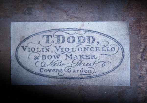

I was interested to see the English "mystery bass", because it shows some similarities to my own gamba form double bass. Mine has a Thomas Dodd label inside, which I was sure was a fake at the time I bought it, because I thought the bass was only about 100 years old. But then a luthier who did a few repairs on the bass for me, a guy with an excellent reputation around here, told me that only the neck is that "new", whereas the body is at least 200 years old based on the workmanship he could see inside, maybe even older. He also told me that the bass bar is unusually close to the center line, so it was presumably built as a three-string and converted to a four-string with a new neck about 100 years ago. He didn't want to commit himself about the authenticity of the label, but he said it didn't feel like an English bass to him, more like Bohemia/Austria - but he said that was just a gut feeling, whereas he was 100% sure about the age.
Obviously this has got me wondering whether the label could be genuine after all. Ken's "mystery bass" description mentions that gamba form basses were being made in England at that time. Does anybody know if Thomas Dodd's workshop made any? Is Thomas Dodd one of the luthiers that a label faker would target? And can I read anything into the fact that the label is located above the level of the f-hole, making it quite hard to see - wouldn't a forger put his fake label in a more prominent place?
I've attached a picture of the label, happy to take some pictures of the bass and post them if anyone's interested. Thanks in advance for any opinions!

That doesn't look like a 200 year old label to my eye. I'd be skeptical.

First off, I agree with Arnold. The Label is not that old and probably put in the Bass some time later. An Italian Bass I recently bought has a 16th century label in it but the Bass is from the late 18th or early 19ty century. The label also looks recent. After all, it's only Paper. With hundreds of years of exposure, what would you expect it to look like?
On your Gamba Bass, PLEASE post some pictures of it here. I would love to look at it. On Dodd making a Gamba Bass or rather the workers in his shop, I have heard of at least one but haven't seen it myself. B.Fendt Snr. and J.Lott Snr. were the main Bass makers for Dodd starting in 1798/9 till at least 1810.
Dodd by the way is a very Famous name and copying his label is not that hard to do as they have been pictured in books. A new trend has been happening with labels from lesser know makers than Strad or Guarnieriin hopes they might 'pass muster'. Actually, they usually don't at first and eventually never do.

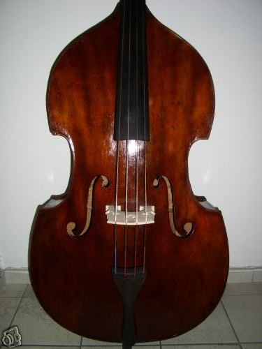

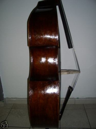

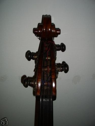

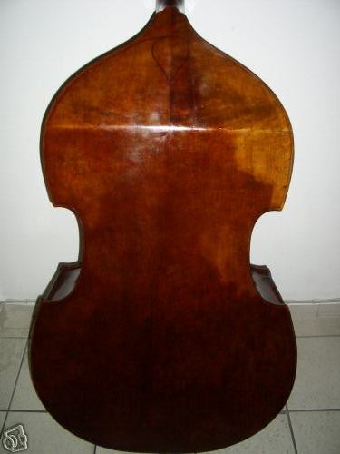

To begin with, here are the pictures taken by the guy I bought it from. What immediately struck me as similarities with your mystery bass were the dating of ca. 1800, the gamba form, the shape and low-placed location of the f-holes, the flat back and tapered upper bout. The obvious differences are that mine's a regular 3/4 size, it has the usual more pointy lower corners of the C bout, the form of the heel is different and it has purfling around the back. Another feature of mine is that the sides have about a 1" wide thickening towards the top and back, which my bass teacher told me was to have a bigger surface for glueing and was a typical trick of Saxony bass builders, but the luthier disagreed and said this feature was pretty widespread geographically.
If you guys want to see any close-ups of details, just tell me what you want to see and I'm happy to oblige. Although since my label seems to be a fake, that means I still don't know where my bass comes from, so I guess it's not going to throw any light on Ken's mystery bass after all...

Cool on your bass..
The Bass looks Bohemian/German to me about 100 years old or so +/- 25 yrs.
The Varnish looks new as I don't' see much wear/patina on the body. The Back looks lighter in color and the grain, looks like plywood.
Maybe some better pictures with better light might help.
The Varnish looks new as I don't see much wear/patina on the body. The Back looks lighter in color and the grain, looks like plywood.
Oops! Sorry Mr. Dodd - you must be turning in your grave!
Yes, those picture taken by the previous owner are pretty poor and may well be misleading. The true color of the upper back is much darker than in the close-up of the purfling, but not as dark as in the overall back picture. The lighter areas at the top right and near the right hand C bout are finish differences, no sign of wood having been replaced. They're also not as light as the picture shows.
All I know about this bass's history is what the previous owner told me: sometime in the mid 90s he (an amateur violinist) went to a double bass teacher friend to ask for classical lessons for his son, who was about 14 at the time, and he asked the same friend for help buying an instrument. The friend called back a few weeks later to say he'd found an instrument at a low price because of very poor condition, and he felt it would turn out pretty good when it was restored. The customer agreed, and the music teacher had the restoration done by a luthier friend of his in the Frankfurt region, identity unknown. The customer never knew what work was done, he trusted his music teacher friend and just gave him the cash for the purchase and restoration, and the music teacher took care of everything.
Some ten years later I bought the bass because the son had finally plucked up the courage to admit to his fearsome dad that he had no interest in music! The bass clearly hadn't been well cared for in the last 10 years: the strings were dire and poorly fitted, the bridge was much too wide and not shaped to the top at all (I could almost slide a credit card under it), the sound post was too long and installed in the wrong place, which had led to a crack opening at the f-hole. But my teacher and I agreed that even in that condition it sounded great, a beautifully dark old wood tone and wonderfully open especially on the A and D strings, and all other cracks very professionally repaired. So I bought it, on the basis that I was getting an approx. 100 year old, great sounding no-name German bass for everyday amateur jazz use, with a joke fake label inside. I paid 2400 bucks plus 350 total for the repair work, new bridge and new strings, and I still think I got a terrific bargain - and Charlie Haden said "wow" when he heard it (honest, no kidding!).
As I already said: the information from the luthier that it was a 200-year old 3-string body with a 100-year old 4-string neck grafted on made me wonder if the label could be real after all. Now that I related the story, I realize that this is highly unlikely - if the music teacher and his luthier pal had thought the label was real, they wouldn't have sold the bass to a 14-year old kid beginner.
I'll try to post some better pictures here in the next few days. Thanks to everybody for your interest!

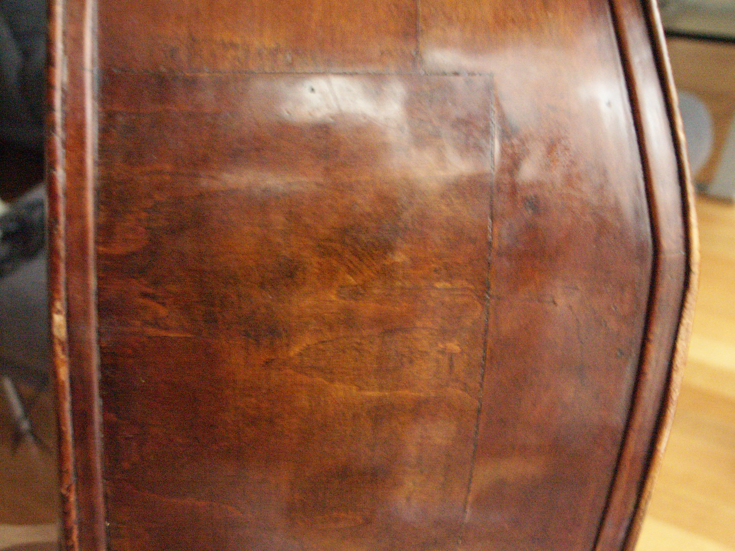

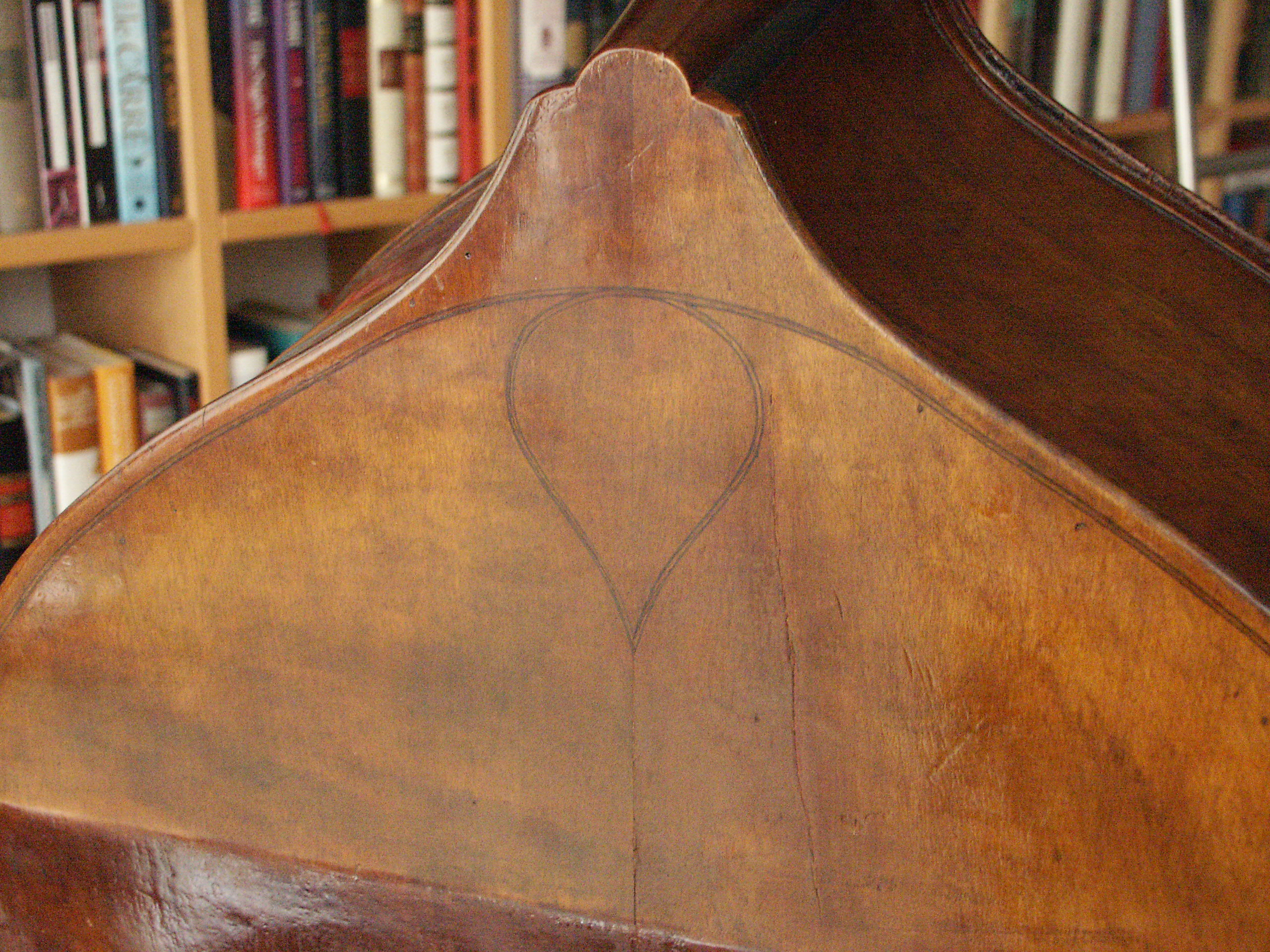

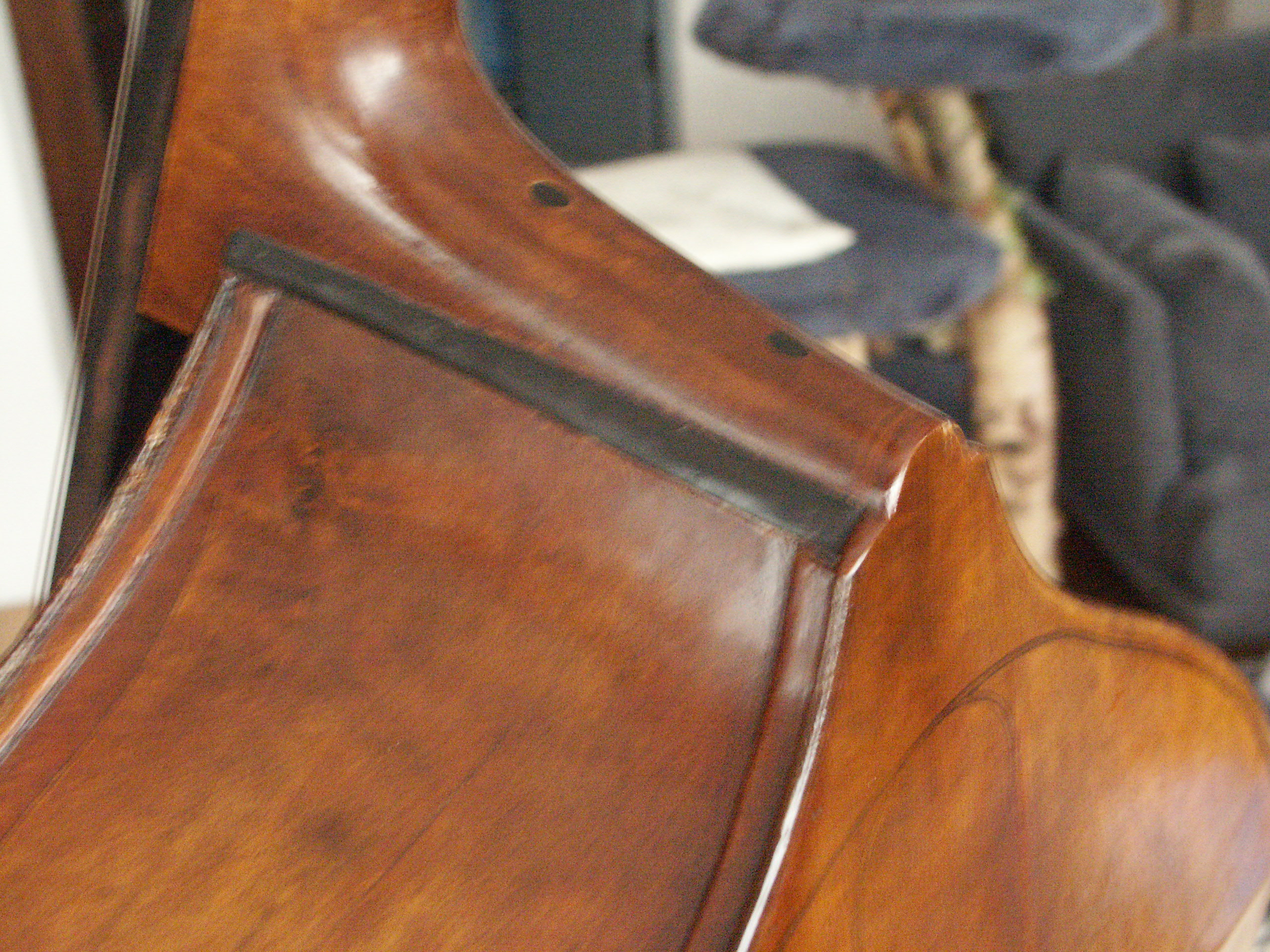

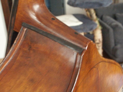

Tomorrow I'll try to take some pictures under natural daylight at our patio door, and I'll make sure the colors look right at least on my computer before posting.

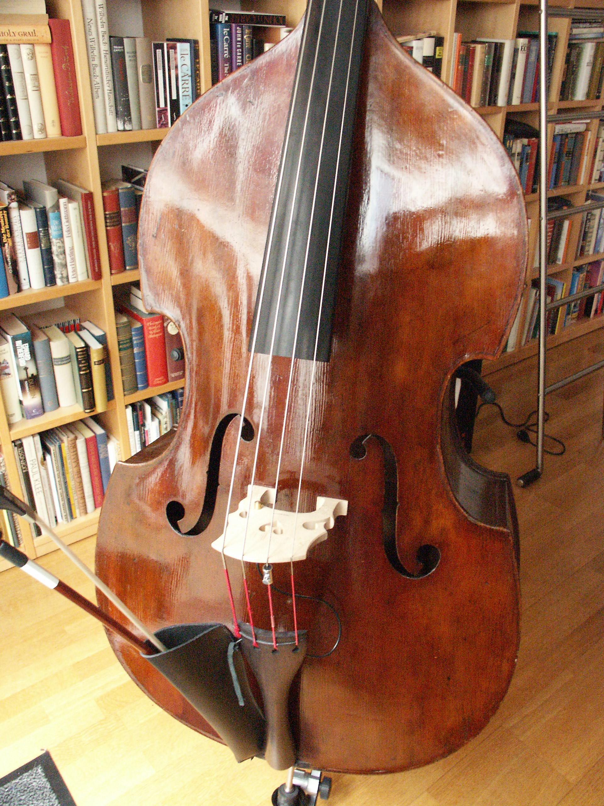

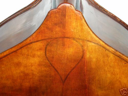

I picked the wrong day for taking pictures! I wanted an overcast day to get some diffuse daylight on the bass, but what I got was heavy rain all day and a really dark sky. I had to turn the iso on my camera all the way up which gave me grainy images, and I still had to handhold at 1/15 to 1/4 shutter speeds, a tripod just couldn't get the camera to the places I needed. I'll have to try again at the weekend and hope for better light. In the meantime, here are the four best attempts and the measurements. Thanks in advance for your opinions.
Upper Bout: 20"
Belly Length: 43"
Center Bout: 14 1/8"
Bottom Bout: 25 1/2"
Scale Length: 42 1/2"
Rib Depth: 8"
Angle break in back plate: begins 9" from top of back plate, upper rib bout tapers to 5 1/2" at the neck block
Overview of the top plate. At least you can now see it's made of wood, in contrast to the previous picture! The color looks about right on my monitor. Full size image (1920x2560) is here.
Upper back plate. The apparent sudden change in color/finish from the lower left corner isn't real, it's just the different angle of illumination above and below the angle break. Purfling seems not to be just painted, I can feel an indentation when I run my thumbnail over it. Full size image (2560 x 1920) here.
Sorry for the camera shake on this one, 1/4 sec handheld exposure... Color here is slightly lighter than in reality, the next picture catches it better. Another seeker of knowledge on the TB forum has the same ebony strips either side of the neck heel and small circular patch, see here - are these covering a peg or bolt? My luthier told me it's an approx. 100 year old neck on an even older body, but didn't say whether the neck graft was done 100 years ago or recently. I know the bass had a major restoration in the mid 1990's, maybe it was done then. Full size image (2560 x 1920) here.
Upper bout ribs on G side, showing a large patch of non-matching wood. Colors here look OK to me. My luthier told me this is a very old repair, he found the workmanship pretty good but the choice of wood eccentric to say the least. I stupidly forgot to ask him what wood was used in the patch, but my bass teacher thinks it's poplar. Full size image (2560 x 1920) here.

Cool your Bass...
First off, on the Rib measurements, were they inside the Top and Back or including them?
On the wood of your Back and Ribs, again it looks like Slab or rolled cut Maple like you find in Veneer or Plywood. Maybe even Birch but the closeups are blurry and I can't see the grain clearly. Please, look with a flashlight and magnifier glass along the edges of the Bass and Rib-to-Rib joints and tell me if you see any hint of laminations there. I just can't see it well enough in these pictures.
On the origin, looking at the angle break side view with the outer rib linings it looks Germanic/Bohemian but even more so now than before. The Varnish also looks fairly new so I would guess it was re-finished not long ago.
The wood on the Back and Ribs are very unusual for a Bass from this region. The purfled design in the lower Back is similar (but not identical) to Basses made by Pfretzschner or rather Markneukirchen shop Basses.
