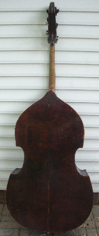

Old 07-05-2009, 07:37 PM
Join Date: 07-04-2009
Location: Rochester, NY
Posts: 34
Default Another mystery bass (Mittenwald/English)?
Hi Ken,
I played your mystery bass several times at the ISB - what an amazing sound!
I live in Rochester, NY and know Paul and Jesse at CSC. I play in the RPO and am on the faculty at the Eastman school. I too had a mystery bass at the ISB. It's a 5/4 instrument that I've always thought of as German. I showed it to a well known luthier and as I was getting it out of the case, another shop owner came by and said that he had a customer who had a very big bass JUST like mine and that it had a label by E. Withers. The first luthier then pulled from his collection a bass JUST like mine that he attributed to James Brown. Within a few minutes I went from having never seen another bass like mine to knowing of three.
When I got home, I did some homework and got in touch with the Contrabass Shoppe and sent a photo of my bass. They told my is was probably of Mittenwald origins perhaps made by Neuner, Hornsteiner, or Seitz. I did more home work and found a bassist who has a bass from 1827 by Seitz as shown in the photo. The lower portions of the C bouts are similar to those on your mystery bass Ken.
My bass has very large dimensions as listed below:
Back length 46 5/8"
upper bout – 22"
middle bout - 16"
lower bouts - 28 3/4"
Depth of lower ribs - 8 1/4"
Body Stop – 23 7/8"
String length 43"
I'll attach a few photos in my next post. I guess my question is - what kind of bass is this? I've heard both Mittenwald and English. Photos to follow...

Old 07-05-2009, 08:34 PM
Cool humm
Interesting stuff here. All of the English dealers after looking at pics of my big bass said it was English. The first time I saw the bass and examined it in my office I was getting brain flashes in my head.. German.. no, English.. no.. German.. no, English.. over and over again as I looked it over.
I too have seen some other Basses 'on-line' that have sold as English but looked a bit German as well. What are they really? Well, let's look at a few things here first..
Oh, and before I begin on the E.Withers comment, I was told by one English player at the ISB that he too has seen basses like mine. Two of them and they are labeled and or attributed to R. or W. Davis! The successor to the Davis shop was none other than Edward Withers I.
Ok, here is a list of features on these basses that could be considered German;
..a black center string running the full length of the back.
..the top purfled but the back unpurfled.
..the back bending gradually from the upper corner block to the neck block.
..the fine grain top wood and fine even flamed back wood
Features that would also be on these German basses would be;
..a full 3/4, 4/4 or 5/4 size often with lower rounded corners aka busseto.
..a scroll made to fit 4-strings as 3 was rare but sometimes used with the lower 3 only for support.
..a varnish that is usually spirit based and the wear on it 'chippy' rather than 'rub-type' fading wear.
..the inner linings led 'into' the corner blocks rather than just flush fit.
On the English Basses, here are some similar features with some differences we find on them;
..the black center back strip if present can be original or added as a later repair. If original it could have been a contracted bass 'in the white' from Mittenwald, maybe?
..The Top purfled and the back not purfled BUT black lines painted in its place (visual on my bass).
..the bend up at the neck area quite steep and not gradual as mine has but does start at the corner block and bends drastically the last 1/3rd of the way.
..wood grade can be domestic or imported as England did trade with Germany so species of wood is no guarantee of origin of bass (in my opinion).
.. a full 3/4, 4/4 or even 5/4 in size. Tops ranging from 44" to 46" to 48".
.. a shorter scroll made to fit only 3-strings with no vision or extra space to fit 4 tuners. The reason why the 4 tuners on many old English Basses are so close together.
.. a varnish that seems stronger than others of the same era that is often oil based but after 2 centuries of repairs we see a lot of spirit added over it often showing the layers.
..inner linings are up to the block and not inlet into the corners with the exception of some English basses where the linings are let in only within the c-bout on the inside of the block and not from outer edge to the bouts.
I know this is a lot of reading but work is work. Did I mention cross bars on the back? The Germans would typically have 4. One center, one lower and two upper. This Bass of mine had twin lower bars but thin like a cello bass bar at maybe 1/2" wide an inch apart like an old Gamba might have. A center and one upper look original on the scars as well but the secondary scars look to maybe have 4 bars. Currently it has a 3-pc X-brace that looks over 100 years old.
My Scroll was a 3-string and the TP was as well but doesn't look to be the original TP. Maybe was put on when the X-brace was. My Bassbar is thin, shallow and short. Looks to be made to support only 3 gut strings. The Top however is strong with no sinkage ever in its past, a healthy arch and some extremely fine grain spruce as well. It currently has a 170mm wide bridge as the Bar is inset a bit. The upper inner F-Eye measurement is about 190mm. This is a BIG bass.
Jeff, did we personally meet at the Show? Did I see your Bass? I don't recall either.
Anyway, on this mystery hunt one theory may be that some of the English Basses that look German may be a bit of both. Made in Mittenwald and finished in England or made in England and repaired or modified in Germany.
My Big bass has been cut and not just up at the Block like recently done. It looks like the outer bouts were cut-trimmed in a bit and maybe even shortened a bit at the lower block around the Bouts as well. The Re-curve is gone in all of these areas and only in the upper bout near the block and the Corners somewhat.
The outline that we see now on it was actually more squat looking and less roundish at the upper and lower bouts as the purfling is not there on these suspected cut areas of the bouts but is there at the bottom and corners but not so complete. The original edges may have been re-used in areas as well. The upper portion of the bass near the neck looks original for the most part. This Bass had been worked on by many people in the past. I would say that the last was about 80-100 years ago or so when converted to 4-string not including the most recent restoration. This Bass even had a C-extension at one time as well but was out of repair for most on the 20th century.

Old 07-05-2009, 09:07 PM
Cool humm
Well Jeff, aside from both basses you show being Gamba shaped I don't see much in common between them.
Better pics of both might help but I need to see Ribs, scrolls and Neck/block area as well.

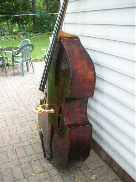

Old 07-05-2009, 10:23 PM
Posts: 34
Am having trouble loading photos. Here's one of the side of the bass.
I'm not suggesting that our two basses are the same... I just got
very curious about your mystery bass and the idea of the large Mittenwald basses. More to come when I can figure out the picture problem.
Name:	Side View Side View.JPG

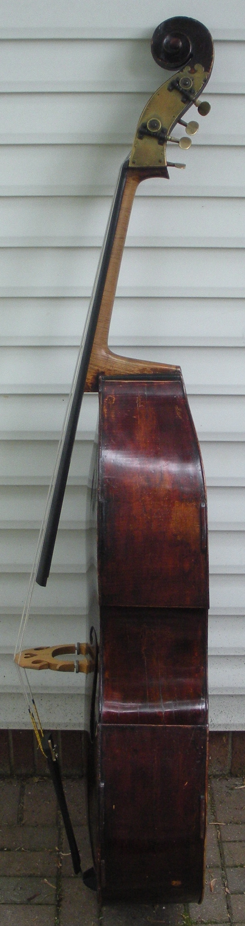

Old 07-05-2009, 10:40 PM
Posts: 34
Here's another photo of the ribs, neck joint. Yes we met at the convention but did not speak for long. You were swamped. I did not show you my bass, though I wish I would have. It has a huge, deep organ like sound. Very satisfying to play. I think this is a Mittenwald bass - never thought it anything else until I met the two other people at the convention who said their basses like mine were English.
Name:	Big Bass Quarter right.JPG
Old 07-05-2009, 10:42 PM
Cool well..
What I meant was that the two you posted are different. That's all. The first one does look like a Seitz I saw a few years ago on a German website.
The Gears on your bass are nearly identical to the ones put on mine after it was converted to a 4-string. I shipped them to NY and trying to get them back now just to have. The plates on your I have seen pictured before on a few German Basses. One had the same exact gears as well.
Old 07-05-2009, 11:07 PM
Thumbs up nice bass..
I don't know what it is but most of the older English Gamba shaped Basses I have seen had broader shoulders and not sloped like your. I don't see a Seitz connection but maybe one of the Neuner's if it's Mittenwald. Are the Shoulders original or have they been cut?
I would have loved to see and play this Bass. Most big basses have less than friendly shoulders to match. Your Bass looks like it's easy to get up into thumb position without much stretch.

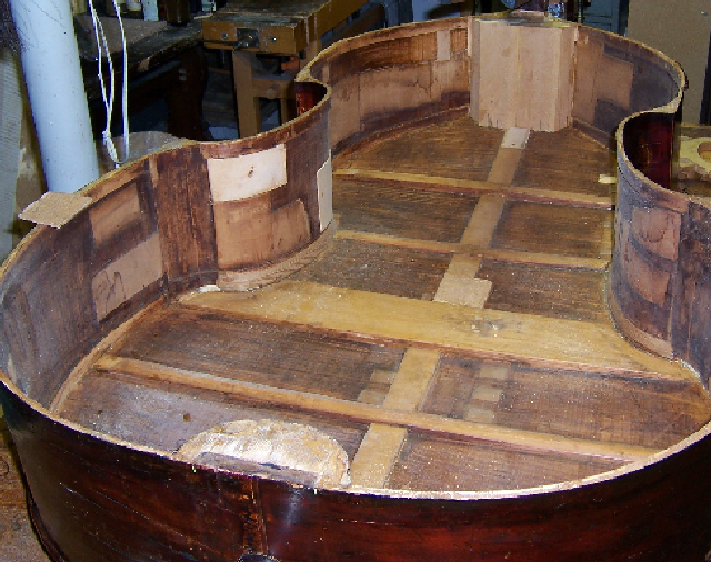

Old 07-06-2009, 01:26 PM
Posts: 34
The funny thing is that the person whose bass is labled Withers says his bass is larger than mine so I assume if made by the same person that mine was cut down. The front is perfled the back is not. There is a hint of a black line down the center of the back but it almost looks painted on and it doesn't run all the way down. There was some pretty major damage to the back of the neck joint at some point. I'll post a few more pics of this and the inside of the bass.
Name:	Big Bass 9 Top (inside).jpg

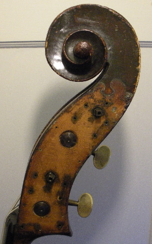

Old 07-06-2009, 10:26 PM
Posts: 34
Sorry for the multiple posts. These all show the details of the constructive elements of the bass. It's clear from the photo of the scroll that this bass has always been a four stringer. The bass has five braces, one large one in the middle and two in the upper and two in the lower. Also, you can see the black strip down the back is faint.
Name:	Big Bass neck joint.JPG
ID:	1132  Click image for larger version
Name:	Big Bass 3 Top Off.jpg
ID:	1133  Click image for larger version
Name:	Big Bass Scroll no plate II.JPG
