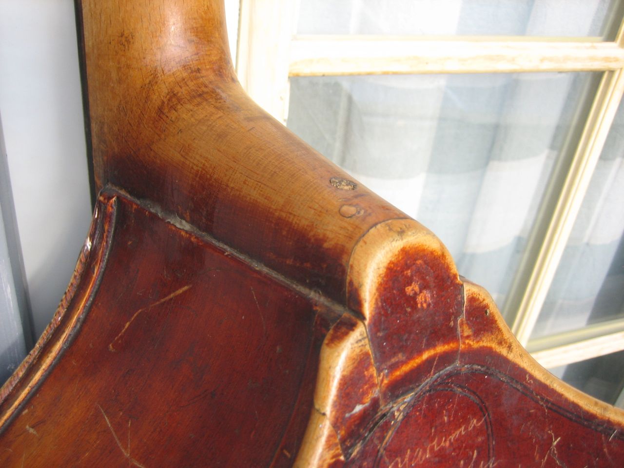

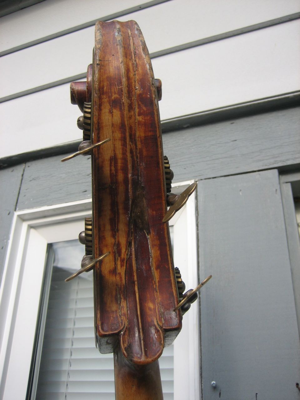

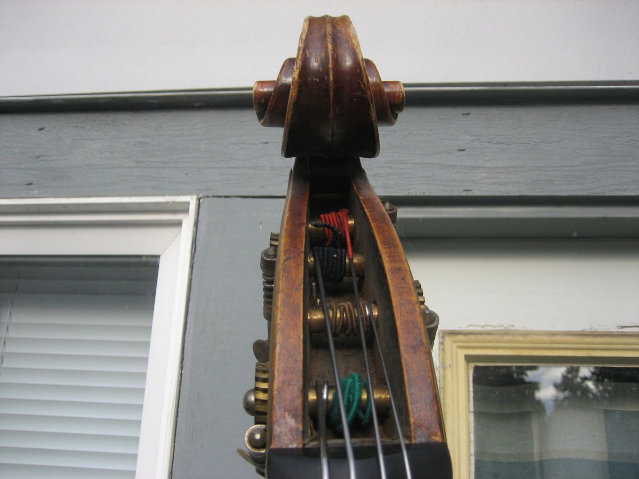

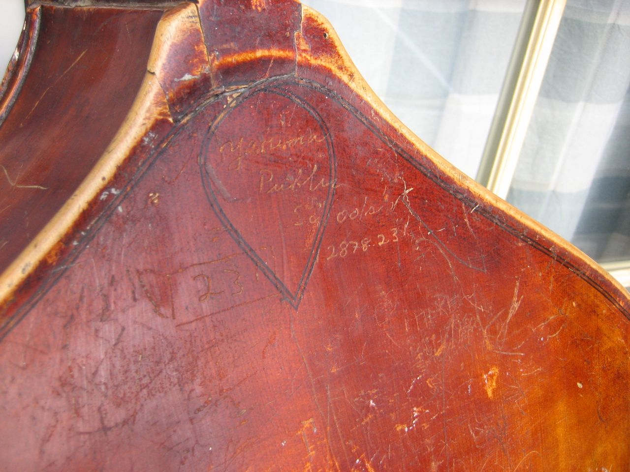

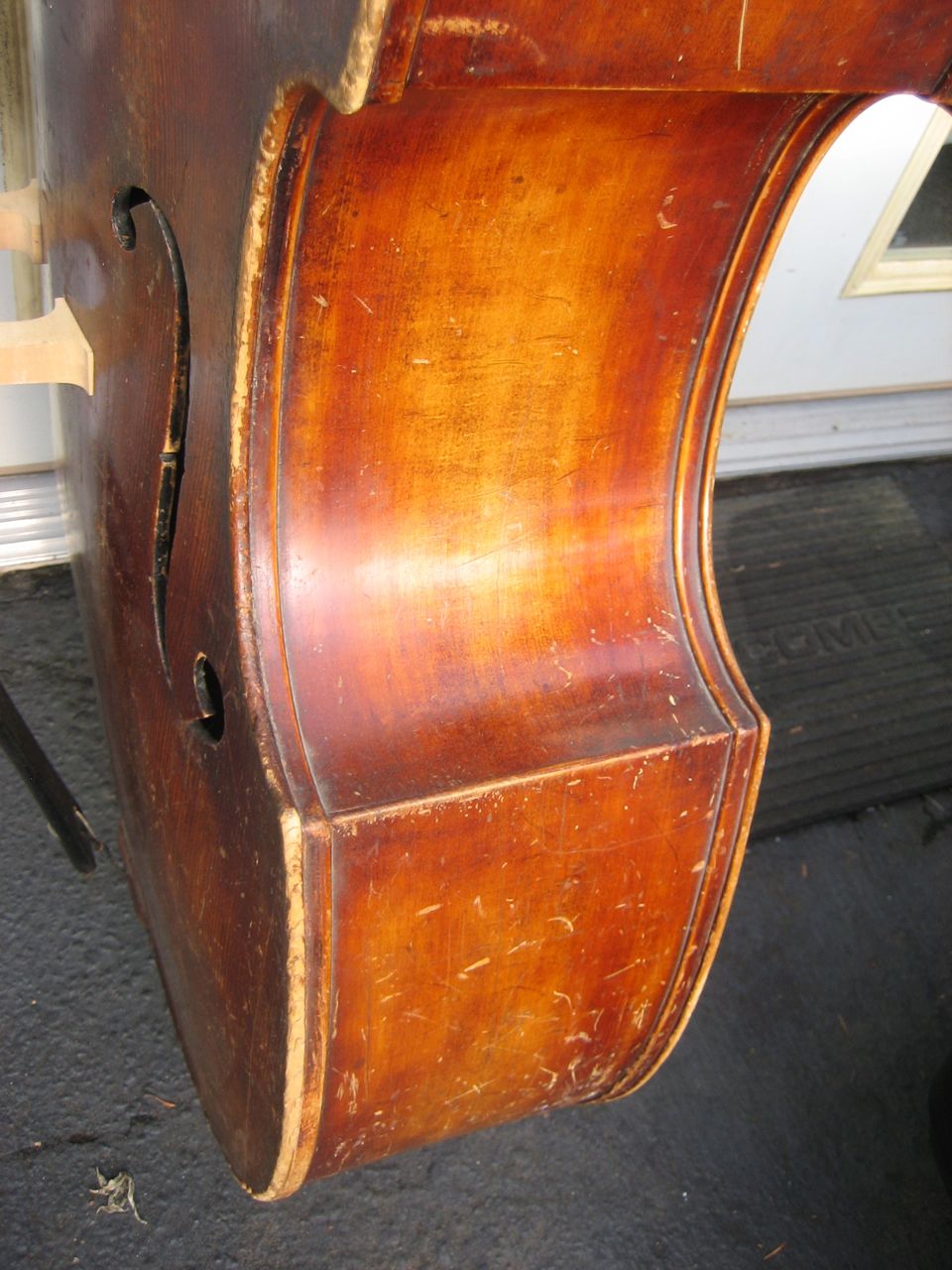

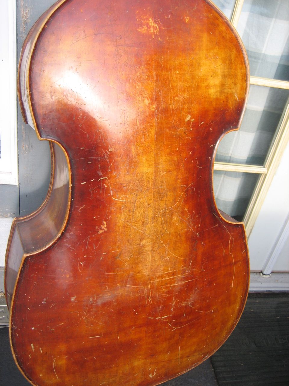

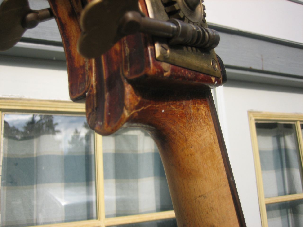

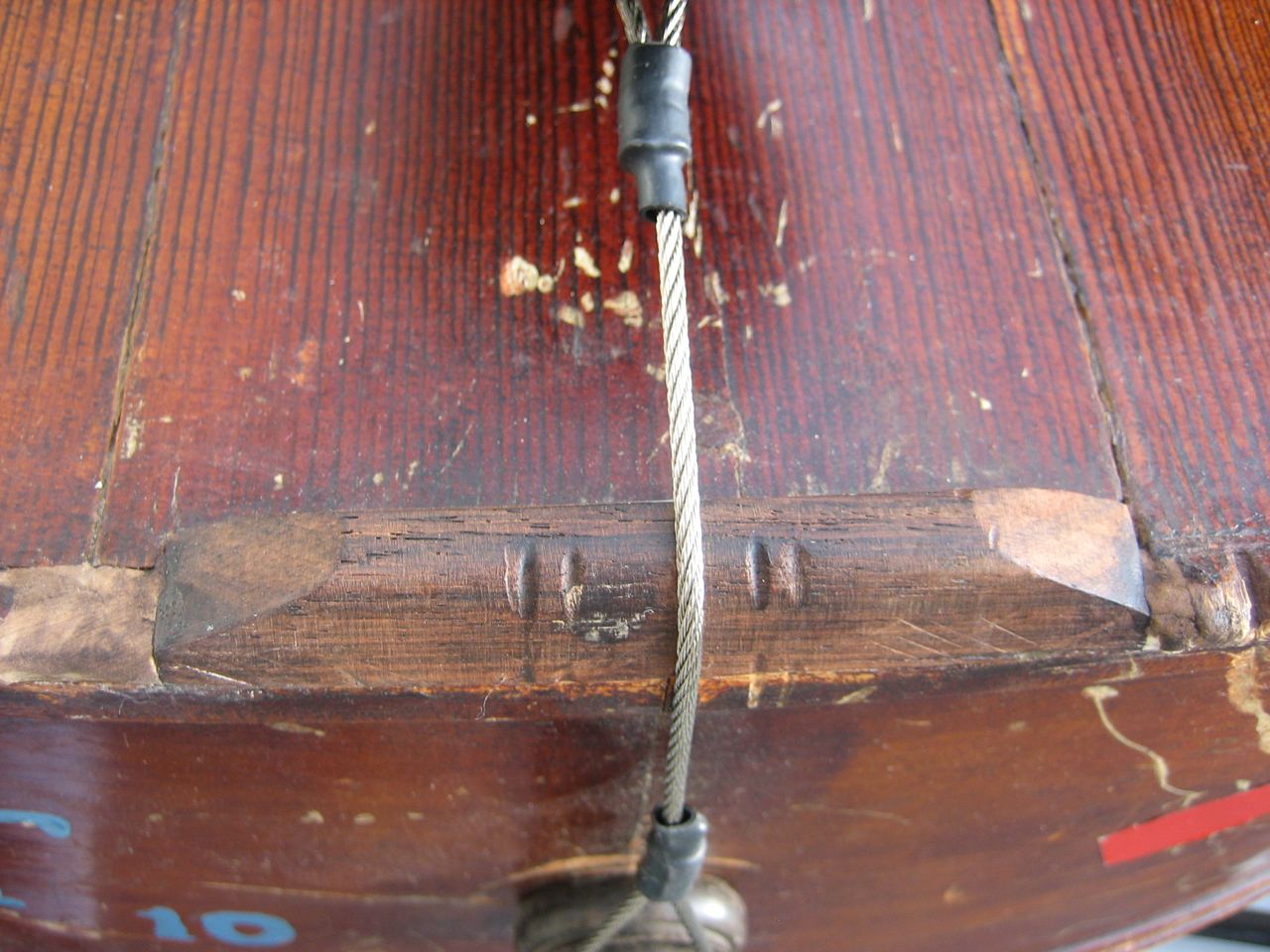

First post here--great forum...
Picked up this bass recently, quite like the neck profile and the sound; now I'm deciding how far to go with it. Bass plays well and sounds good. It used to be a school bass, lots of scratches and some names carved lightly into the wood. That stuff doesn't bother me at all, gives the bass character IMO.
Bass is buzz-free most of the time, but there are cracks, and they do sound sometimes, especially under heavy bow.
No cracks in the back, minor cracks in the sides, top has multiple cracks, including soundpost and bassbar. Looking inside with a mirror we see that most of the cracks have been cleated, skillfully but not masterfully. We also see that the top might need a soundpost patch. Difficult to say for sure...
The scroll is kind of a jigsaw puzzle, but put back together. My local luthier who looked at the bass with me says the scroll makes her a bit nervous, but it looks OK to me...
Question #1: How far would you go with a restoration on this? I'm inclined to take off the top and have it restored & address anything else serious that we might find, but not get too fussy about little details--just make the bass very healthy again
Question #2: Roughly how much in $ would you ballpark a "basic" restoration like I'm describing--top off, soundpost patch, repair cracks...
Question #3: What would you ballpark the bass's value to be in its present state and after a basic resto like I'm describing?
Question #4: Who would you recommend to do a job like this here in the pacific NW?
All comments/advice are most appreciated--thanks!

Nice looking bass.
I am also worried about the scroll, it has been cracked clean off and looks to have been glued back on, maybe epoxy or something. If there are any reinforcements it might be ok for quite a while. Big can of worms to fix.
The neck has broken off from the body in its past and looks like it has been repaired by bolting or doweling it back in place. That is a can of worms to fix but might be ok for a while.
The top is cracked here and there and probably needs some work. I look inside to assess if the cracks are cleated. If not the top needs to come off and I would do a thorough repatching and probably a patch on the soundpost and bar. Big can of worms also.
If you own it and it plays well, I would just keep playing until something really needs to be fixed.
So to sum up, check for un-cleated cracks on top and if there is nothing obvious, keep playing.
Value is not my best subject but a full restoration would be close to my guess of value.
Good luck.

I agree with Ken on this. I waited for at least one reply before answering.
I had one of these basses but was labeled Morelli. Same bass and same importer as well.
Look for this IF the Top comes off;
The Top and Back will be ULTRA thick in its graduations. Re-graduating will improve its tone. The Bass bar will most likely be integral if original as these were factory machined carved.
Repair whats broken correctly. Do not add to the bad repairs with more bad repairs. Have the varnish touched up to look as close to original and then leave it alone.
The neck overstand is way shallow and possibly in its original position. This will need to be done as well. Remove the neck, fix scroll and maybe if ok, keep and re-shape fingerboard if necessary. Or, new Fb and Bridge. If string length is long and an Eb neck, graft a new neck, D-heel. Set original neck lower in the Block as well if not grafted to help with the string length. Give us all the measurements of the bass as listed on my website. Ribs are measured without the top and back, always.
mine; http://www.kensmithbasses.com/double...orelliBass.htm
and b4; http://www.kensmithbasses.com/double...relliBass2.htm
By the way, that bass is an import made for the US market. There is no such person that ever made basses or violins by that name. It was made up for the import company just like Morelli was.
These are good basses once fixed. Some sound good even broken or poorly repaired. The difference? Repaired correctly they might and usually play better. Repaired correctly they also have a much better resale value.
Value now as-is? 1-3k.. Restored my style; 10k+.. Cost to repair everything? Here with my guys doing the work? 5-12k.. Depending what we see on the initial inspection and then modified after the bass is taken apart.
Results after the work is done my way? It would be a desirable 'cream puff' bass to play or own. The Morelli we did was fit for the best Orchestra after completed but a fine jazz player snatched it up. It was a 'honey' of a bass.
