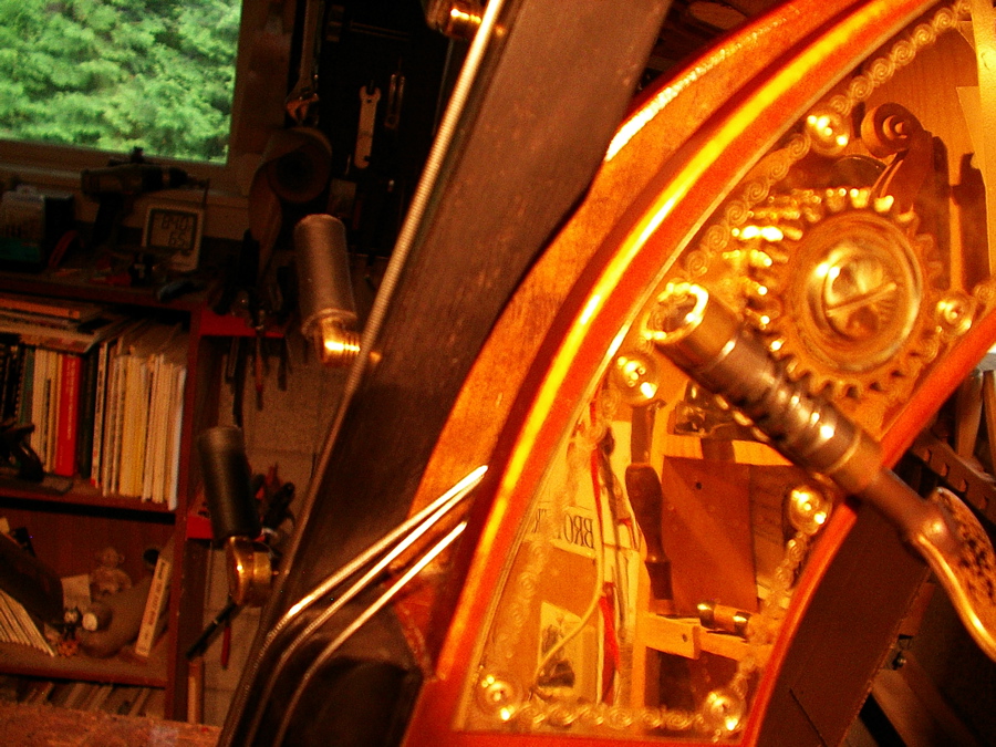

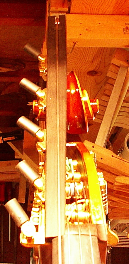

This is a B extension that I fabricated on a Christopher bass. The player was most insistent on the B, and I went against the advice of some esteemed luthiers to make it.
I know the arguments against the B, but according to this player, who is a university student, he won't even be allowed to audition for some orchestras without a B extension. I could not turn him down .
As it turned out, the functionality of this extension is very easy and the Bass Capos from Rob Anzellotti are very well made.
Thinking back I was wondering how many tools I used to fabricate this extension which is solid ebony. I came up with between 60 and 70! This includes files, planes, knives, computer for calculations, drills, drill press, measuring tools, etc...
The design is deliberately austere, without fuss, with a tip of the hat to Arnold and Jeff B.

Well done Ken, that looks simple and neatly executed.
I'd hate to lug that bass around though ... he almost needs a bull-bar to protect the top!

One critique Ken (McKay). Since the E-side of the Fingerboard is beveled, it would have been nice to see the extension flush with that bevel and not have a little height difference in between. When fingering between E and E-flat in a rapid passage, you can easily cut your hand.
Overall, nice work.

Thanks Calvin, that is good advice.
The extension is beveled, just not quite as much as the Rhomberg. I did not notice any sharp edges but you point is well taken.

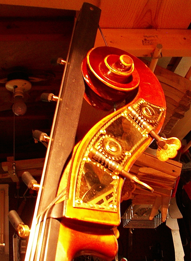

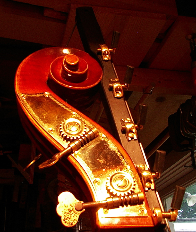

We finally took new pics of the Big Gamba and updated the webpage so here's some shots of the new Bollbach Chromatic Ext..

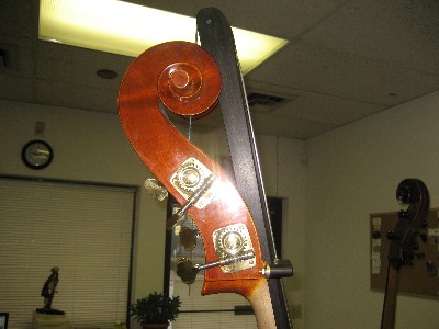

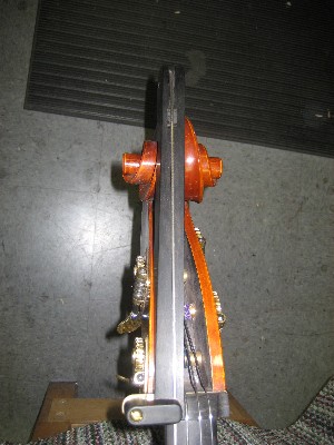

Hi. I'd like to throw my hat in the ring here. I've worked on other people's extensions but never made my own from scratch. Some people have been inquiring so I figured it was time. It's solid ebony, fitted to a new Romanian bass. It's screwed down to the neck under the nut but not the scroll or cheeks.
It functions well. I would have done a couple things differently but next time I'll avoid those mistakes. Next time I'd like to make a two pulley extension that avoids the hole through the scroll (if the dimensions of the bass permits)
It's installed on a bass for sale so I think I'll wait to add capos or a fingering rail until the customer knows what he wants.
Hopefully the pictures work.
Any thoughts?
